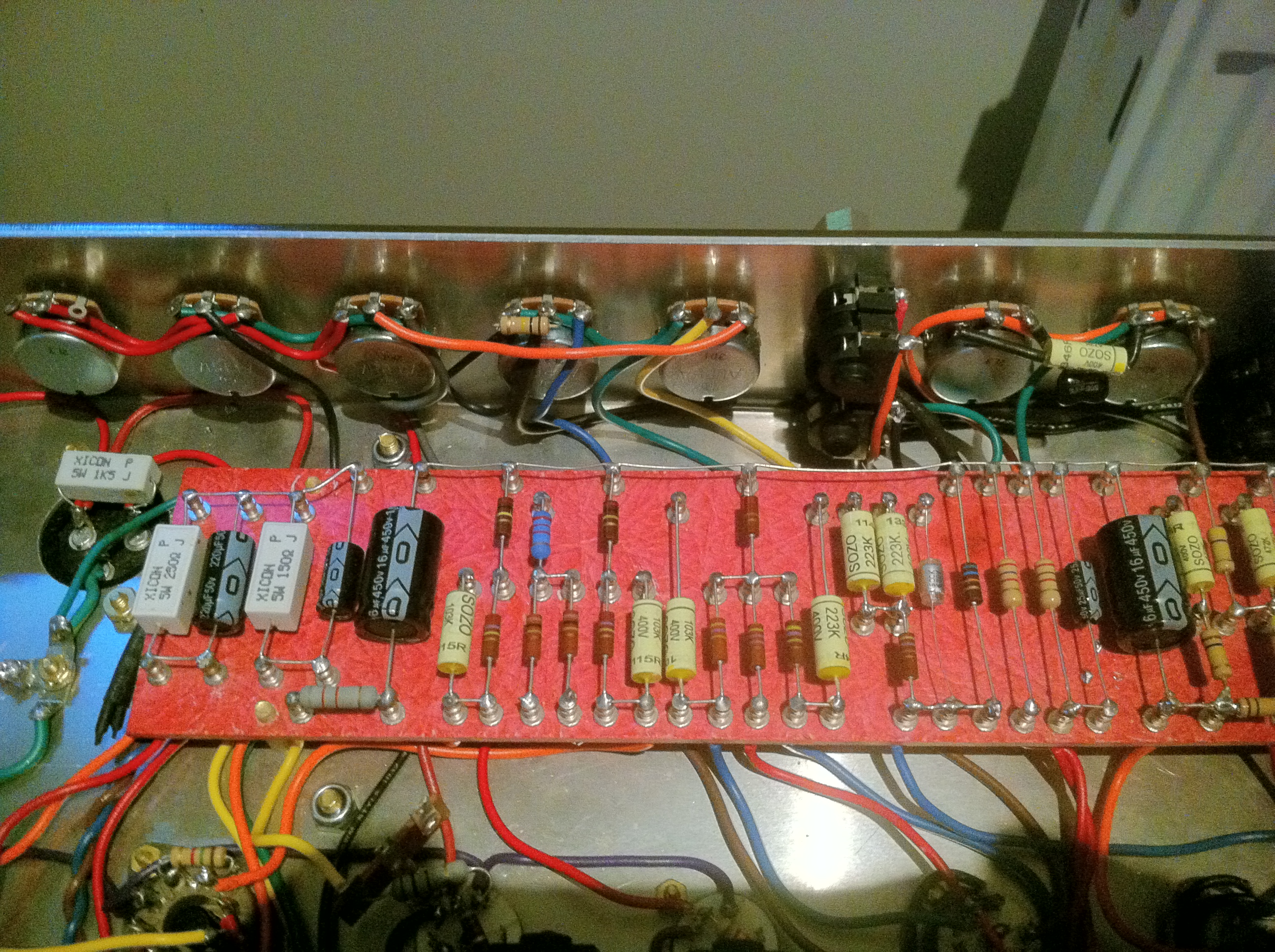

Ok I have triple checked the wiring, jumpers and grounding connections all checks out per layout I'm still not getting any voltages on V1 pin 8 and V2 pin 8 there doesn't seem to be much happening down that lower side of the board voltage wise , may be i have blown some resistors and caps.
When using the the multimeter probe on V3 I was getting very loud sound from the speaker similar to plugging a guitar in when the amp is turned on, my diagnostic ability's are nearly at an end i might have to pull the board out and start again.
I'm really looking forward to hearing this amp running I have redone the voltage chart some of the voltage have gone down while V1 pin 6 is extremely high . I have attached a few pics I'll try and take some better ones, some of the wire i used is not correctly colour codes as that was all had at the time . Thanks again for any help .

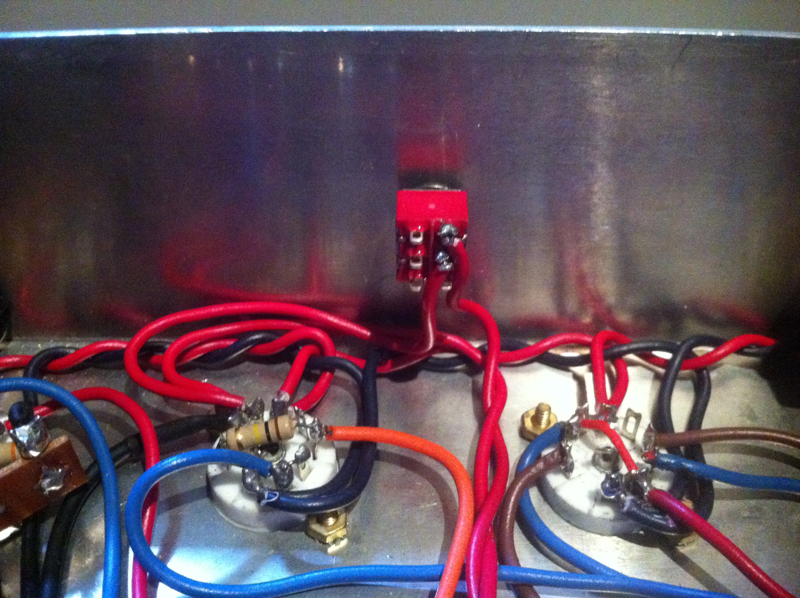

PostPosted: Tue Feb 09, 2016 4:21 pm
Get a pic of the tubes and the boost switch

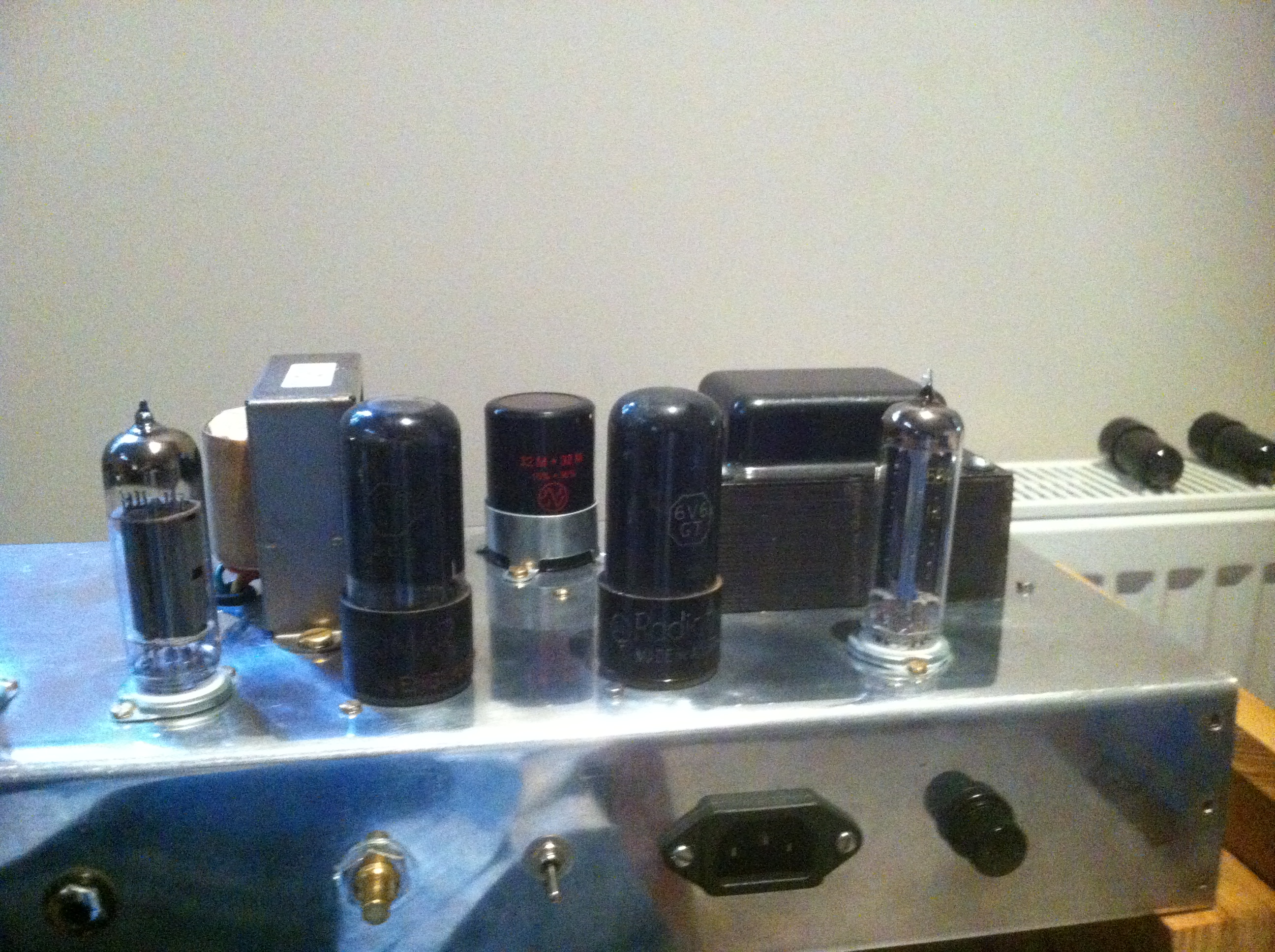

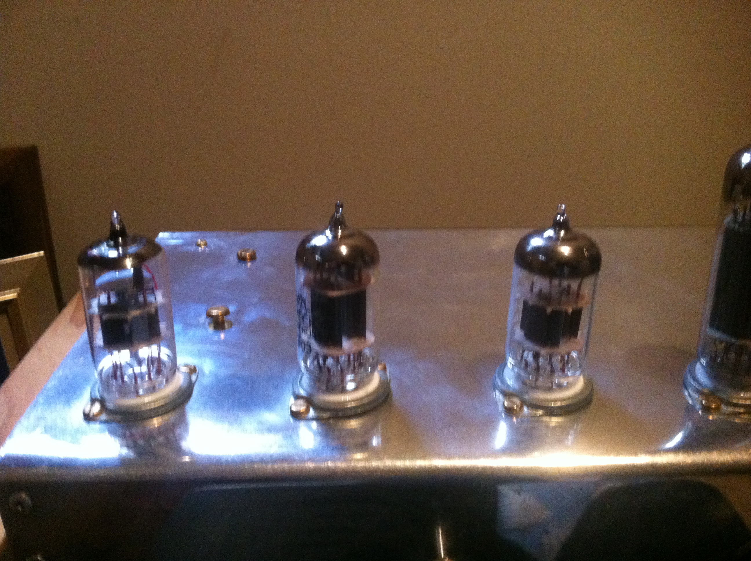

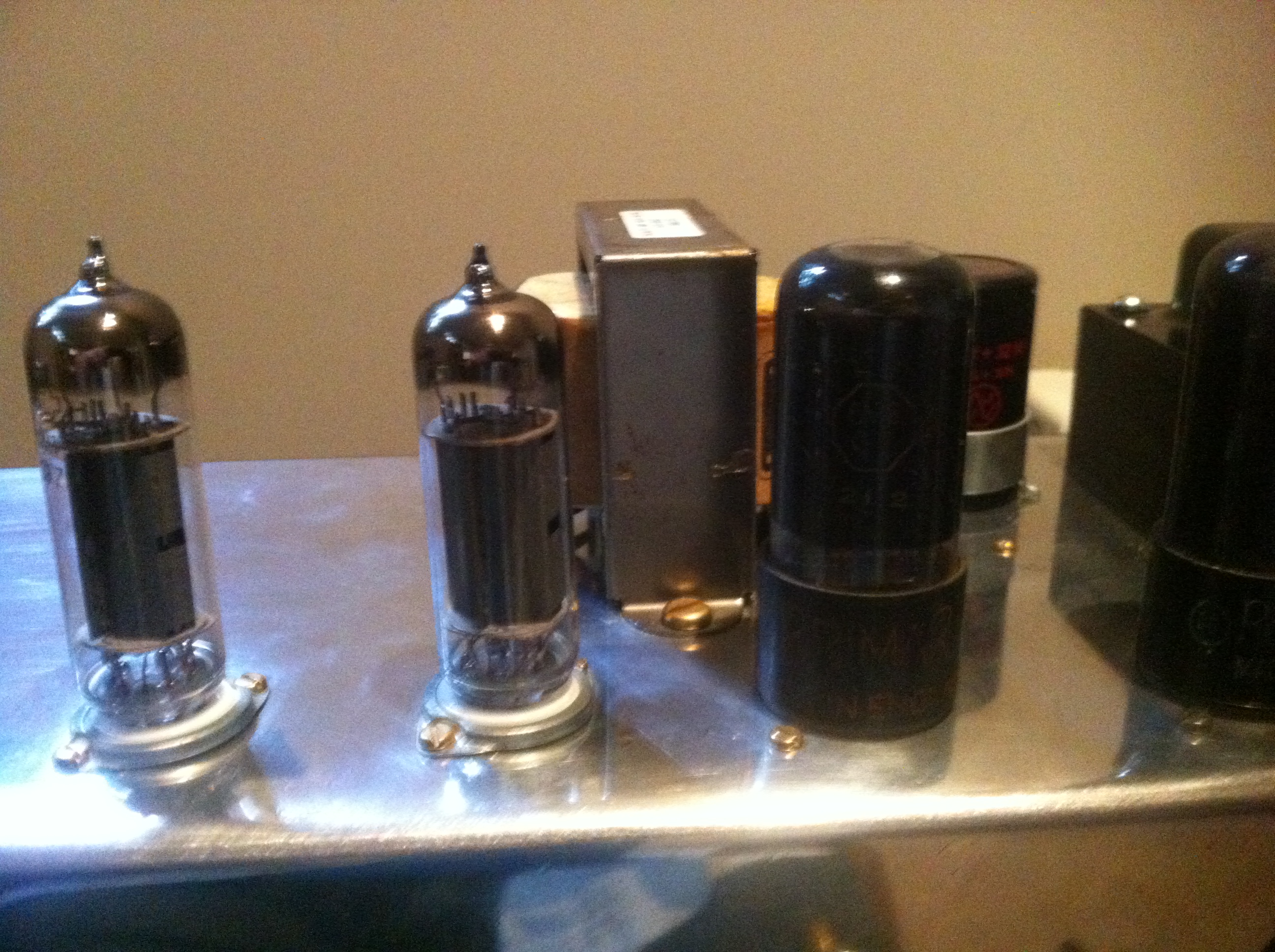

When i received the board i noticed it was different to the layout, the 100k resistor was soldered to the 16uf 450V cap with no jumper wire coming off the 100k going to the .022 sozo cap I have since moved it per layout the included pic i found on the forum should explain it more clearly .
Another thing i noticed was when probing the input jacks there was deadly silence .
I wasn't quite sure if you wanted close ups of the tubes kurtlives hope the pics are ok .

PostPosted: Tue Feb 09, 2016 7:16 pm
Sorry, I should have been more clear :snooze:
Take a picture of the tube socket and the wiring around it

Good news the amp is going, I replaced the 12ax7's with another set, I found a blob of solder hidden between a couple of the valve socket pins looks like i have destroyed set of brand new valves while swapping them around from socket to socket .
