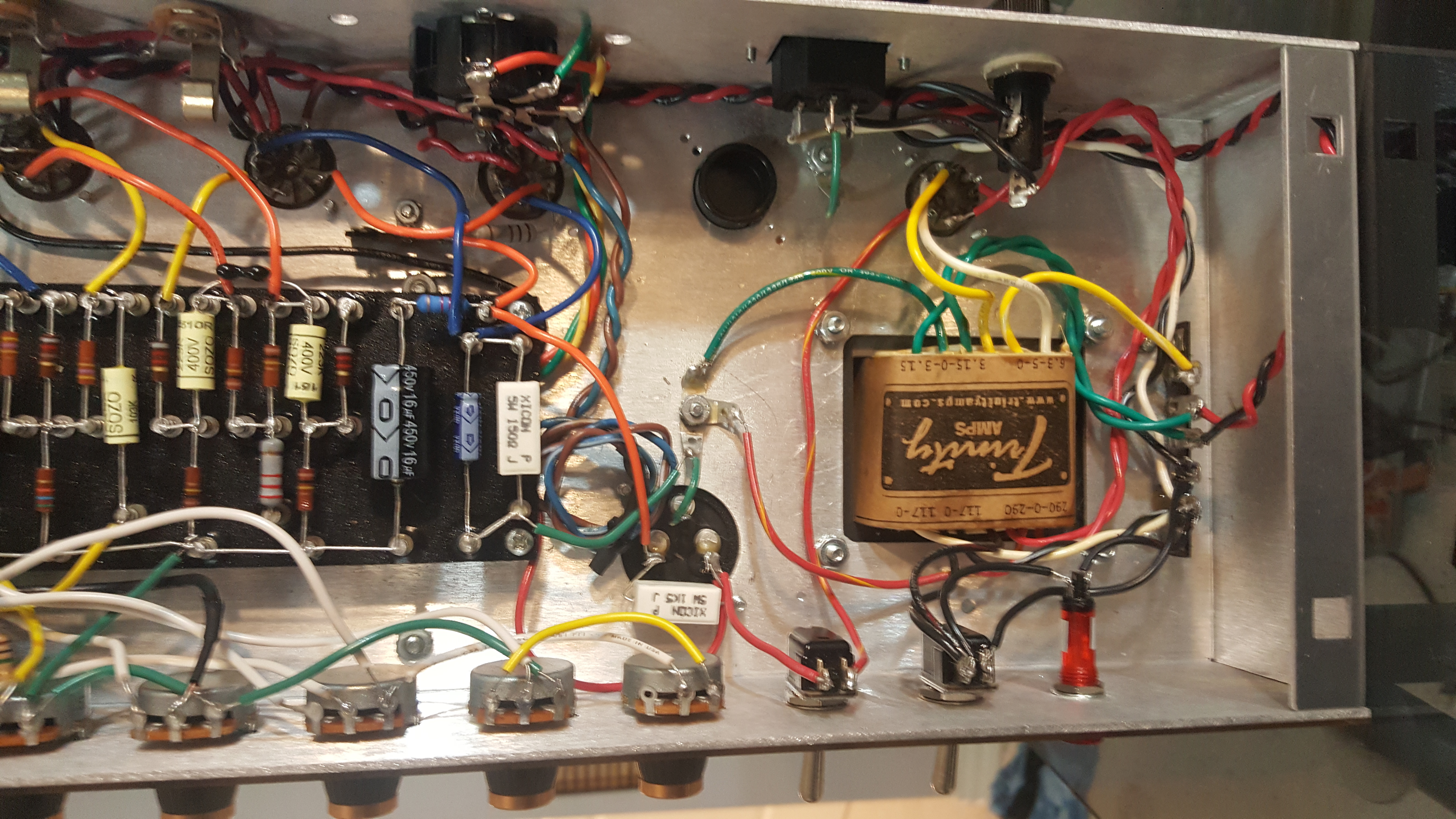

Might want to post a picture of the build

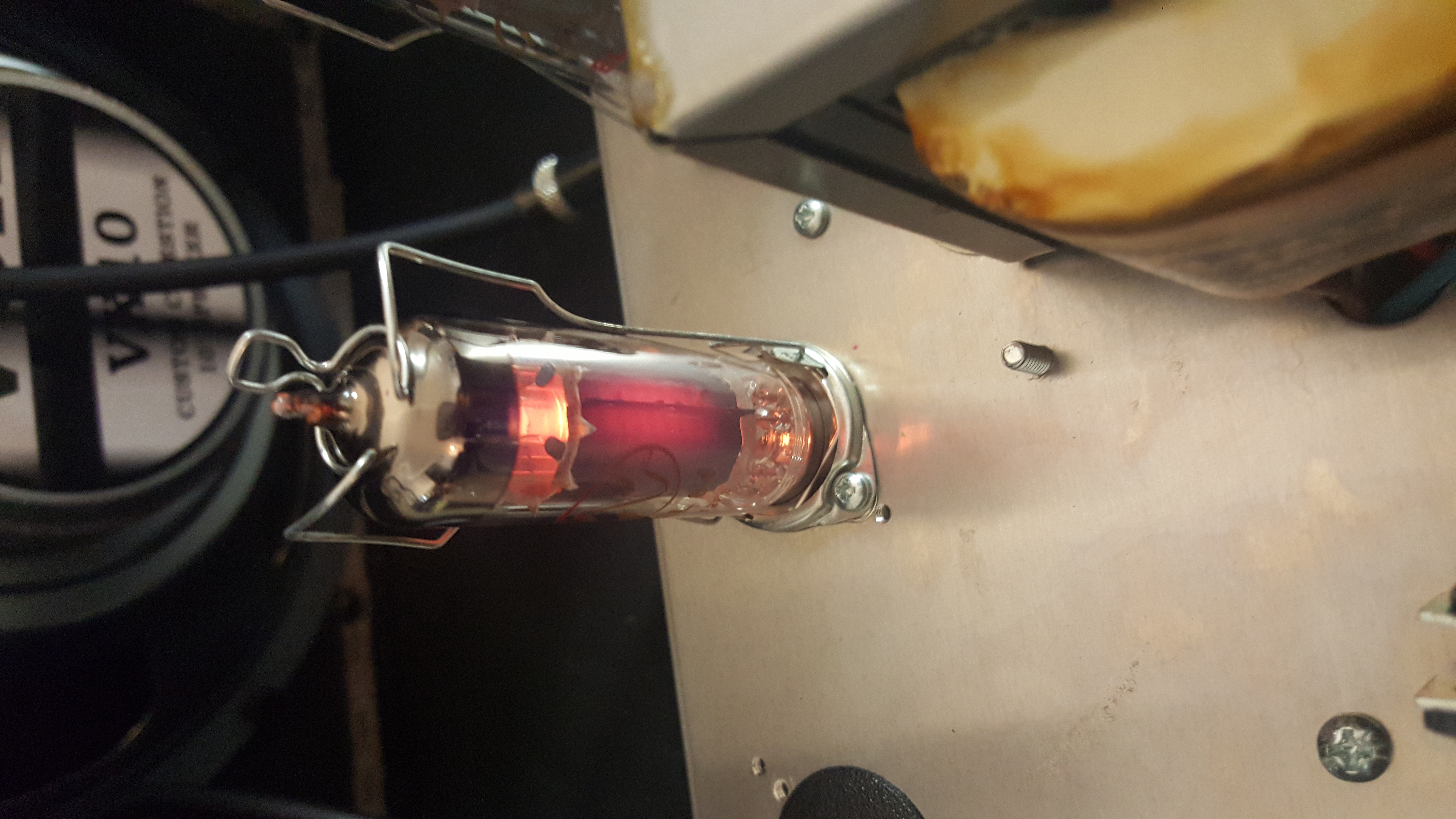

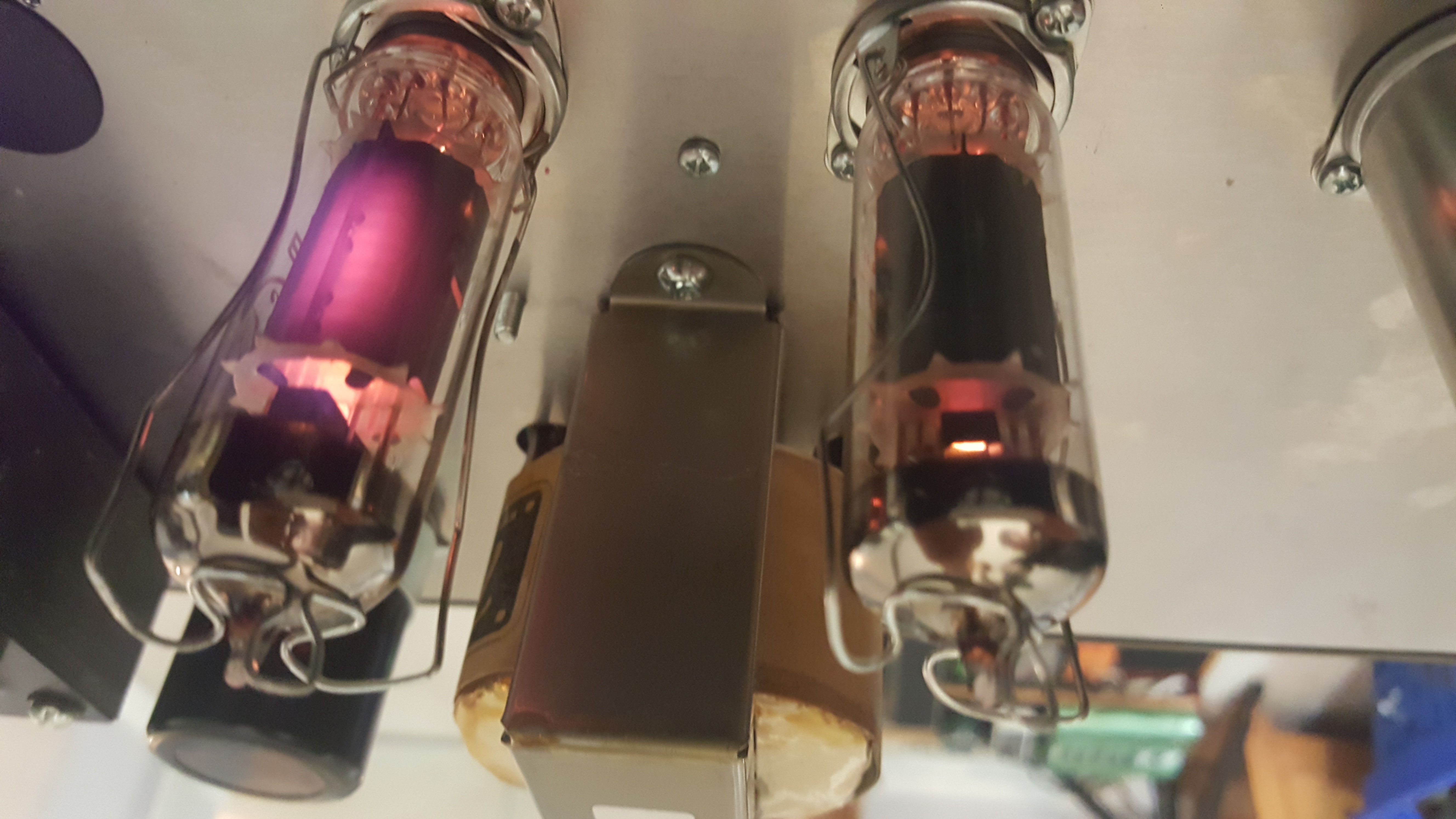

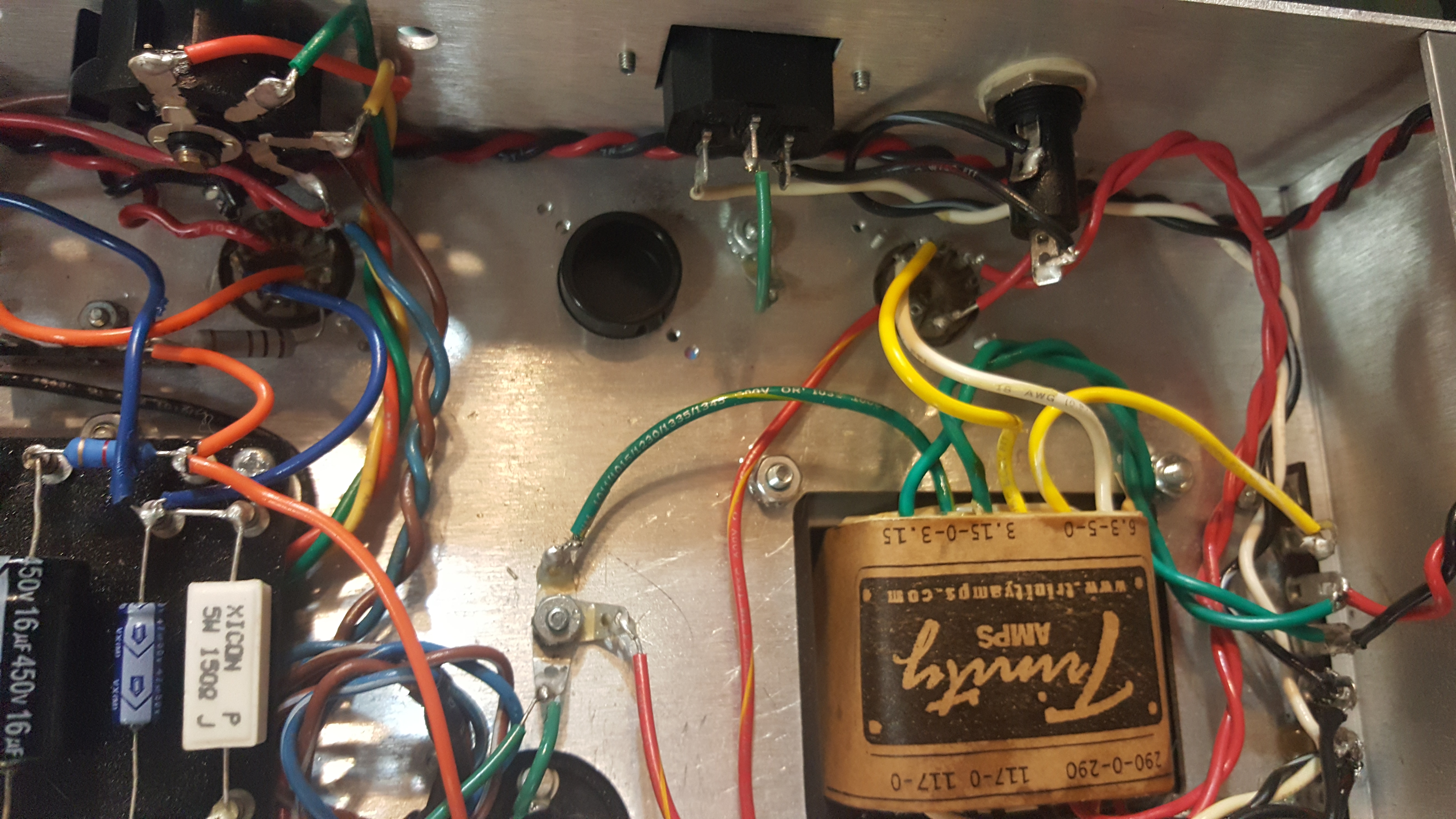

Cant get a good look until i get home but i can see that you do not have a wire going to the grid of what i am presuming is the glowing tube . (pin 2) . the output of the phase inverter has a yellow wire to one el84. and the output of the other side of the P.I has no wire going to the other el84. and i hope that that tubes survives that amount of red plating

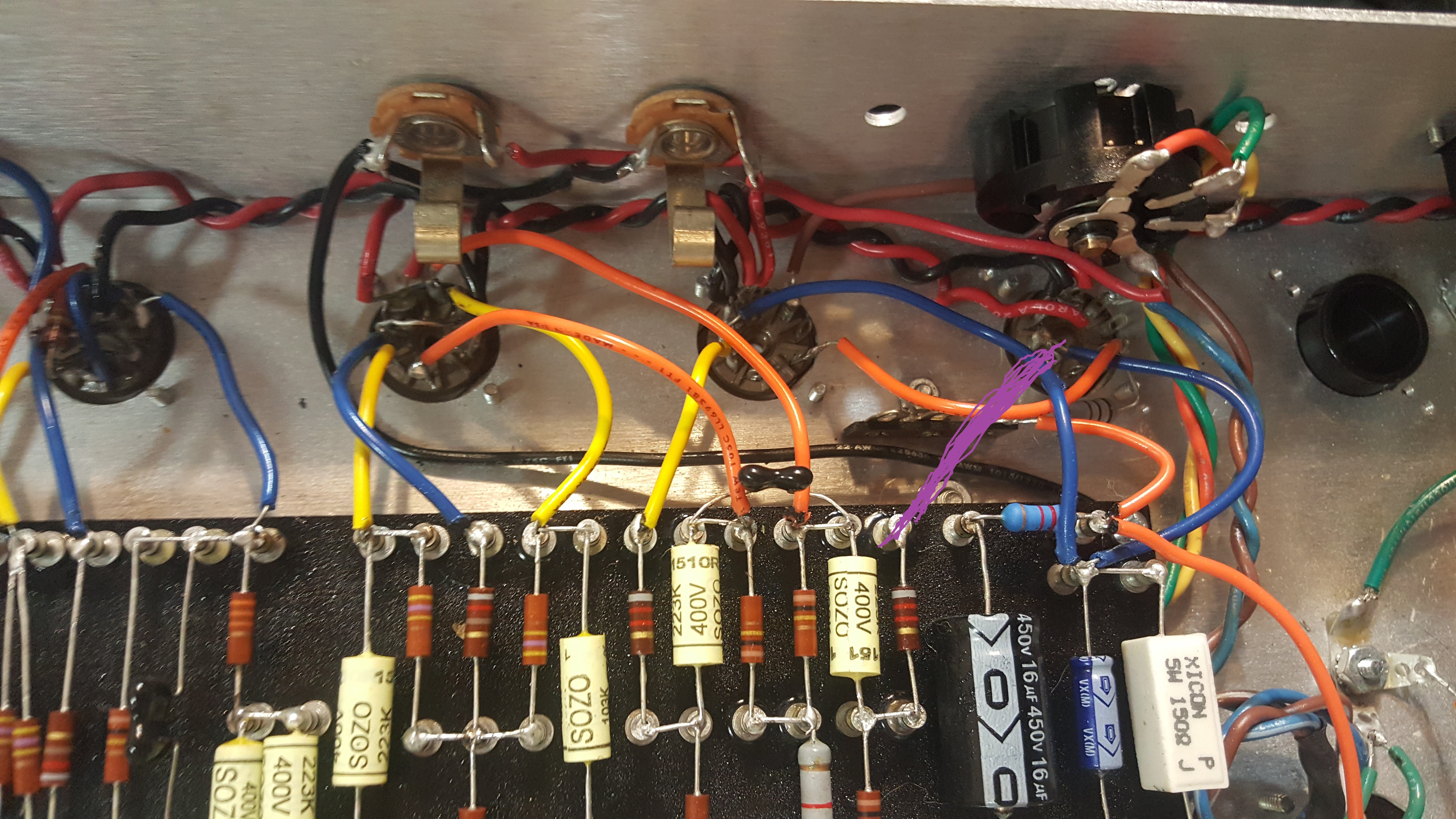

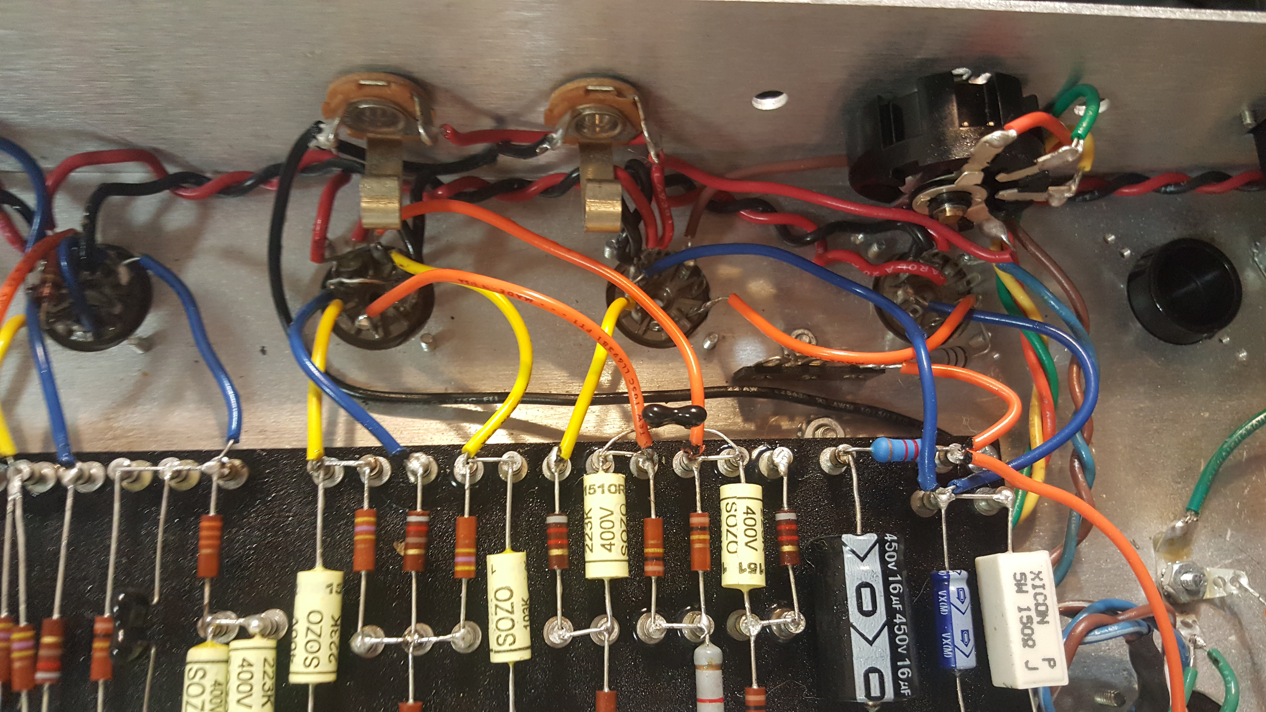

the purple scribble is the one your missing

First, I added in the wire from the turret board to pin 2 of V 5. I then proceeded to to a sound check and it appears that not much had changed. With help from a friend who has far more experience working on tube amps we checked the wiring of the amp and made sure that the component values were correct. All of the resisters and capacitors checked out. We also switched around the tubes to see if that could have been the problem. This didn't change anything. The V 5 tube was still glowing far hotter and the amp sounded very crackly and didn't make sound as low decibels.
Our final idea was that the output transformer may have been fried and making no resistance through the output tubes. This wasn't the case as we go 8k resistance through the output transformer.
After that we ran out of ideas and time. What we concluded was that something isn't prohibiting the voltage to the V 5 tube, but everything we measured checked out (Except of course the voltages).
This project is stumping me right now and I would greatly appreciate any feedback, suggestions or potential fixes.

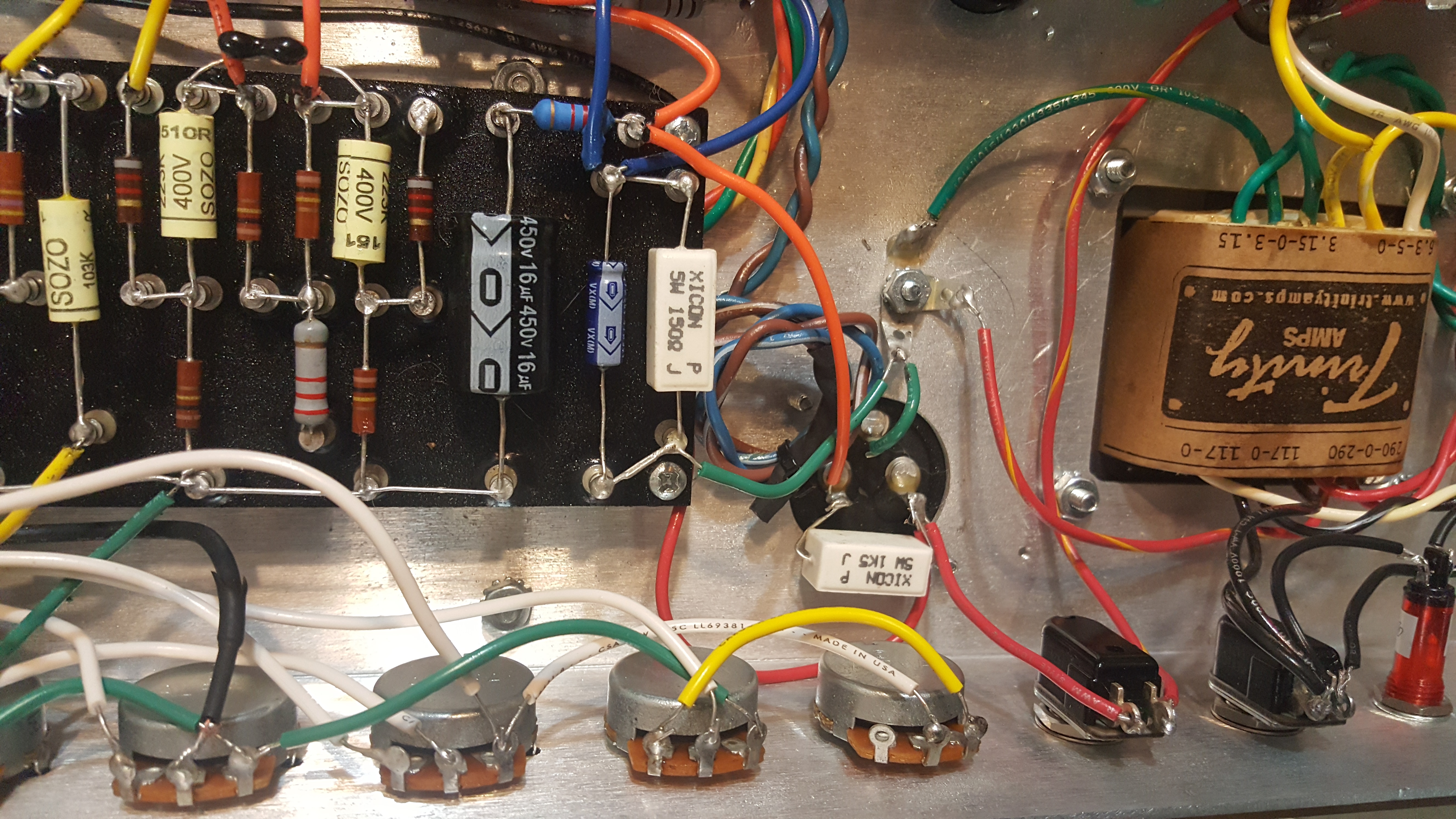

One question the 100 ohm resistor that is from the screen supply attaches at pin 9 of v5 wit a jumper to pin 9 of v4. Is that resistor touching the screw that holds the tube socket of v5 ?

What i meant was the screw on the tube socket it just looked in the picture that it was just touching the screw
