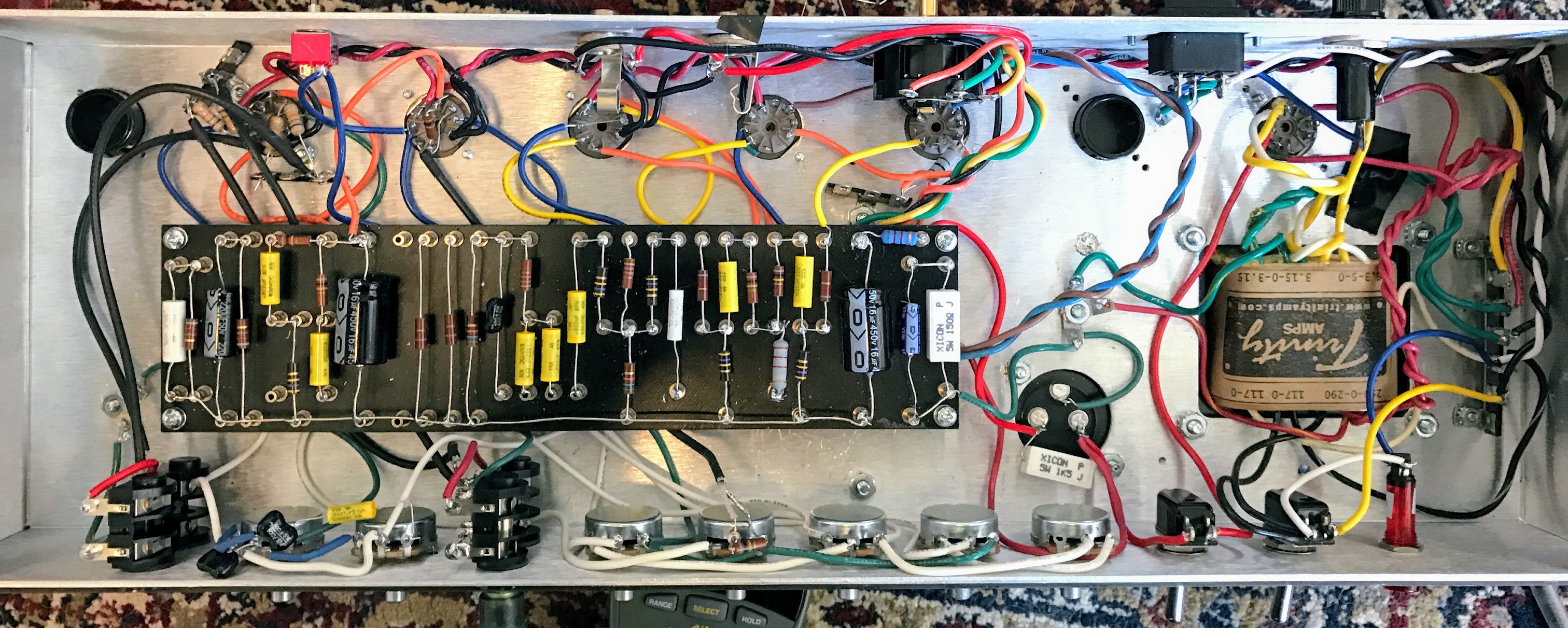

Hello, this is my first amp build. I clearly have done something wrong, but I'm not sure what it is.
I put together the Plexi and hooked it up to a speaker output. I got a staticky ticking sound when it was turned on, but no guitar sound.
I'm now checking voltages and with only the rectifier tube in, the preamp and power amp plate voltages are all around 430V DC. On the rectifier tube, here are my voltages:
Pin 1=318V AC
Pin 3=442v DC (I think)
Pin 7=318v AC
I'd appreciate any suggestions you might have for what to look for.

Thanks @stetterhawk. I am uploading some pics now. I thought the voltages might do it because the preamp tube plate voltages are a lot higher than what was listed in the directions ( ~150-250V).
The photos are coming. Is there any other info I can provide?

Overview Photo Below
PostPosted: Sun Apr 09, 2017 12:05 am
Voltages will read high with no tubes in place. With no loads all the voltage dropping resistors won't do much. Your readings at the rectifier socket look OK.
Recheck your wiring. Make sure all the parts are in the right place. Check all your solder connections. They look good in the photos, but check that they are all solid. Make sure nothing is shorted, especially the shielded cable.
Put the tubes back in and read the voltage at all the pins. Post these readings. It will help us narrow down the problem.
Good luck with the amp.
