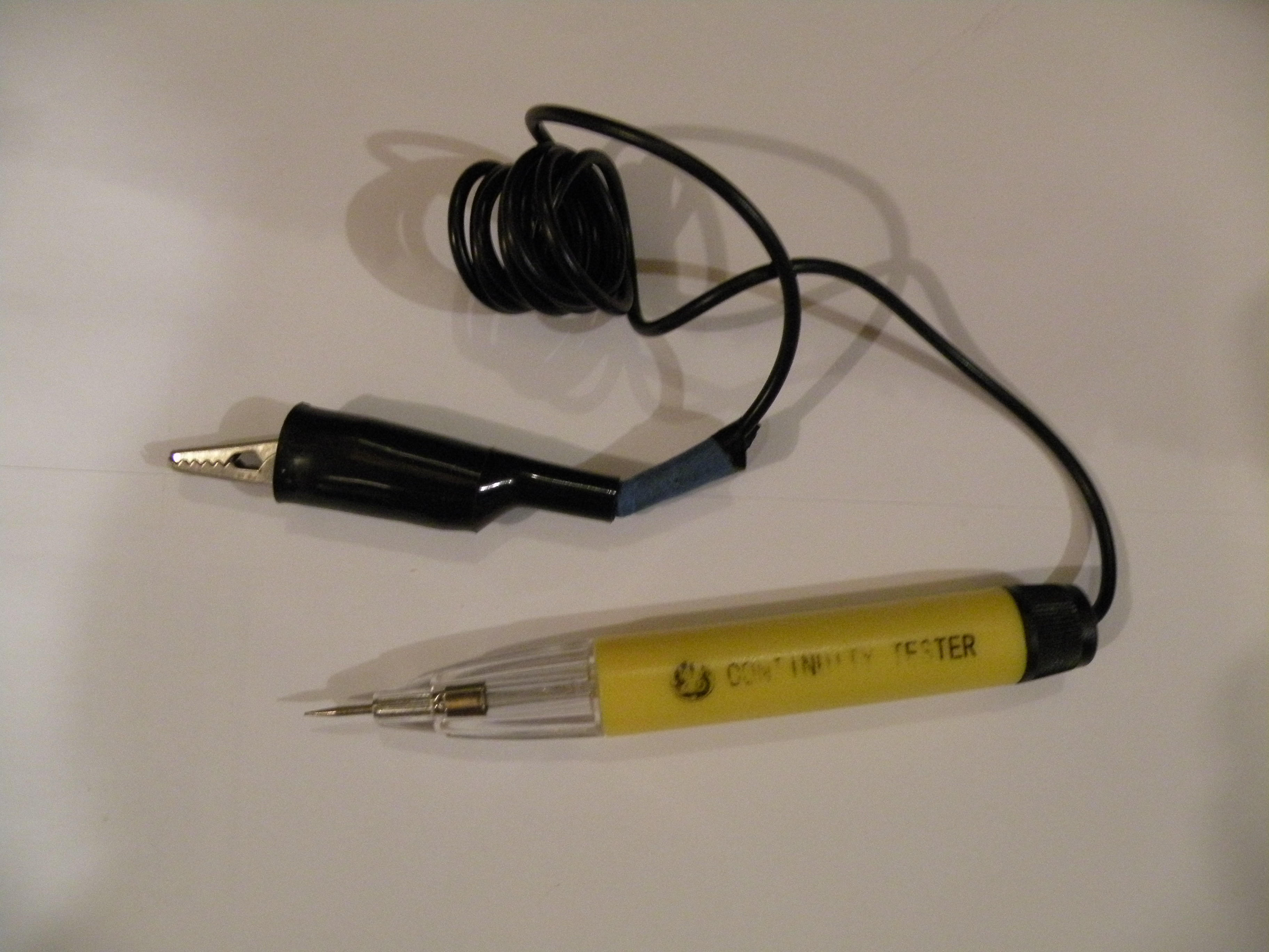

Question about continuity between heater wiring after installation of Power Transformer.
I just installed the long twisted red and black heater wires to all of the preamp tubes and power tubes. At each tube, I checked for continuity between the red and black wires at each tube, and confirmed that there was NO continuity, (no short) between the red and black wires; again I check at each tube as the heater wires were connected. There was no short, no continuity, which is good.
Next, I then installed the Power Transformer and connected its two GREEN wires (2x 3.15v =6.3v ) to the red and black heater wires (at the the larger terminal strip); I then double-checked for any continuity back between red and black wires again at each tube; however, now it shows some continuity. Further, when I hooked up the Power Transformer's ground wires (green-white and red-yellow) to the power ground star, I found that the red and black heater wires now also show continuity with the ground. FYI—I used a continuity tester/probe which lights up when there is continuity (see attached picture).
I suspect that what I now see as continuity is showing up because the Power Transformer is now in the circuit and this is normal. Is this CORRECT?
I do not want to proceed with the next step to “Test the Power Supply” (as the Manual instructs) until I hear back from one of you experts here that this continuity is showing because the PT is now in the circuit and this is normal. I don't want to fry the PT if this is not normal.
So, can one of you experienced gurus confirm that what I see is normal?

PostPosted: Tue Aug 01, 2017 11:11 pm
Yes, this is normal. You are just reading the power transformer with your continuity tester.
A transformer winding has a really low DC resistance, especially if it's a low voltage one. If you used an ohm meter you would see that it's really about .4 ohms or so, not a short. And it would be half of that from one end of the winding to ground, since the winding's center tap is connected to ground.
Go ahead and do the voltage checks. You should see about 6.3 volts AC across the heater pins at each tube socket and about 3.15 volts AC from each heater pin to ground. The readings will be a bit higher with no tubes providing a load. It depends on the line voltage coming in, too.
You can also test the high voltage, but be very careful!

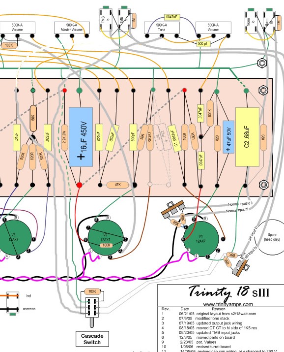

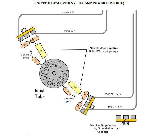

VRM Coupling and Cascade Mod option?
I am about to wire the V1 section; I will be adding the two extra VRM DC Coupling capacitors to pin 2 and pin 7, and will move the 1 meg resistors off the high inputs and put them at V1 as directed by the VRM manual [see first attached diagram below]. However, I am also adding the Cascade Mod (cascading the TMB channel into the Normal Channel); see the second attached diagram below for the Cascade Mod [but I will change it so that the TMB goes into the Normal channel].
Before I install the VRM 1 Meg "Grid Load" resistor from V1 pin 7 onto the ground tag onto the Normal Channel's the terminal strip, I want to confirm that the VRM's 1 Meg Grid Load resistor is still needed given the Cascade mod (TMB into Normal Channel). I suspect that it is still needed, but I wanted to check with you guys to make sure that having that 1 Meg resistor going to ground and having that Cascade mod will not cause a problem.
So are the VRM 1 Meg Grid Load Resistors going from pin 2 and pin 7 to ground both still used with the Cascade Mod?
Thanks again for all the very helpful advice.
C2

PostPosted: Wed Aug 30, 2017 6:44 pm
Yes, the 1M grid resistor is still required.

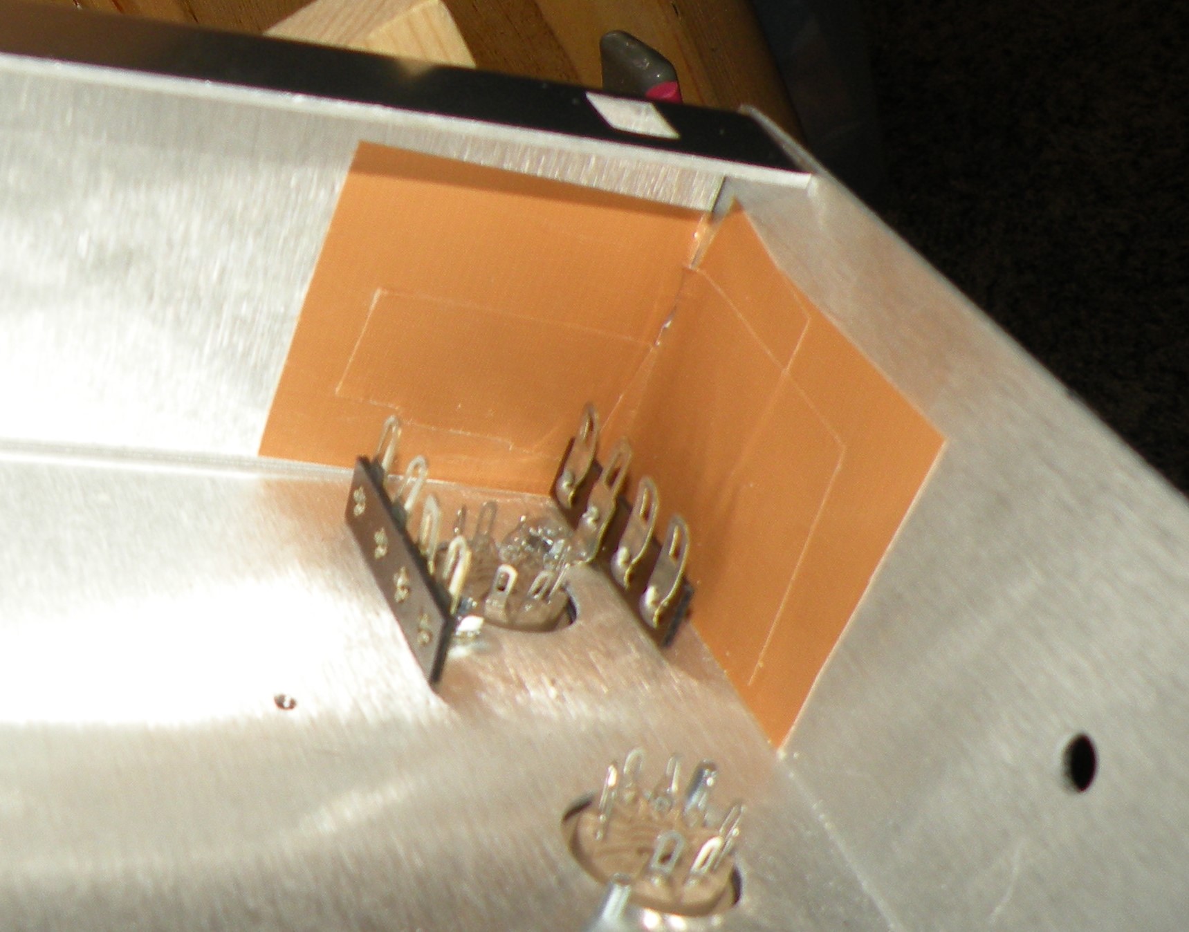

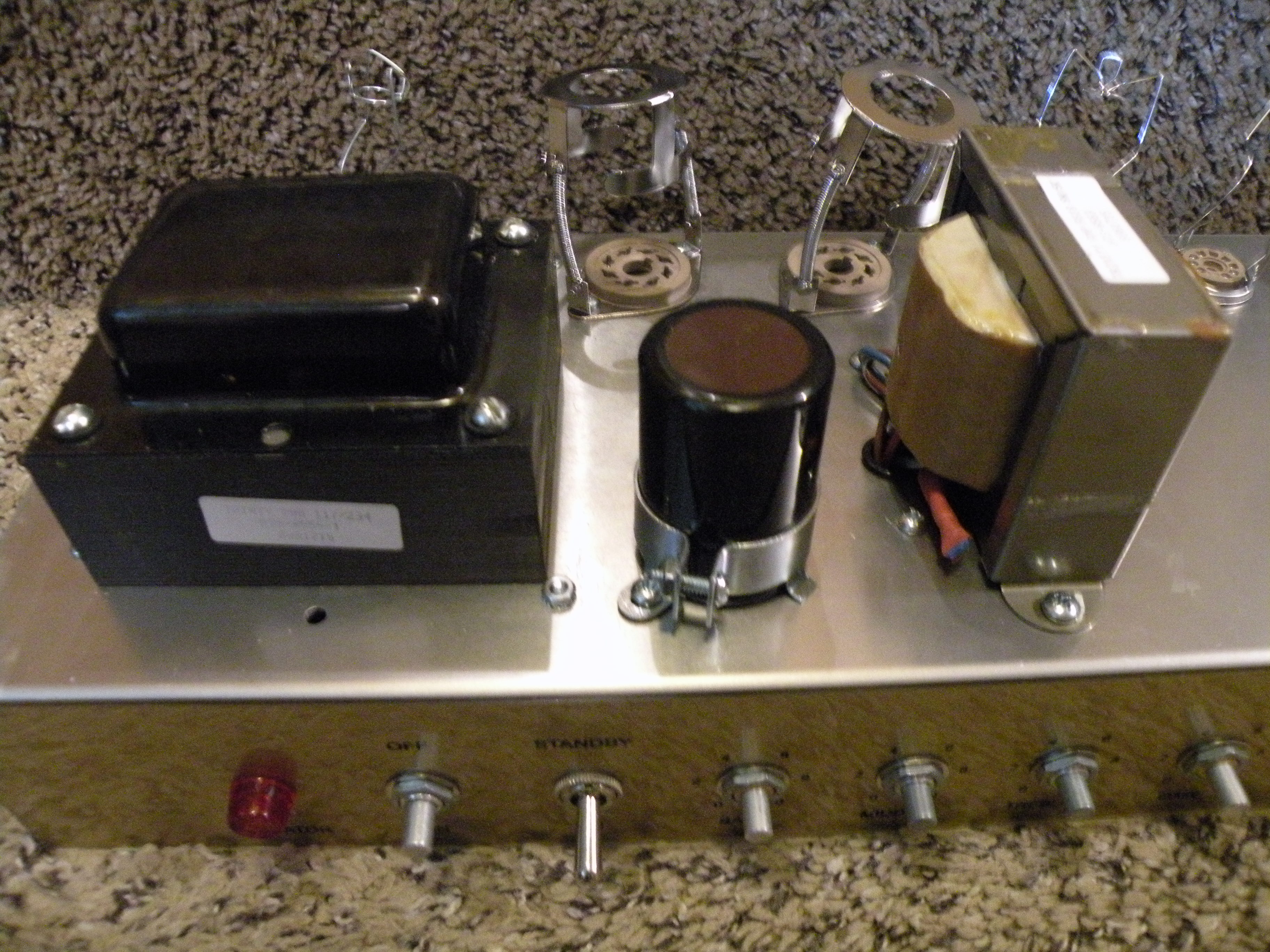

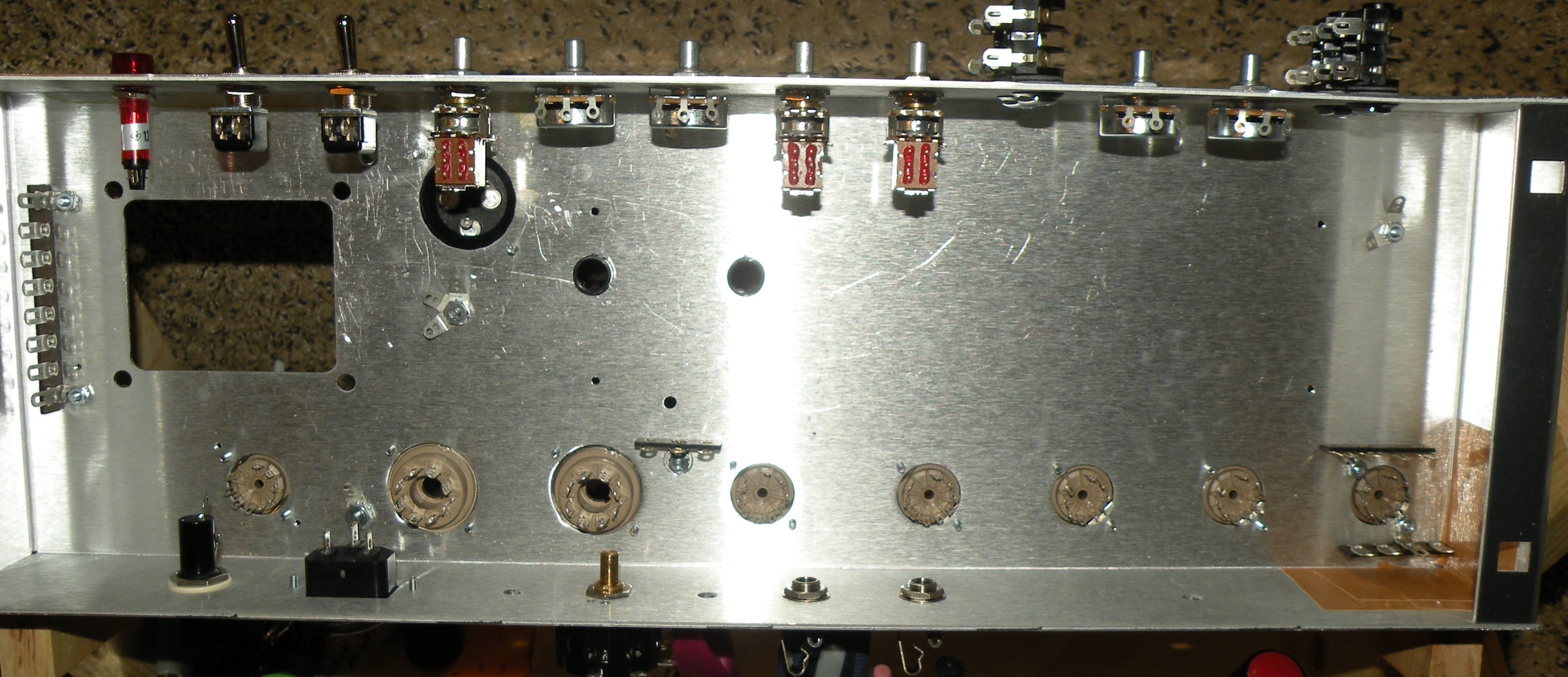

I wanted to post some pictures of my gradual progress. I should have posted these earlier, but I am just now getting to posting the pictures.
The first picture is of the hardware installed on the chassis. I made a few changes/upgrades. First I added an 8-tag terminal strip. The reason for this is that I wanted to have two extra tags available down the line for when I add footswitch relays (which will require an extra capacitor to go on these extra tags). Next, I also changed the 3-tag terminals around V1 to 4-tag terminals (these are for extra convenience when I eventually wire the two VRM DC Coupling Capacitors, which I will install on the fourth tags). The Third, Fourth and Fifth changes are the push-pull 500k potentiomenters for the Bass, Gain and Volume pots on the TMB channel. I will use the Bass push/pull pot for the cathode switch; I will use the Gain push/pull pot for the gain Boost switch; and finally, I will use the Volume push/pull pot for the Cascade Mod (cascading the TMB into the Normal Channel). These three push/pull switches will be more convenient for me to have on the front panel.
File comment: Hardware, 8-tag terminal, 4-tag terminals, three push/pull pots

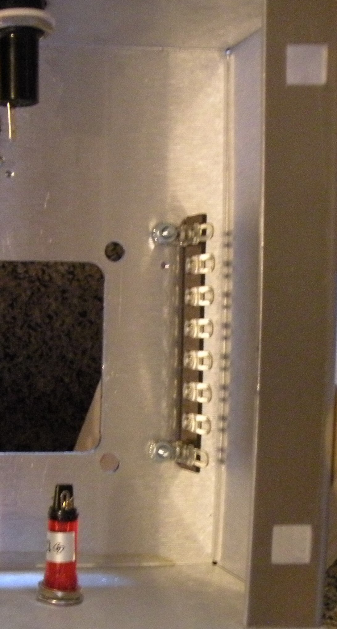

The second picture is of the 8 tag terminal strip (which gives six non-grounded tags)
File comment: 8-tag terminal
The third picture is of the two 4-tag terminal strips around V1. I also put some tape in the V1 corner as some insolation protection.
File comment: two 4-tag terminals for V1 DC VRM coupling caps

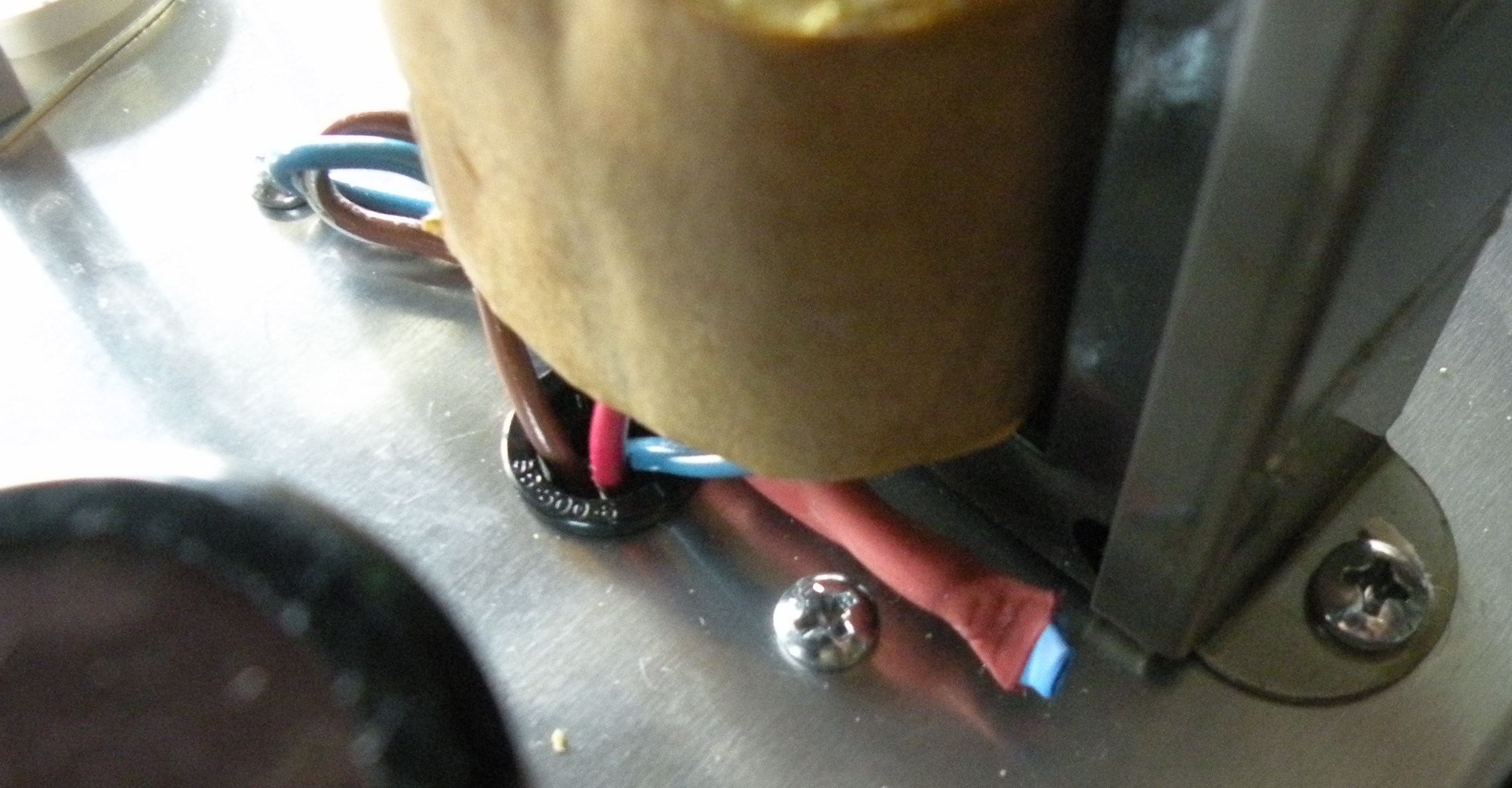

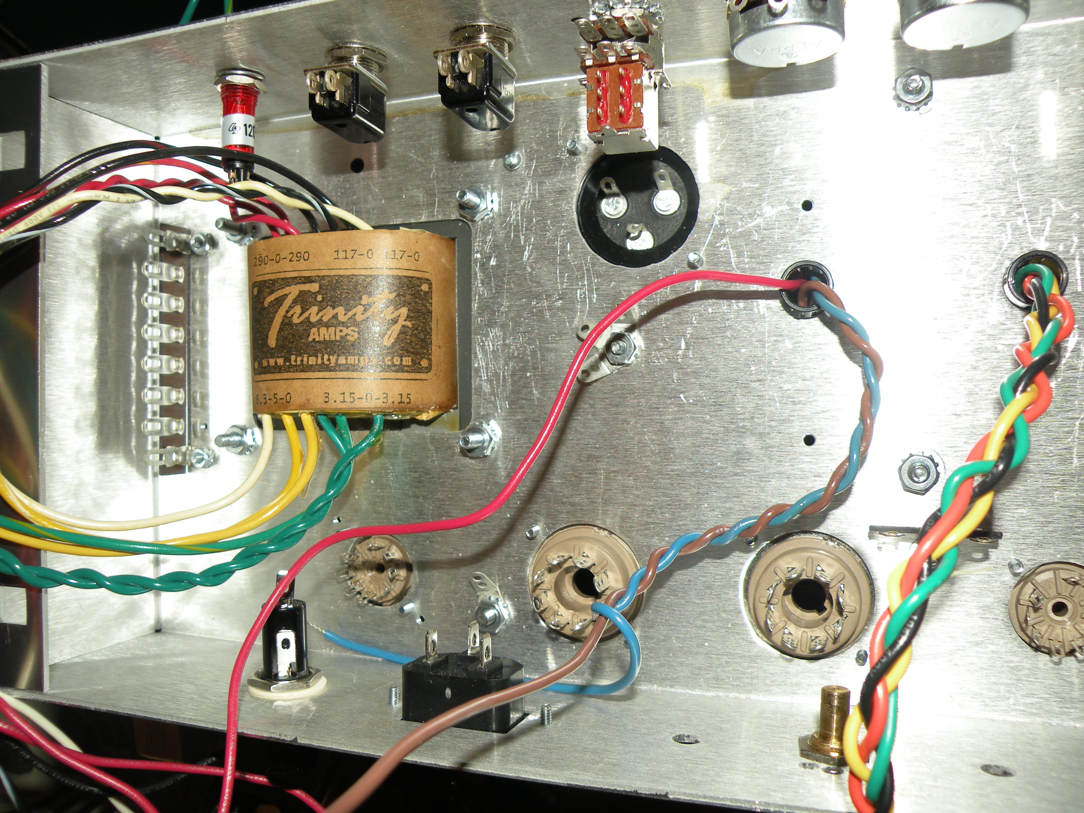

First, Power Transformer and Output Transformer installed (OT primaries twisted and OT secondaries braided). The two extra 5k primary (blue-white, brown-white) tied off with heat-shrink and put outside the chassis (tucked under the OT).

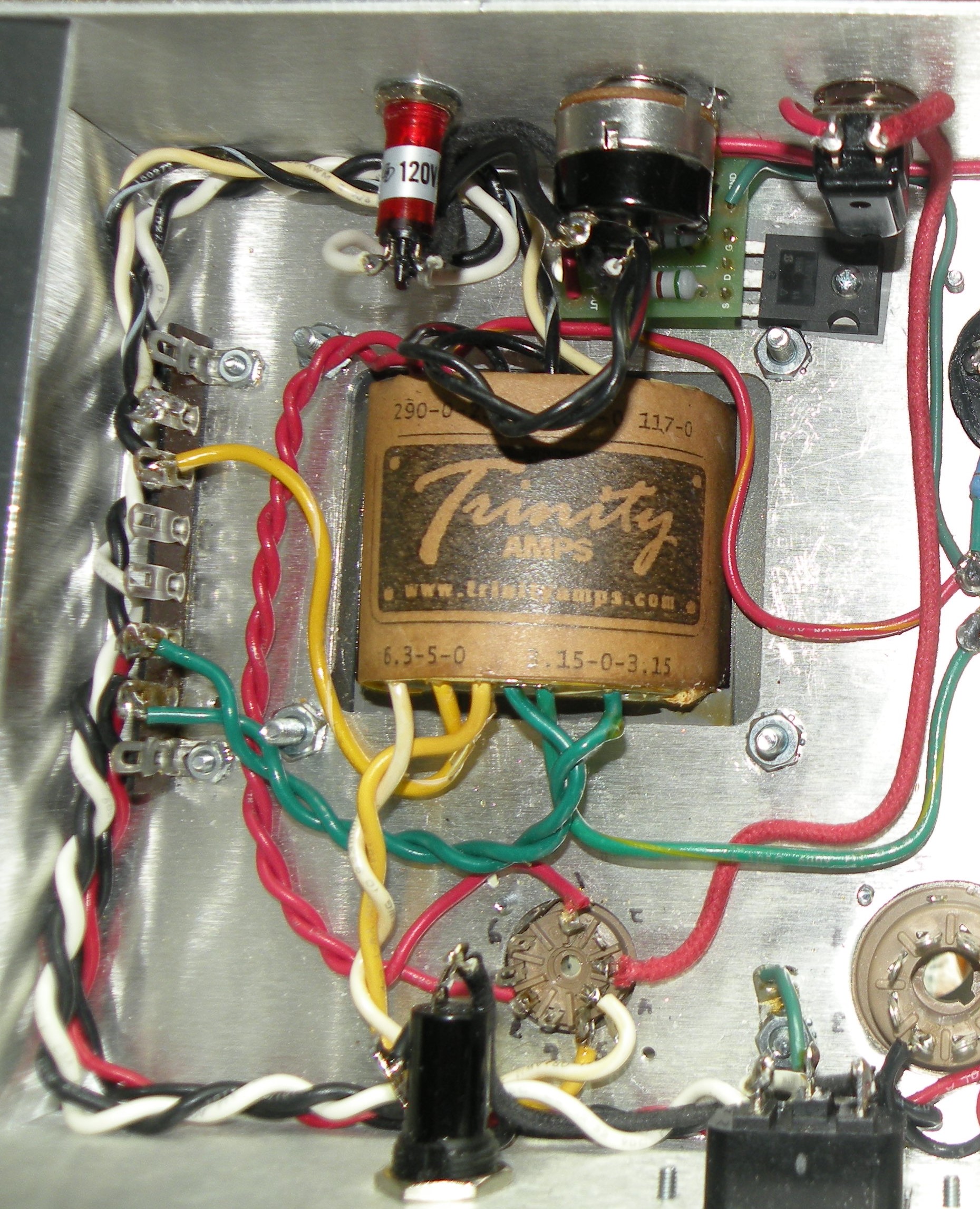

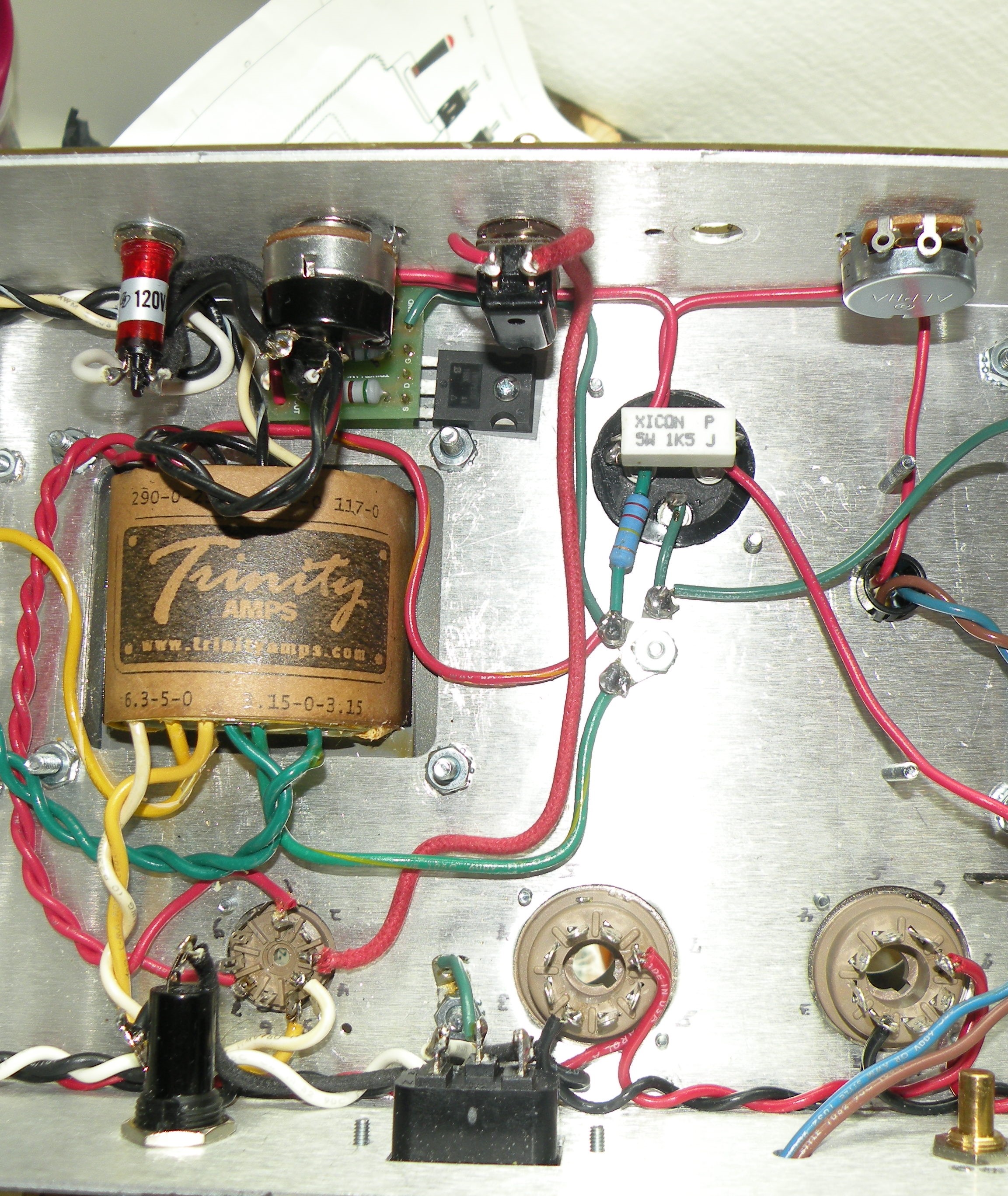

Second, Power Transformer wired to mains, to switch with VRM, to terminal strip and to rectifier.
Third, closeup of wiring of the fuse and the mains (120v).

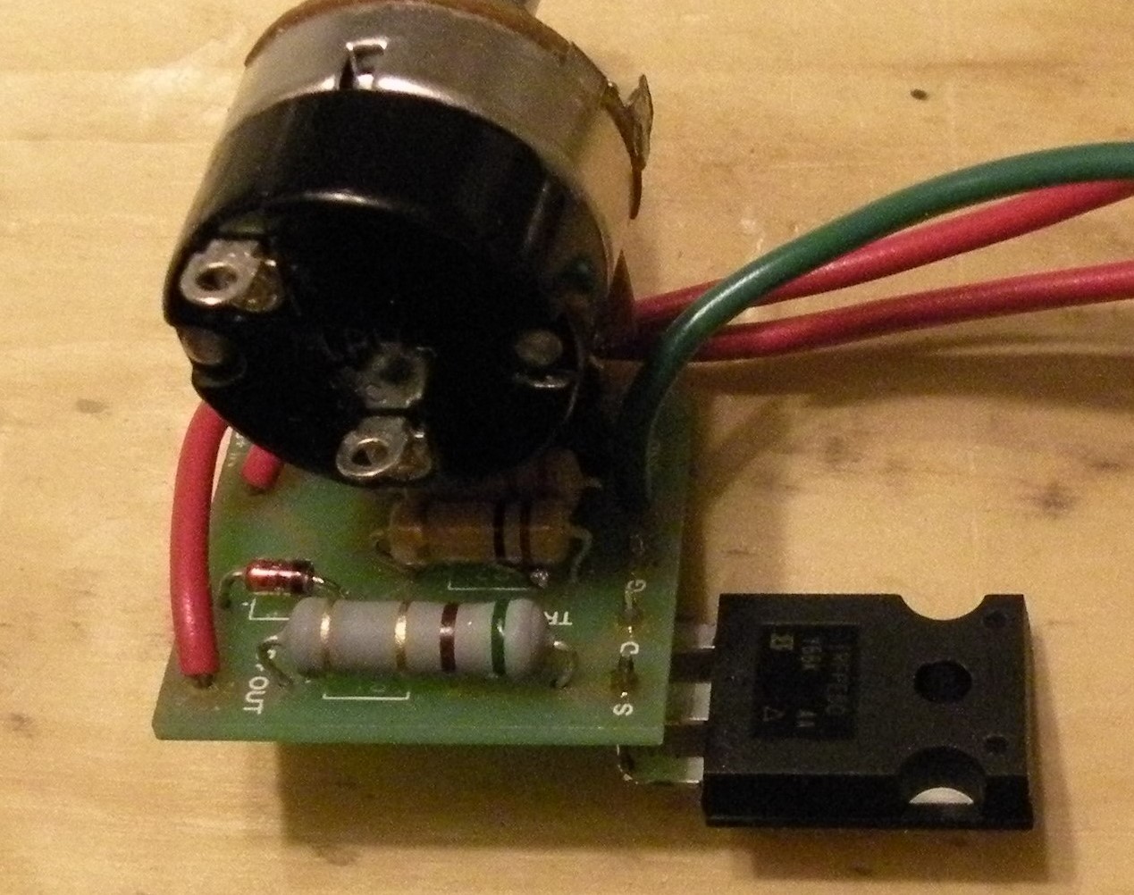

Fourth, VRM pre-wired prior to installation.

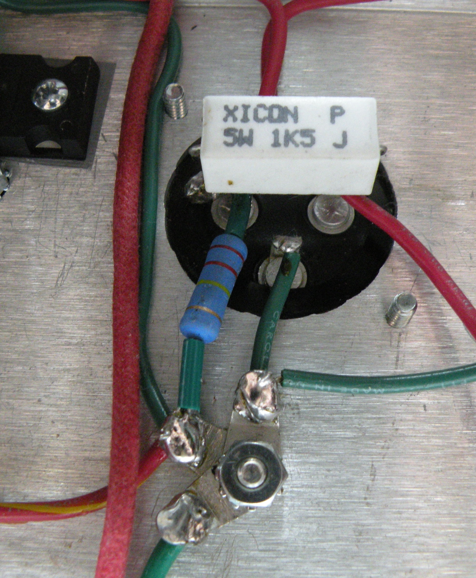

Fifth, I added a permanent 220k 3watt Drain/Bleed Resistor as suggested as an option in the manual. I installed the resistor across positive B+ side of the Canister Capacitor and connected it to power ground star. [See this thread for more info: https://trinityamps.com/phpbb/viewtopic.php?f=7&t=3415 ]

PostPosted: Sat Sep 09, 2017 2:48 am
Looks good!

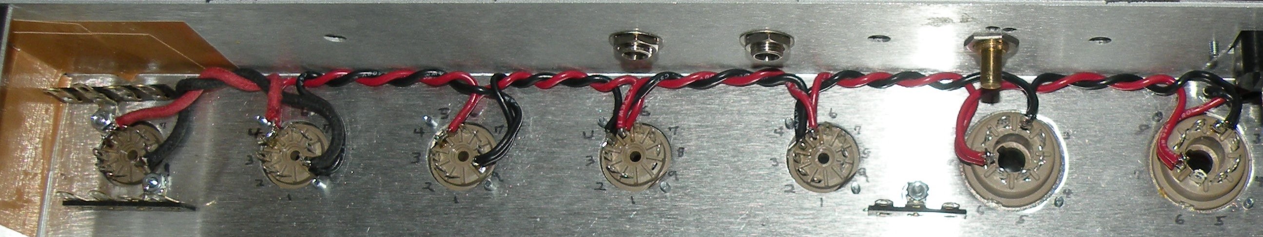

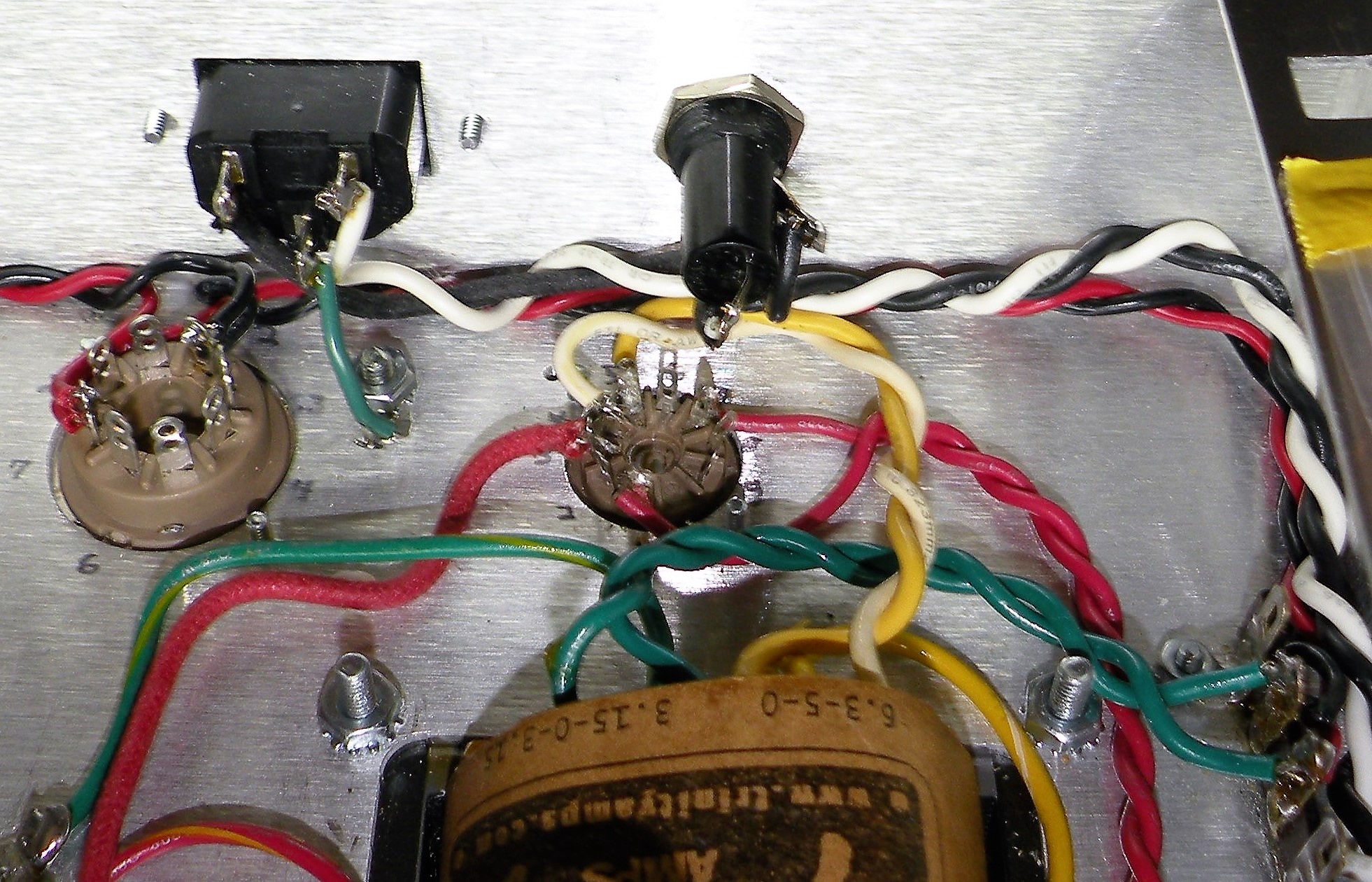

Heaters wired. I made a mistake and ran out of the provided red and black wires; so I added some 18 gauge cloth wire for V1 heaters.

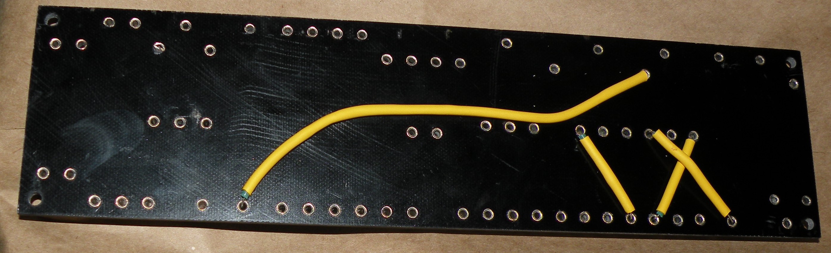

Jumper wires installed underneath Turret Board; I added some yellow shrink-tube over the wires just extra insulation.

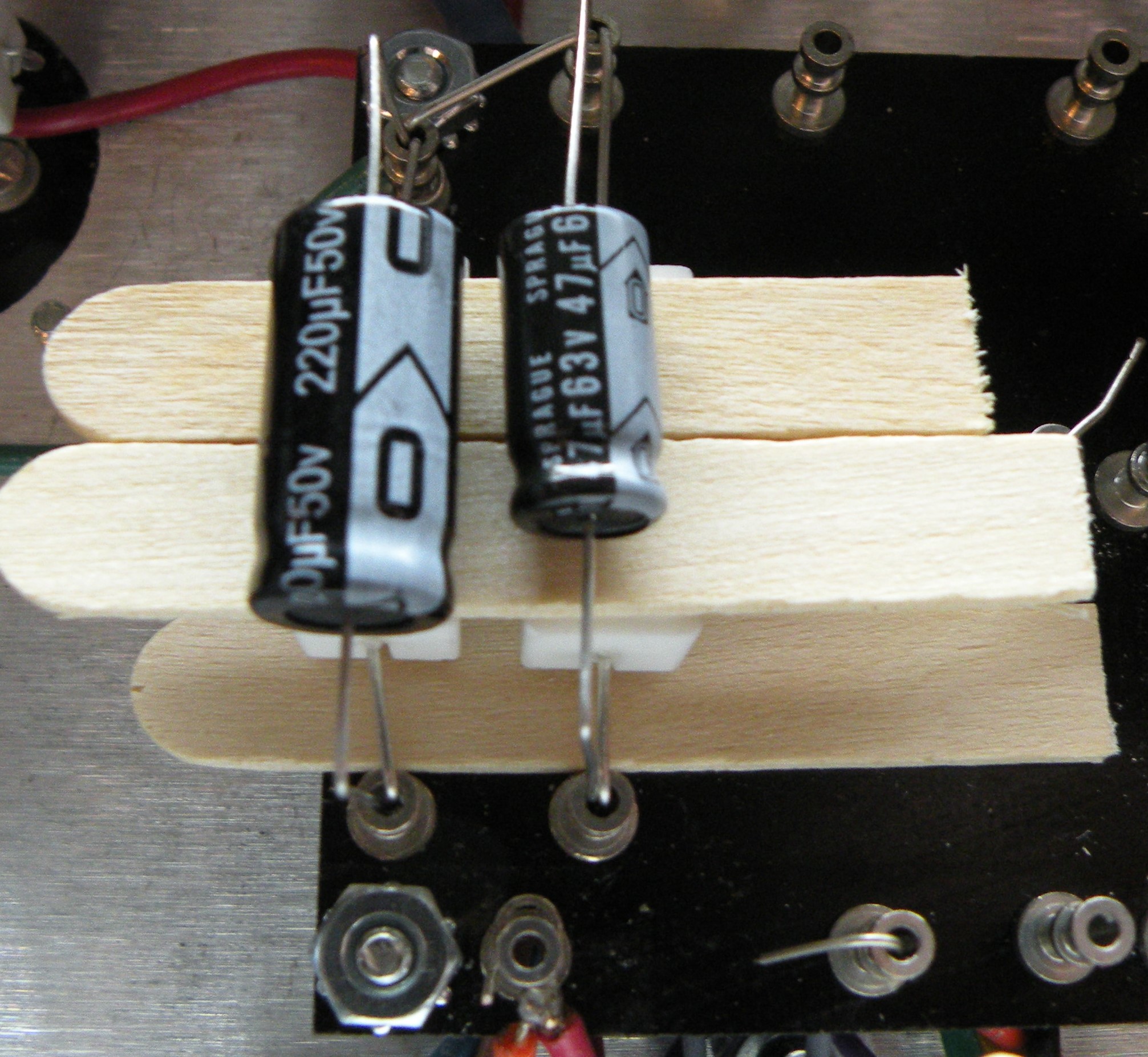

5 watt bias resistors placed on Popsicle sticks for an 1/8" gap.

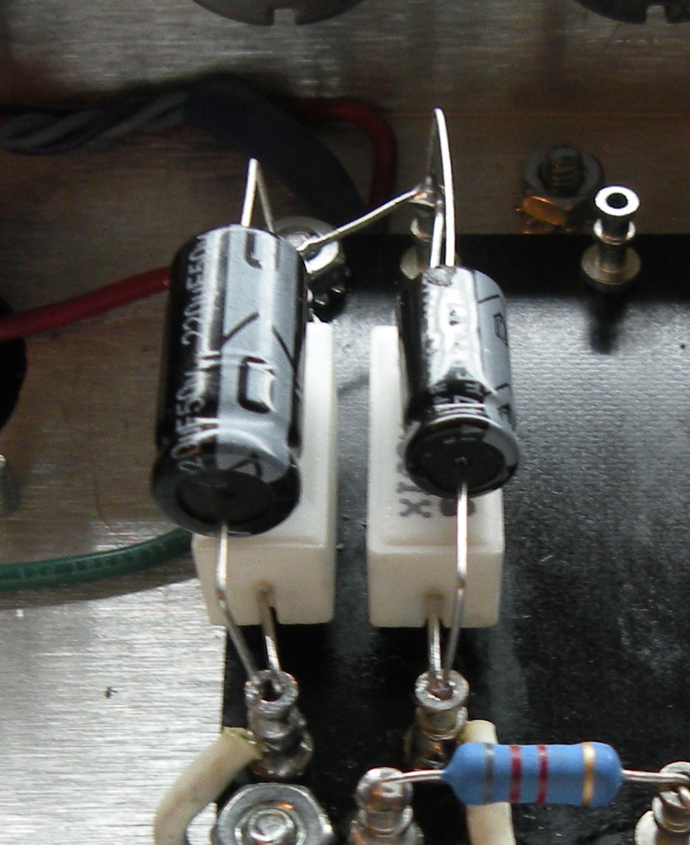

Piggyback bypass capacitors stacked on top of bias resistors (again using Popsicle stick for spacing).
Popsicle sticks removed.
Also, I tinned (added solder to) the leads on both bypass capacitors to give them more rigidity and stability. I noticed that it was too easy to bump them and have them fall down too close to the resistors. Tinning the leads gave a better "posts" for their support.
