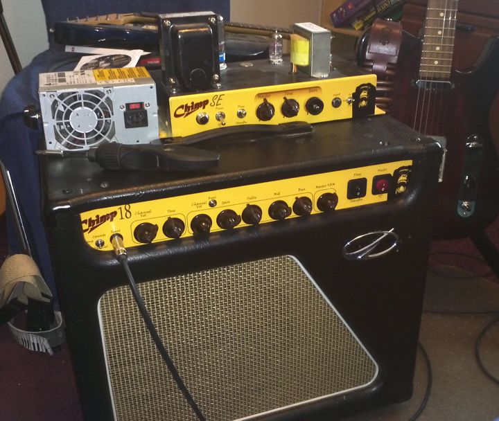

I didn't make any allowances for overloading the PI since the last thing in either channel before the PI is a volume pot. I just use the VRM as a master volume & adjust the channel volumes & TMB gain to taste. I haven't really noticed it being an issue. Mine has a single input going to both channels so I can blend them with the channel volumes. It's also set up with a channel cascade switch, but I don't use that mode much.
I had my brother-in-law's dead Epi Valve Standard on the bone pile (swapped him for some guitar mods), so I gutted it & started over. It already had Merc trannys so I didn't really need much other than a turret board, cap cans, better tubes, & a VRM. It has a Celestion Vintage 30 in it at the moment, but it's a bit harsh. I have an extension cab with a G12K that sounds MUCH better.
BTW- Perched on top is the much-evolved single-ended amp you & Z helped me with quite a while back
** b0b0 **
- This Space For Rent -
PostPosted: Sat Feb 18, 2012 12:08 pm
Posts: 226
Location: Dallas, Tx
Nice attenuator you have there. :)
Les

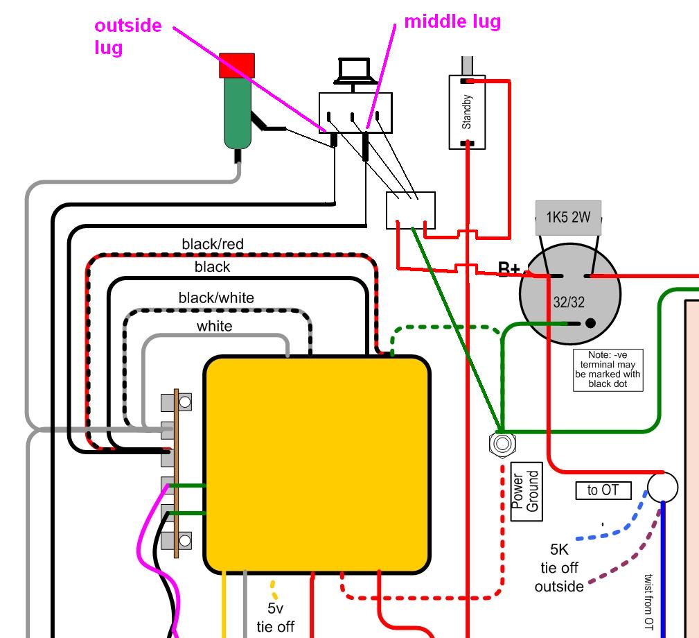

rather than start an all new thread...have i got the wiring right as shown in my diagram...
power comes into the pot to the middle lug of the body...while the outer lug then goes to the fuse and to the lamp?
from the stand-by switch into the VRM module and then out to the filter cap...
PostPosted: Thu Jan 03, 2013 5:33 pm
If the long black wire going off the picture should be going to the fuse which is connected to mains coming in( if i remember correctly)
So in your pic the long black wire should be conected in the middle and the one on the outside should be going to the lamp and the transformer
PostPosted: Thu Jan 03, 2013 7:32 pm
Posts: 138
you're right....that long one heads back to the fuse...thanks...I'll modify my pic and repost tomorrow in case some one else has the same question
PostPosted: Thu Jan 03, 2013 7:33 pm
Posts: 138
