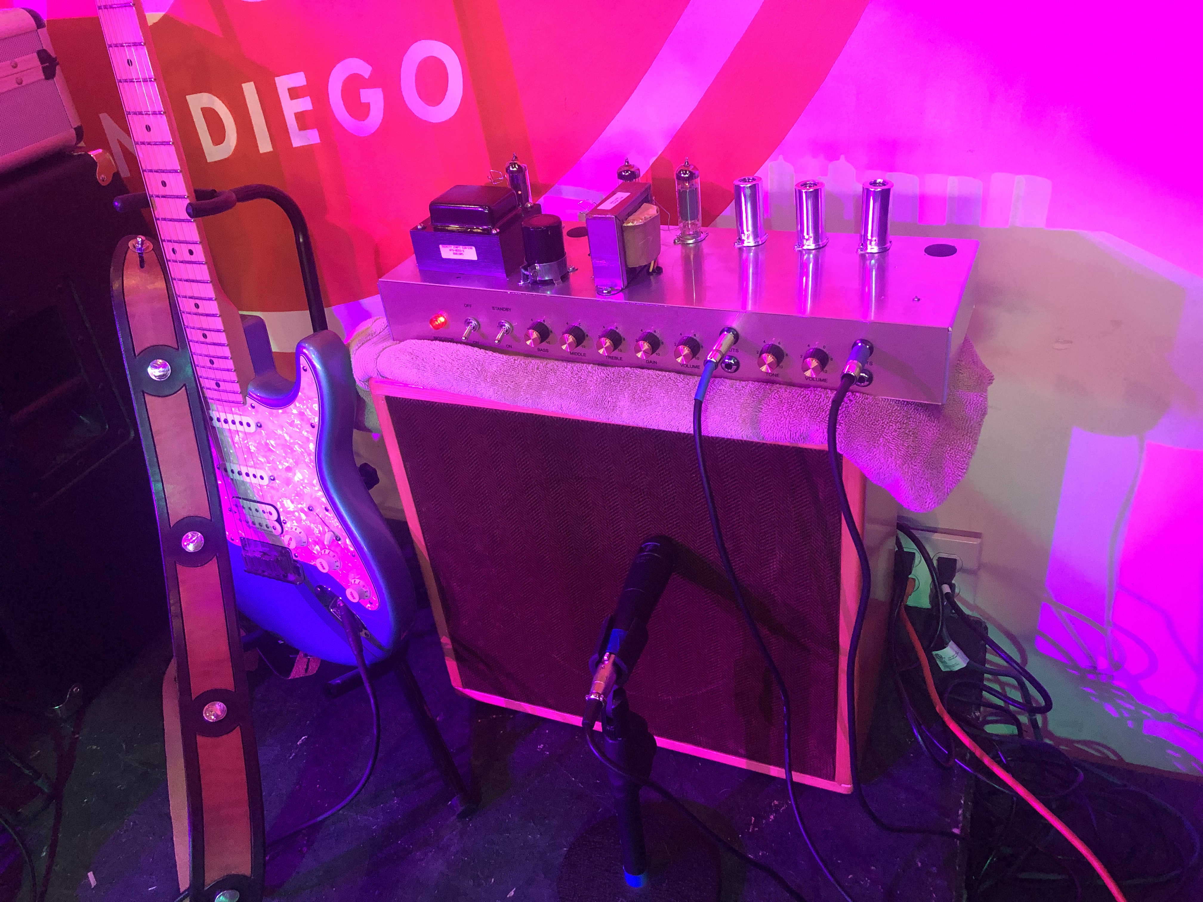

Thought you might enjoy this photo, Stephen. Still working on the cabinet, but could not wait to hear this thing in action. I may still try some mods to try to squeeze out more gain. I needed some boost on the TMB channel to get that punchy Marshall tone I was looking for, but boy I found it! Using a Boss equalizer pedal to drive the front end, all may band mates agreed it sounded amazing!

Nice! I guess the problems got sorted!
