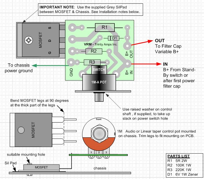

So here's a question regarding the schematic and the build diagram.... I'm trying to reconcile my limited knowledge, please feel free to correct me...
The schematic for the VRM shows pin 3 of the pot going thru R3 and into ground....The build diagram shows the left most pin on the pot (when viewed from the front) going to R3 and ground... isn't the left most pin normally considered pin 1?
Just trying to sort out the hum, which I assume is a ground issue and yet everything else seems grounded OK...as I've mounted the Mosfet/PCB separately from the pot, just wondering if 1 and 3 are crossed....

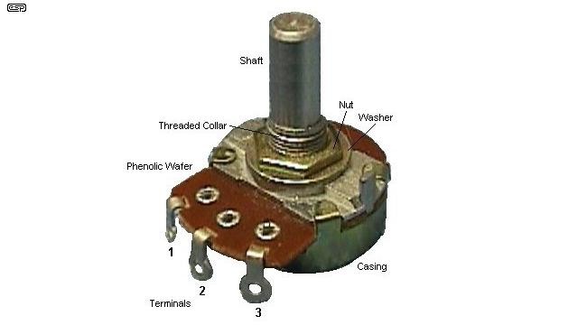

Here's a good picture. Remember when the pot is upside down, the numbers go from right to left - 1-2-3
It's not uncommon for me to get here numbers reversed.

I think I'm viewing this right... which is why I'm confused... looking at the schematic..
Drain from the MOSFET to #1
3 to R3 and ground....
The little build diagram shows the pot sitting on top of the PCB so the pins would be ordered 1, 2, 3 as you look down and have the switch over the PCB. This leaves pin 1 on the ground via R3 and pin 3 is on the MOSFET drain
Or am I viewing something upside down? or really..will I harm something if I try to reverse what I think are 1 and 3... I suspect my ground hum would go away... but I'm still thinking I'm viewing the build drawing correctly....

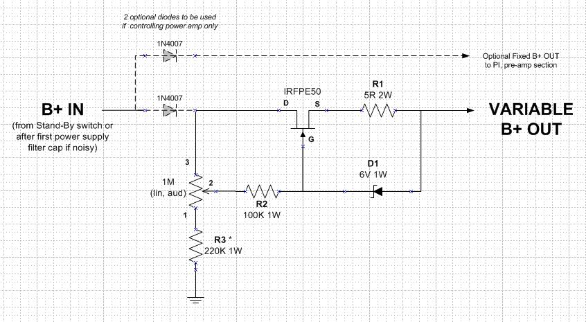

I checked and updated the information. I wasnt too worried since I expected most people to use the board attached to the PCB, but this should clarify things.

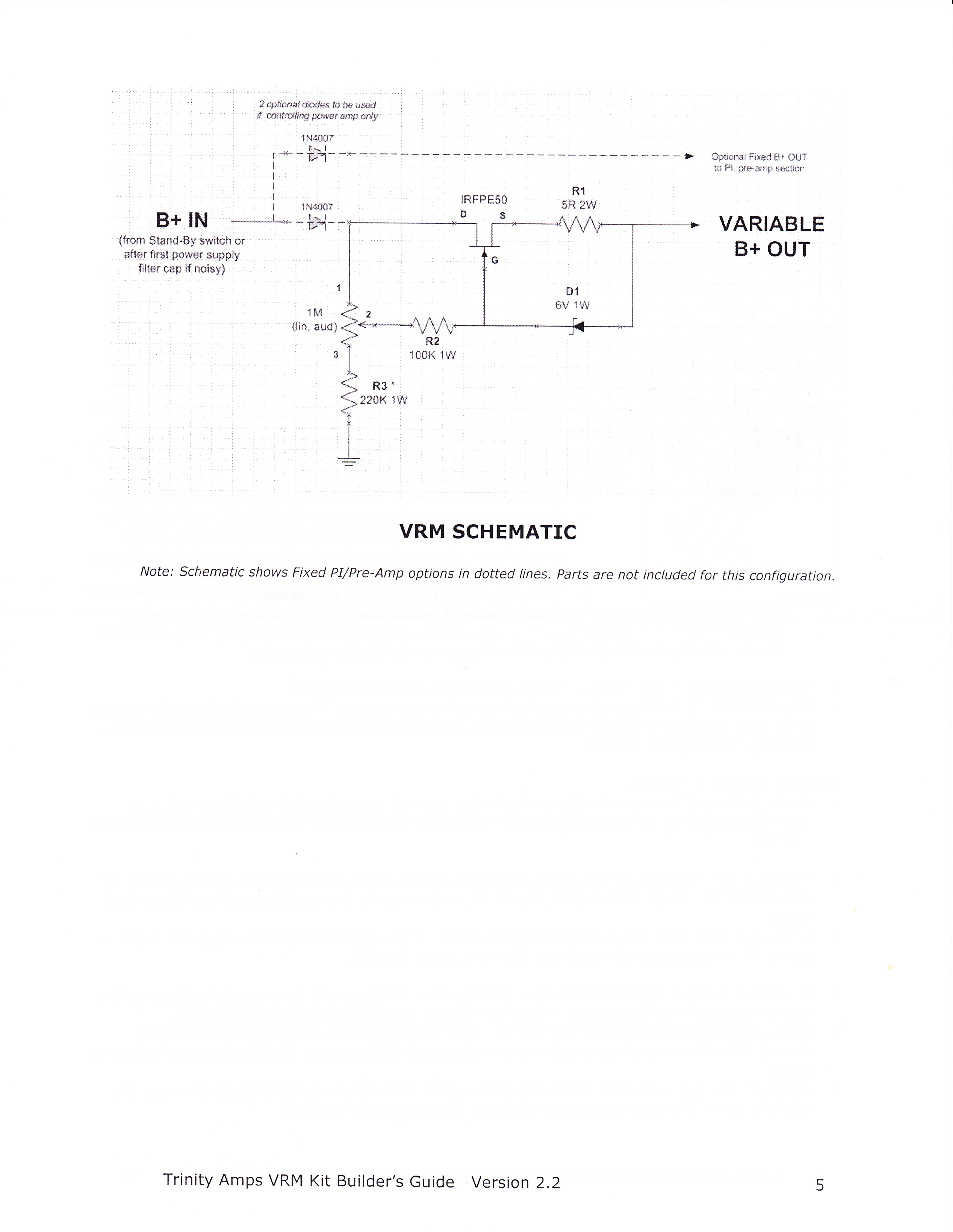

I've attached a scan of the schematic I have... which shows the 1 and 3 pins reversed.
So, I suspect what you posted is what I figured is should be. I guess I'll rewire my 1 and 3 and see where it gets me.

I did NOT change the wiring, I did have it wired as if the pot were mounted on the board. I realized that you'd updated the schematic to reflect the layout drawing and not the other way around.
