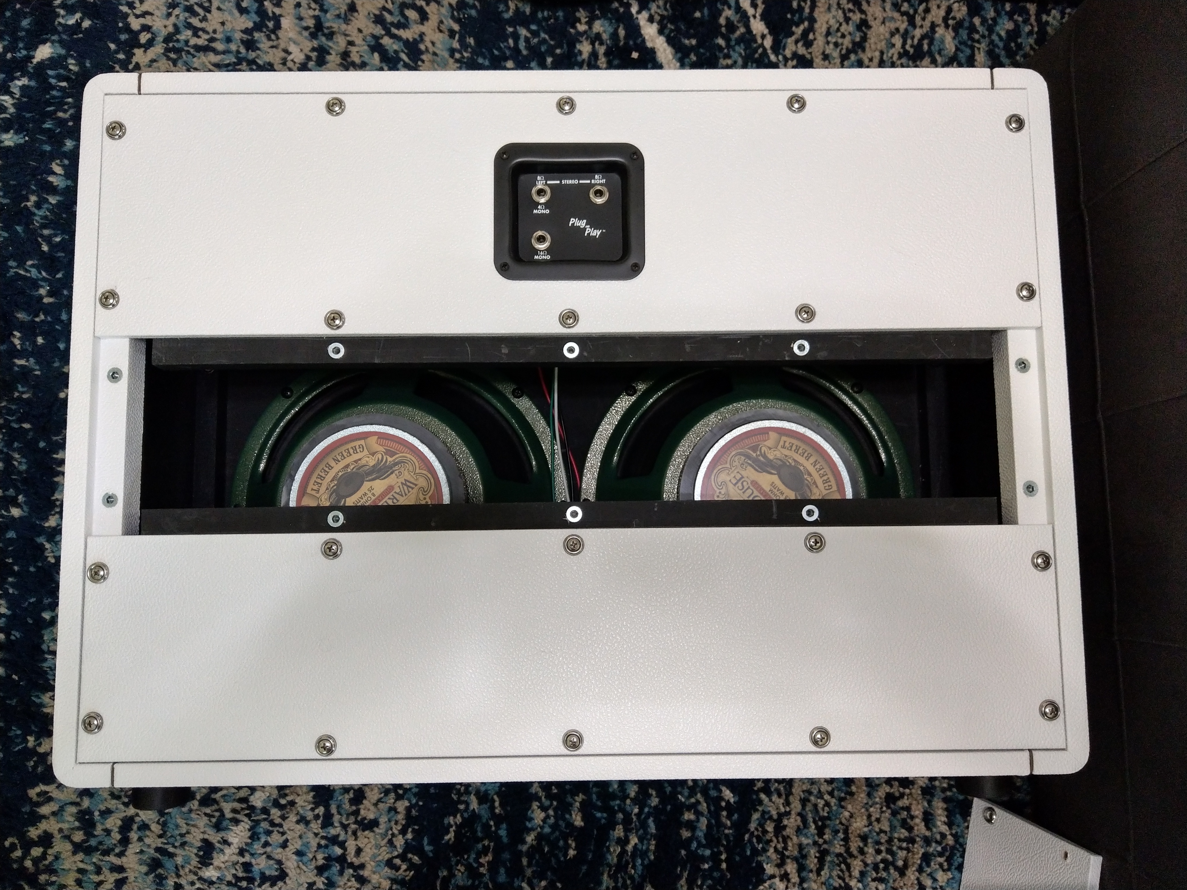

My cabs came in this week and I loaded up the extension cab with 2 12 inch WGS Green Berets. I didn't use the extra foam pieces that came with the speakers, I assume that is if you are front mounting them? Trying to run some music through it to break them in while I finish up the amp. I have the cab in fully closed back mode right now. Will experiment later on with semi-open back too.
I got the cab and head cab from KC at guitar cabinets direct. He was a pleasure to work with and they look great! Hot White Bronco with gold piping and Bluesbreaker grill cloth.

The white cabinet with the gold piping and Bluesbreaker grill cloth looks amazing. Really nice workmanship.
Yes, the extra gasket material for the speakers is so you can front mount them.

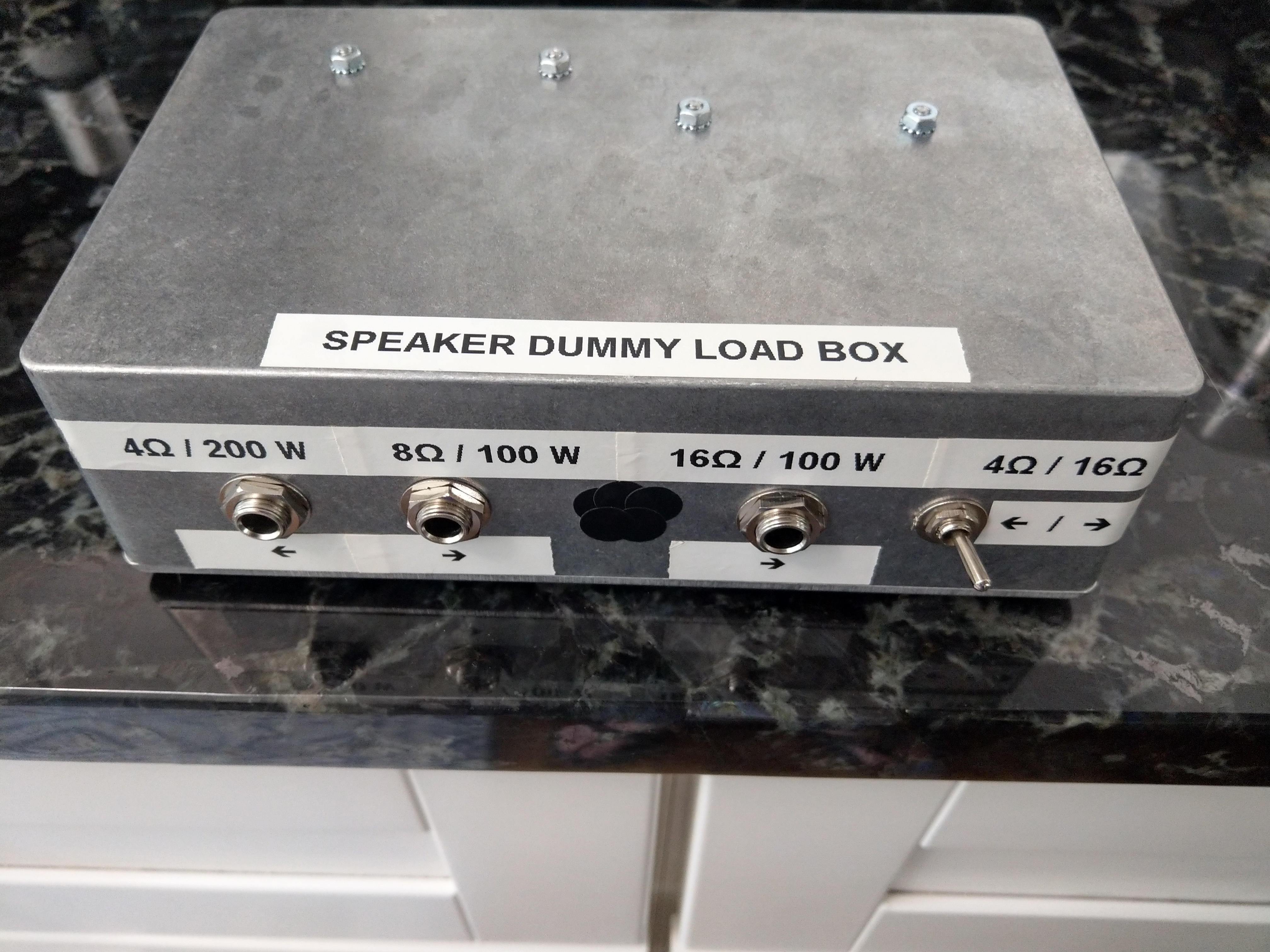

I made my dummy load box and tested. Realized after that the 4 and 16 Ohm jacks are in parallel, so I could have just used one. Also, tested this out with a 15 watt 2x6v6 amp, not quite dimed but about 90%. The enclosure got pretty warm after about 25 minutes. Wouldn't want to keep my hand on it more than 10 seconds. So, I ordered some heatsinks and thermal paste. Should be here tomorrow. I was a little surprised by how warm it got, since it should be able to handle 200W at 4 Ohms, how I was testing it. Hoping I cant get it up to at least an hour of use at a time for burning in the amp.

I also got some thermal paste and heat sinks for my dummy load box. I put the paste on the bottom of the resistors where they touch the enclosure and under the heat sinks where they touch the enclosure. I didn't realize that the thermal paste wouldn't also adhere the heat sinks, so I ended up adding some glue afterwards. It works great now, barely got warm with my same setup as before.

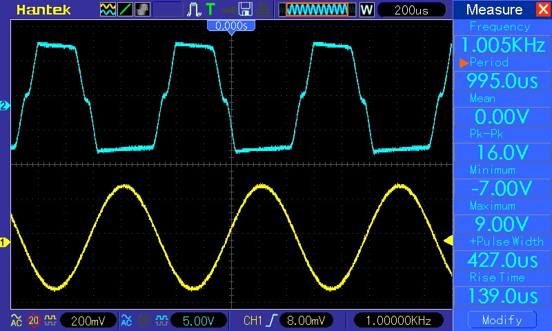

Alright yall, I'm back and hoping this post may help shed some light on where to look to fix this issue. After much digging on several forums it seemed like I was going to need a scope to properly diagnose the problem, so I took the dive. Here are some screenshots from the scope. It appears to me, I am dealing with crossover distortion. But, not sure what to do about it.
I ran a 1K sine wave into the input of the amp, from an app on my tablet. I'm commenting the amp settings in the caption below each picture. Scope was on on the output jack. I'm attaching pictures at clean settings and then the setting where crossover distortion is most apparent. Past that it goes very square wave.
On the Plexi channel and with them jumped, I can control/effect that hump in the trough with the treble control.
After this I did probe a few different parts of the signal, and I believe this problem first shows up pins 3 of the power tubes.
Let me know if there is anywhere else you would like to see scoped out or anything different, etc. I have a lot more screenshots at volume settings 2, 4, 6, 8, and 10 for a few configurations.
