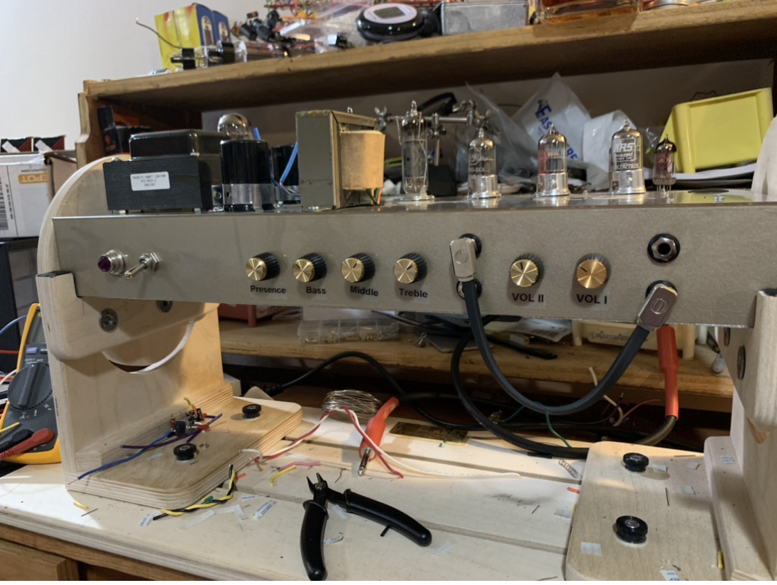

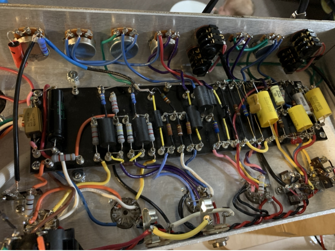

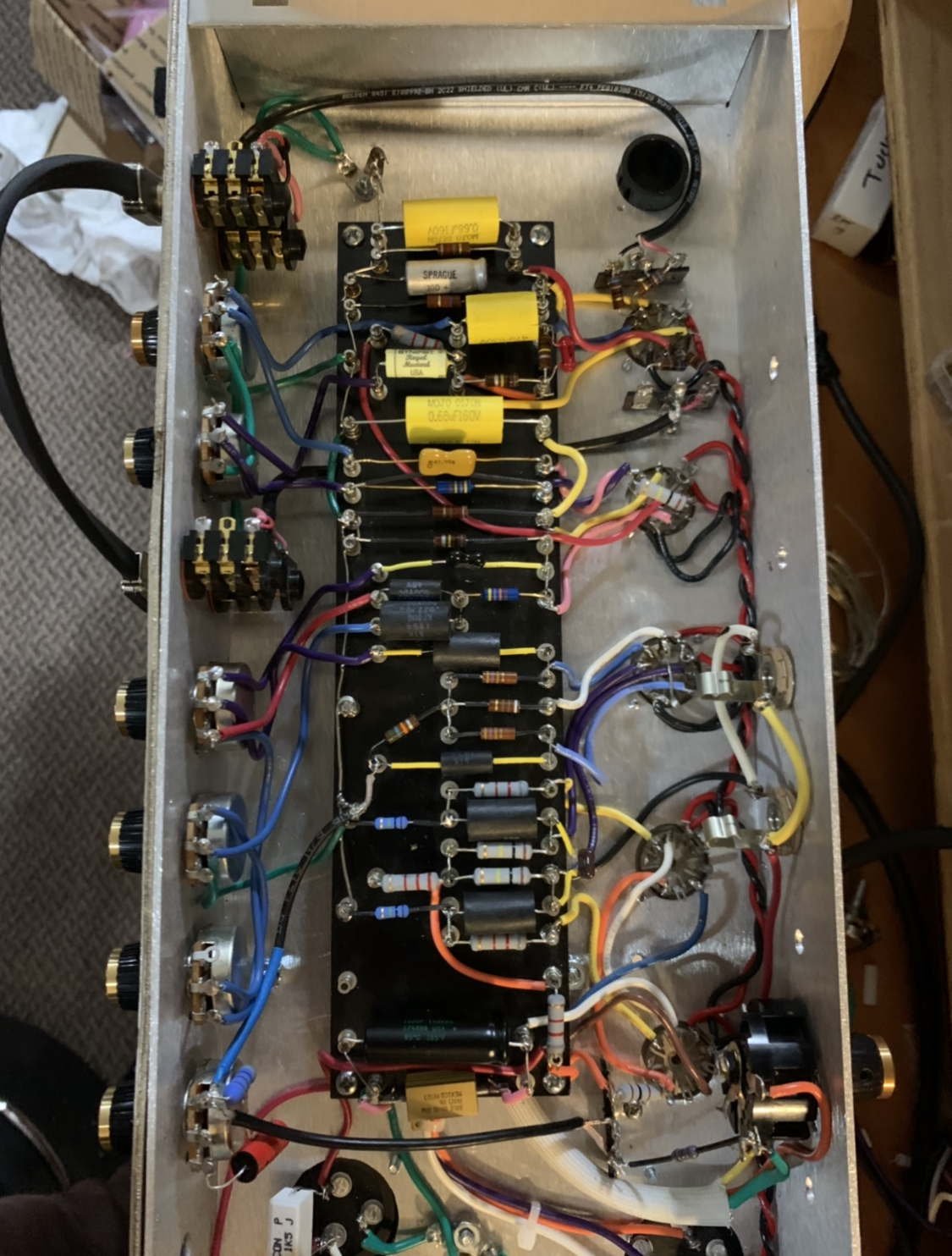

Just finished a super fun build on a trinity 18 watt platform. It borrowed very largely from the mkii circuit with an identical cathode follower and phase inverter, however instead of a normal and tmb channel, I made a normal and bright channel like a full size plexi, and had them mix before the CF instead of at the PI. I did however give V2 its own filter cap and also used a gz34 rectifier.
I left out any kind of Master Volume but did add some NFB and a presence knob to keep things together a bit.
