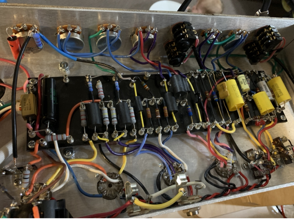

Just finished a super fun build on a trinity 18 watt platform. It borrowed very largely from the mkii circuit with an identical cathode follower and phase inverter, however instead of a normal and tmb channel, I made a normal and bright channel like a full size plexi, and had them mix before the CF instead of at the PI. I did however give V2 its own filter cap and also used a gz34 rectifier.
I left out any kind of Master Volume but did add some NFB and a presence knob to keep things together a bit.

PostPosted: Tue Nov 24, 2020 5:14 pm
Posts: 31
Sounds great!

PostPosted: Tue Nov 24, 2020 7:32 pm
Joined: Fri Apr 13, 2018 7:46 am
Posts: 19
dbharris wrote:
Sounds great!
-Dan
Thank you.
I’ll try and get some proper clips up once I’ve spent a little more time with the amp. Those were thrown together through a captor X while the kids were sleeping.
