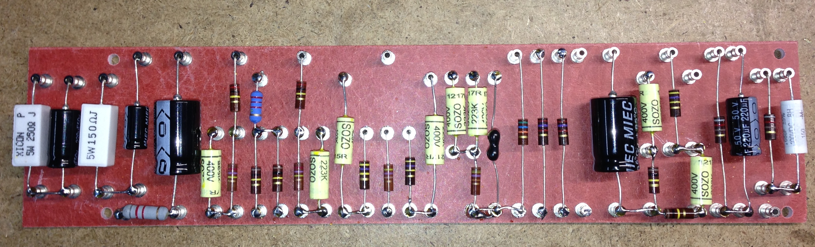

So I am building an 18Watt Plexi with the 6v6 option
This is my first Trinity kit but have built other amps.
I am pretty much following the schematic. I am using my own wire
for some areas other than that pretty much using all the parts that came
with the kit.
So here is the turret board almost finished, have not decided yet how I am going to do the bus wire

PostPosted: Sat Sep 21, 2013 11:02 pm
Excellent job on those heater wires.
For the buss, I take a piece of solid correct 22 ga, solder it at one end, stretch it to the other end and solder it in place. Makes a nice straight line.
