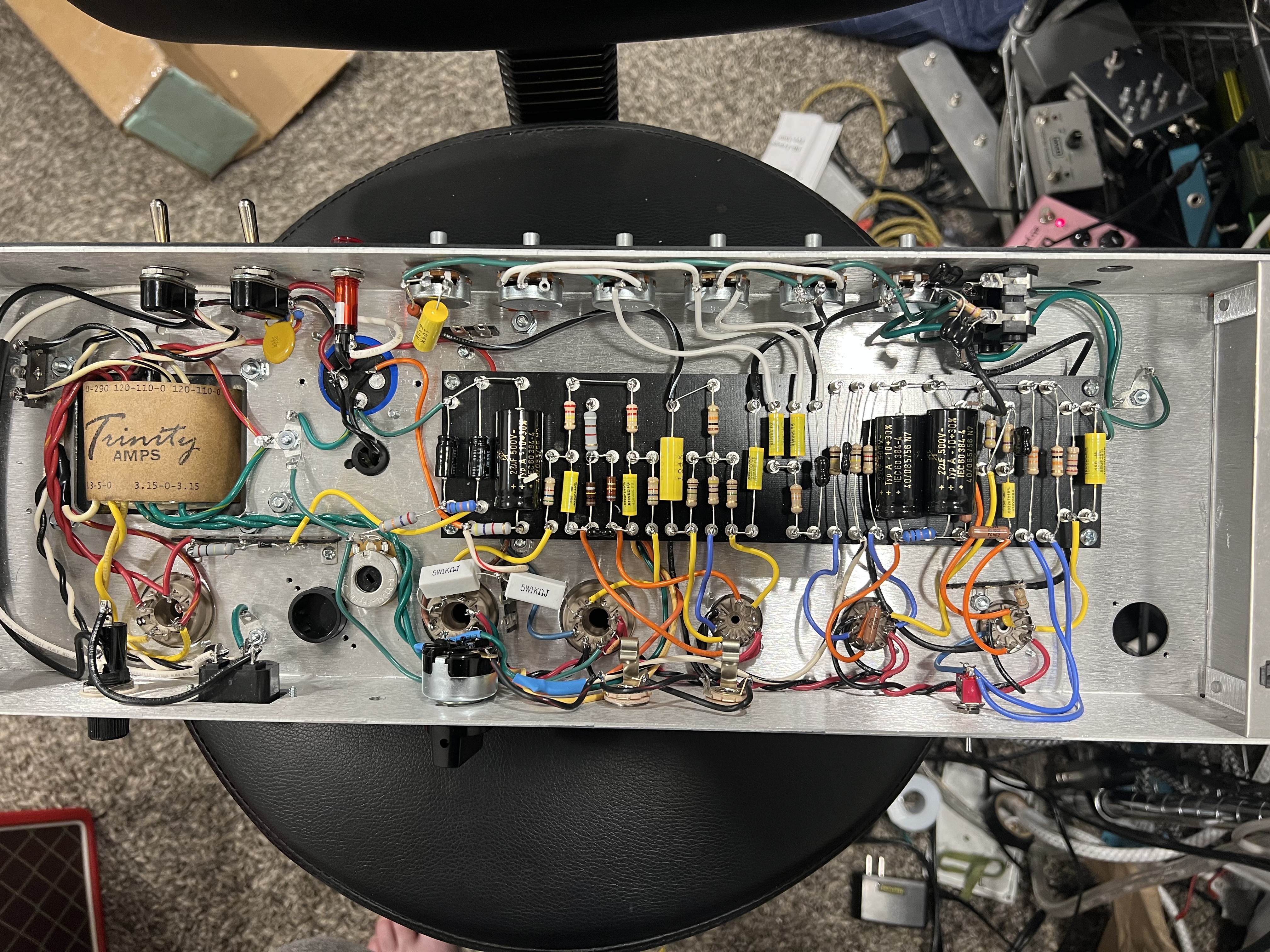

Just finished soldering! Of course UPS came at the last minute today so had been waiting on the grommet and 4.7k resistor all day. But it’s done. Fired it up, Voltages looked good. Popped tubes in and….wasn’t able to bias it. Just going to drop it off at my amp techs and have him give it the once over. If it needs different value resistors or something I don’t have them anyways. Darn was hoping to crank it rock some riffage, but guess I will have to wait a bit.

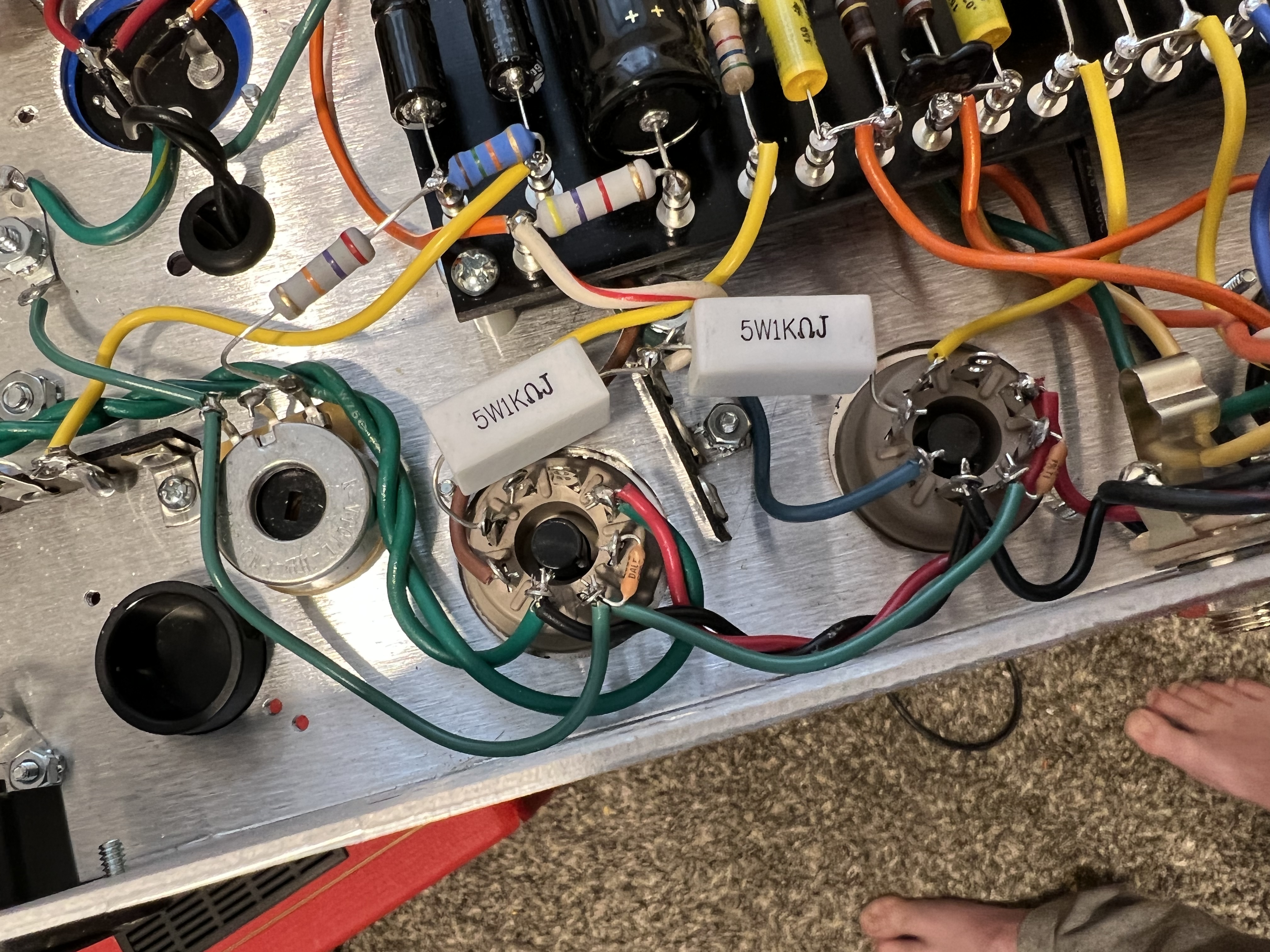

Yeah I don’t care for most JJ tubes, Ehx are my fave 6v6 so that’s what I have for this one. I just swapped tubes and got the same result. Here’s a pic with the impedance selector out of the way.

Posts: 181
"Same result" do you mean the 42mA bias stayed with the socket (V5)?
If its not the tube and its the socket, then I'm running out of ideas.
Voltages look good on pins 3 and 4.
Your negative grid voltage looks good.
Maybe something to do with the 1-ohm resistor on the "faulty" socket but I am not sure. Given that pin 1 on V5 has two wires and the resistor lead, its possible the extra soldering time on that pin may have overheated the tiny resistor. I don't know.
You could try a different method of determining plate current to see if you arrive at the same numbers. However, these other methods are generally a little dangerous compared to the method of using the 1-ohm bias-sensing resistor.

Given you have near-identical plate and screen voltages between V4 and V5, and identical grid voltages on pin 5, it seems the problem must either be the tube or the cathode pin 8. Maybe the connection between the 1-ohm resistor and ground. Or the 1-ohm resistor. Or the socket itself. Possibly one side if the OT is significantly higher resistance than the other?? idk.
A common error is to set the meter to mA when doing bias measurements across the 1-ohm resistor. I've done that myself, which is why I suggested that.
Good luck with getting it sorted out. I'm sure the 2204 circuit through 6V6's will sound incredible.
Report back when you get it up and running. Your lead dress looks great and it seems like a very clean build.
