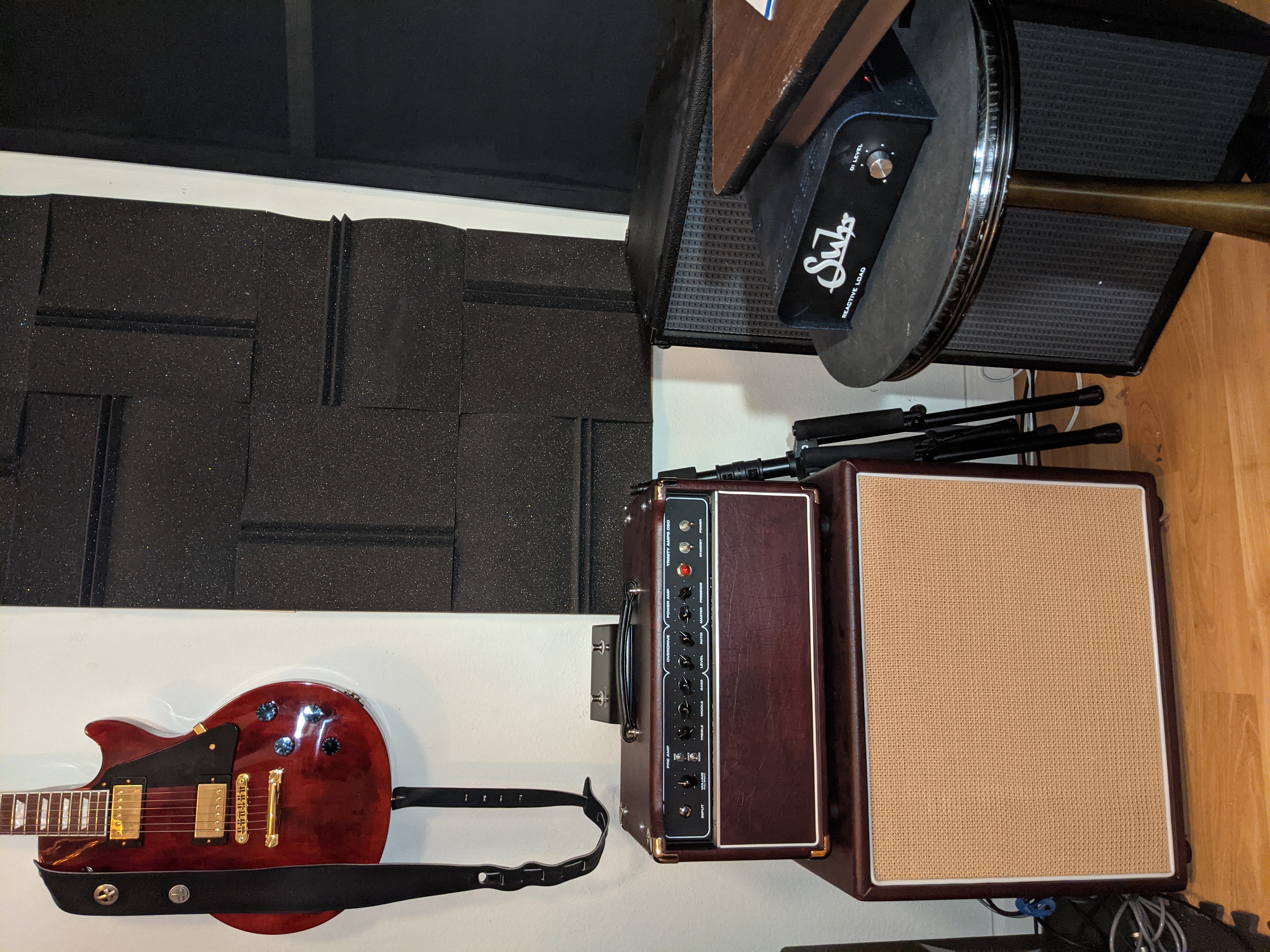

Since my 18W Custom 6V6 was my last build, I thought I'd just post this here...
Finally gave it a proper home:

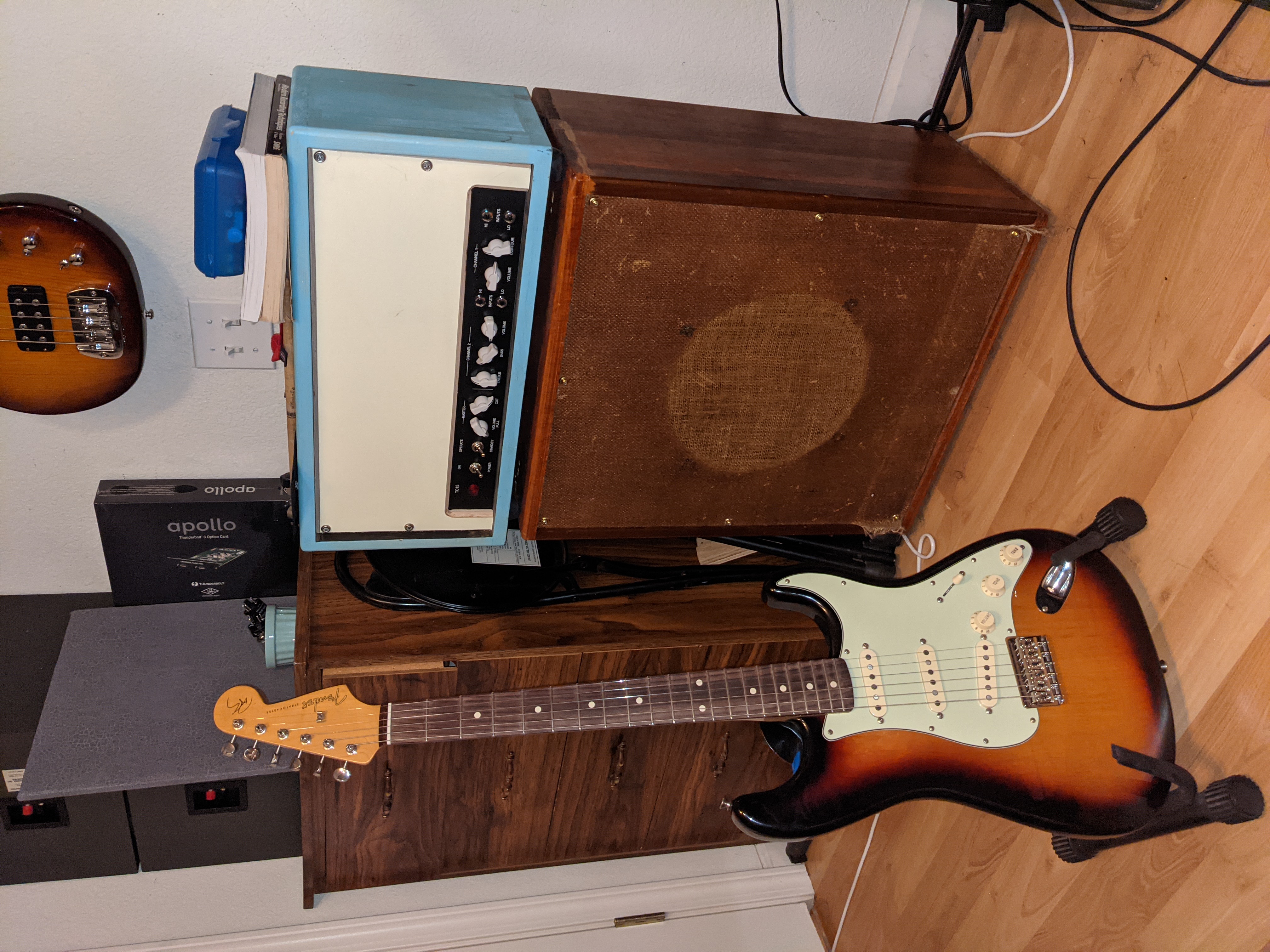

The cabinet here is an Avatar that I assembled back when they used to sell their cabinets in a flat-pack. It has a Scumback in it... can't remember the model for the life of me... lol. The amp underneath it is my "Simple 20b"... a modified Simple Preamp married to the 20W PP power amp from AX84.com (may that site r.i.p.)
And my TC15 (first amp I ever built):
The cabinet here is the one from the AX84 website... an oversized 1x12 ported in the back. Huge sounding cabinet, but tough to lug-around. It has an old V30 in it, which believe it or not, actually sounds really good with the TC15.

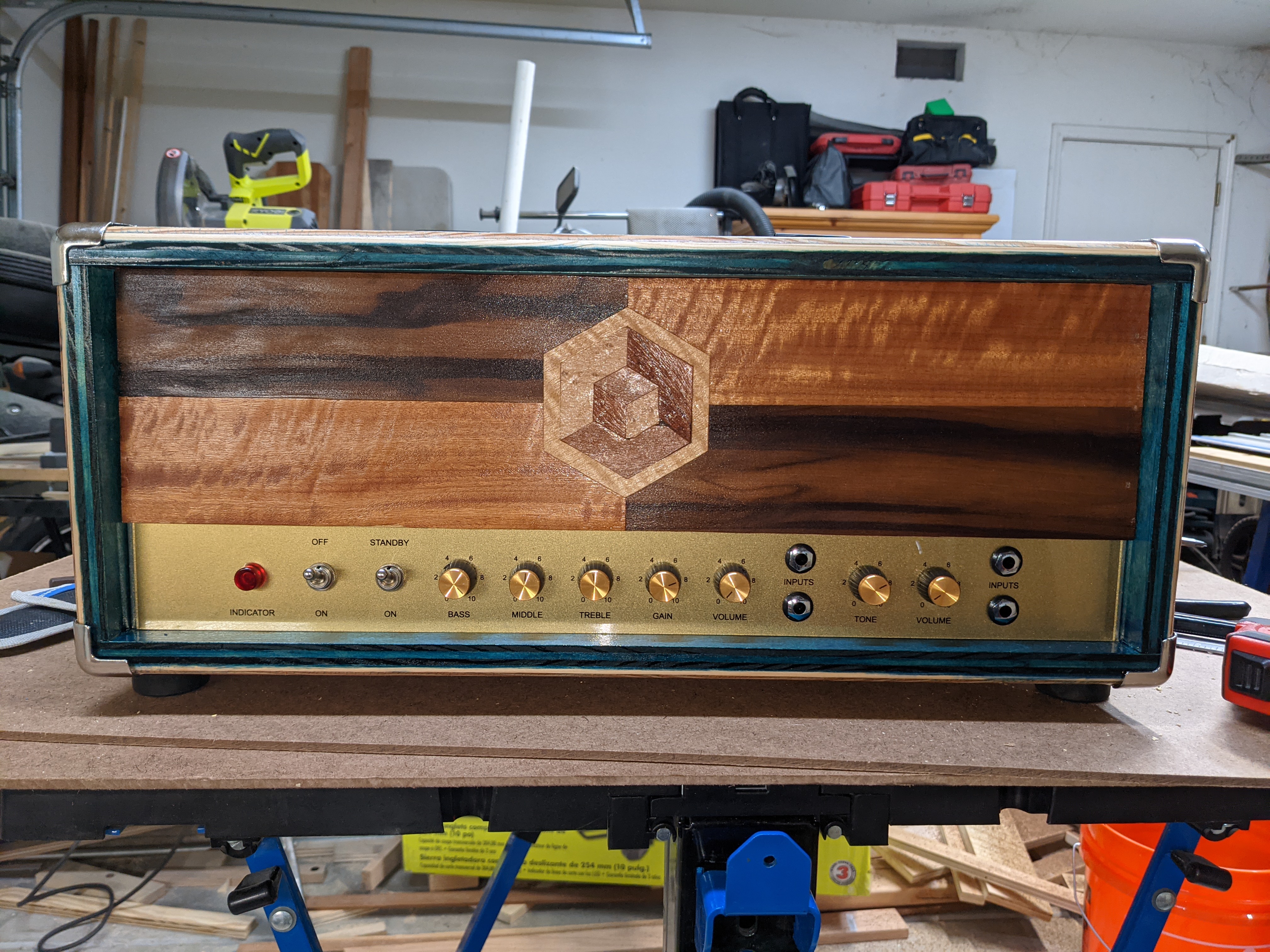

And my OSD:
The OSD head cabinet was built by Coco. The speaker cab was built by TRM Guitar Cabinets and tolexed by me. It's his "3D Cabinet" and is loaded with a WGS ET65. Drat - that picture reminds me... I need to put the corners on that speaker cabinet!

A little bit about the 18 Watter... I did a couple of things differently in it.
First off, I used a set of ClassicTone 18W transformers only because I wanted to reduce the cost of the kit and I had these in an 18 Watt Lite IIb that I built way back and never really bonded with., so it was just collecting dust. I'm sure the Trinity/Heyboer set sounds amazing and if I didn't have these laying around collecting dust I would have absolutely gone with Trinity's Trannies. But, I am more than happy with these transformers and they dropped right in the chassis with no modifications required. Now I just have a wired-up Lite IIb chassis layin around collecting dust ;-p Oh and I have a Trinity VRM module that was in there at one time laying around too... it will probably eventually find its way into this 18-watter.
Secondly, I used a pretty large bypass capacitor on the output tubes - 1000uF if I remember correctly. I was never really a big fan of the "sag" sound so I wanted to stiffen-up the output section a bit and give it more of a fixed-bias feel. It delivers!
All in all, I am really loving this amp. I also bought a new (well hardly-ever-used really) Les Paul about a year ago and man it sounds great with this setup into the Avatar/Scumback cabinet. I never really was a fan of the "18-Watt Sound" mostly because of the EL84's (I'm more of a 6_6 guy which is strange because I really love the sound of the TC15 and its EL84's but its a totally different beast really and it never really leaves the "Matchless mode.") When I saw this amp was available with 6V6 tubes, I jumped at it and not regretting the decision at all. Now don't get me wrong, the Lite IIb certainly doesn't suck at all and it surely has its legion of fans and was a fantastic 2nd build for me... but oh man... this Trinity 6V6 Custom just blows its socks off!

Those pictures don't do the "illusion cube" optical trickeries any justice. In-person the three different illusions you can get from it really pop out nicely. I laser-cut the pieces out of wood veneer with my mini 3018 CNC/Laser. Then I laminated the four background veneer areas and the illusion cube in the center on a piece of 1/4" plywood.
