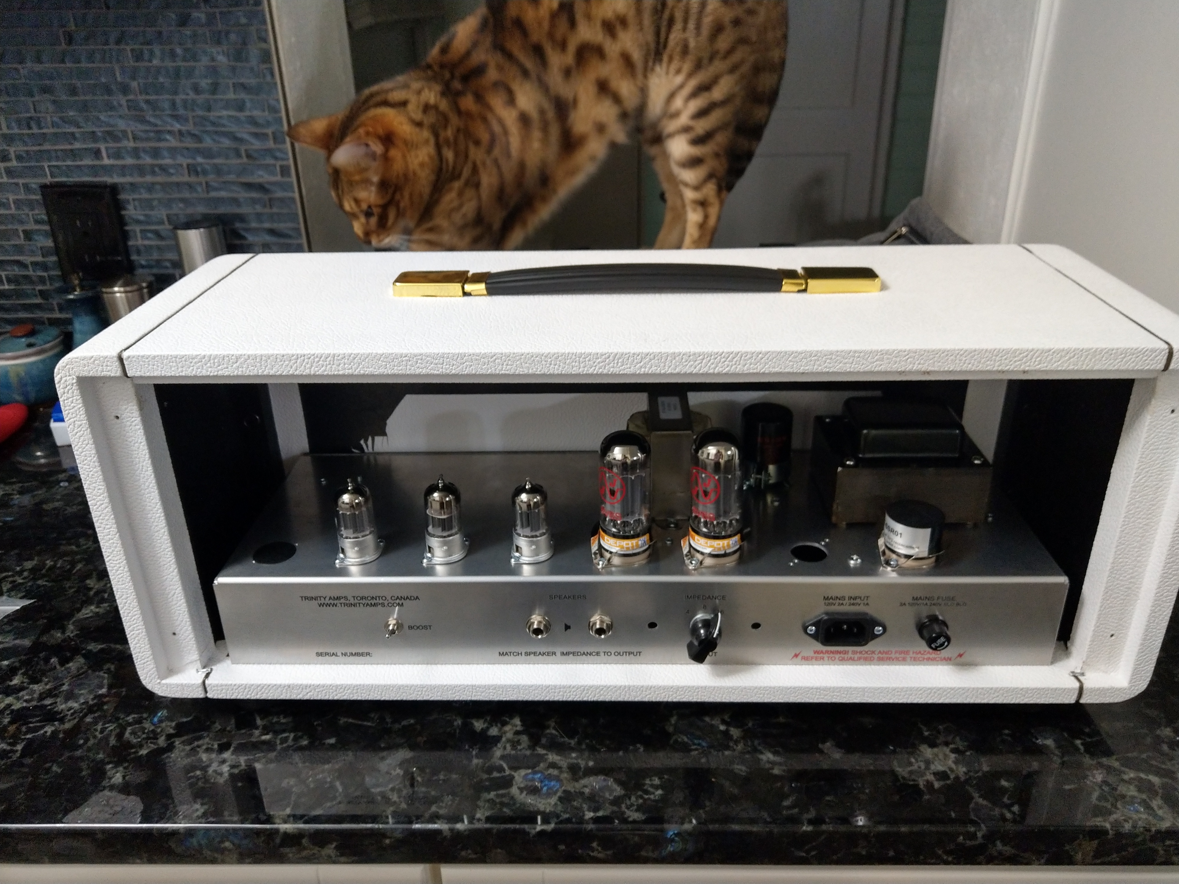

This is a fresh amp that i finished 3 days ago. First the 2 channels worked but after i played the normal channel at loud volume it stopped working. The tmb channel still work fine. Maybe its a solder joint. Where are the places i should check first for problems for this channel?
