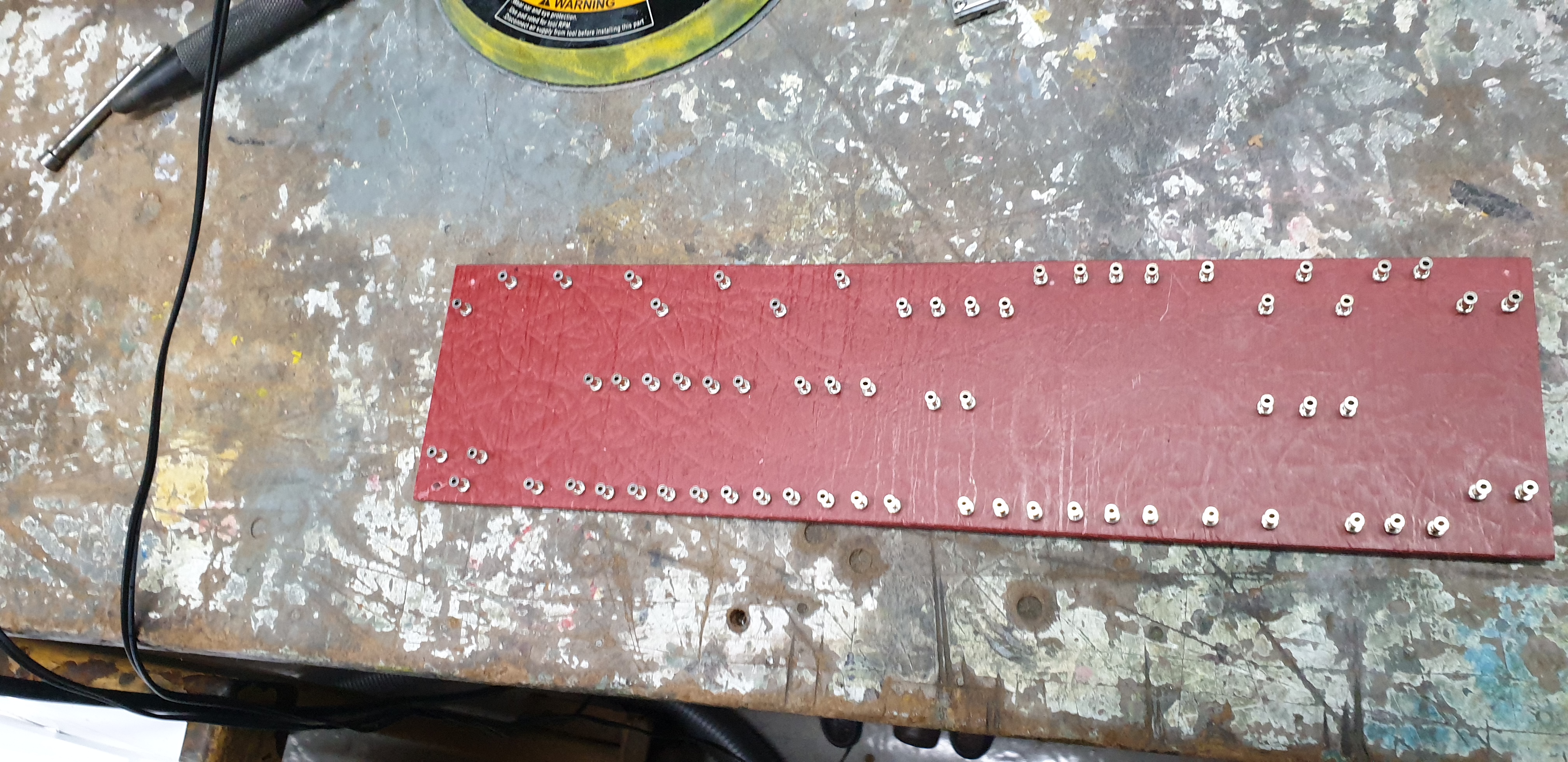

Hi Guys Ive made my turret board but I made a basic mistake. I mucked around and got the image to print the right size for the material (G10 fiberglass 3mm thick) which was 300mm square. Once I manipulated the image to 300x75 mm I stuck it onto the board and drilled it out. The problem is that I made the board too wide and the four resisters that go all the way across the board. I could just use two smaller value resistors in series or extend the legs or add extra turrets or I could slice one side off the turret board and re-drill the holes closer in. Any suggestions of which way would be the best solution.
How can I post photos
 Post subject: Re: New Build sIII
PostPosted: Tue Aug 06, 2019 1:29 pm
I would probably cut the board and redrill the holes closer in. Or add extra turrets spaced for the resistors. Hard to say without seeing it, though.

Best is to reinstall just those turrets. Dont add wire to the components, it adds another point of possible failure.

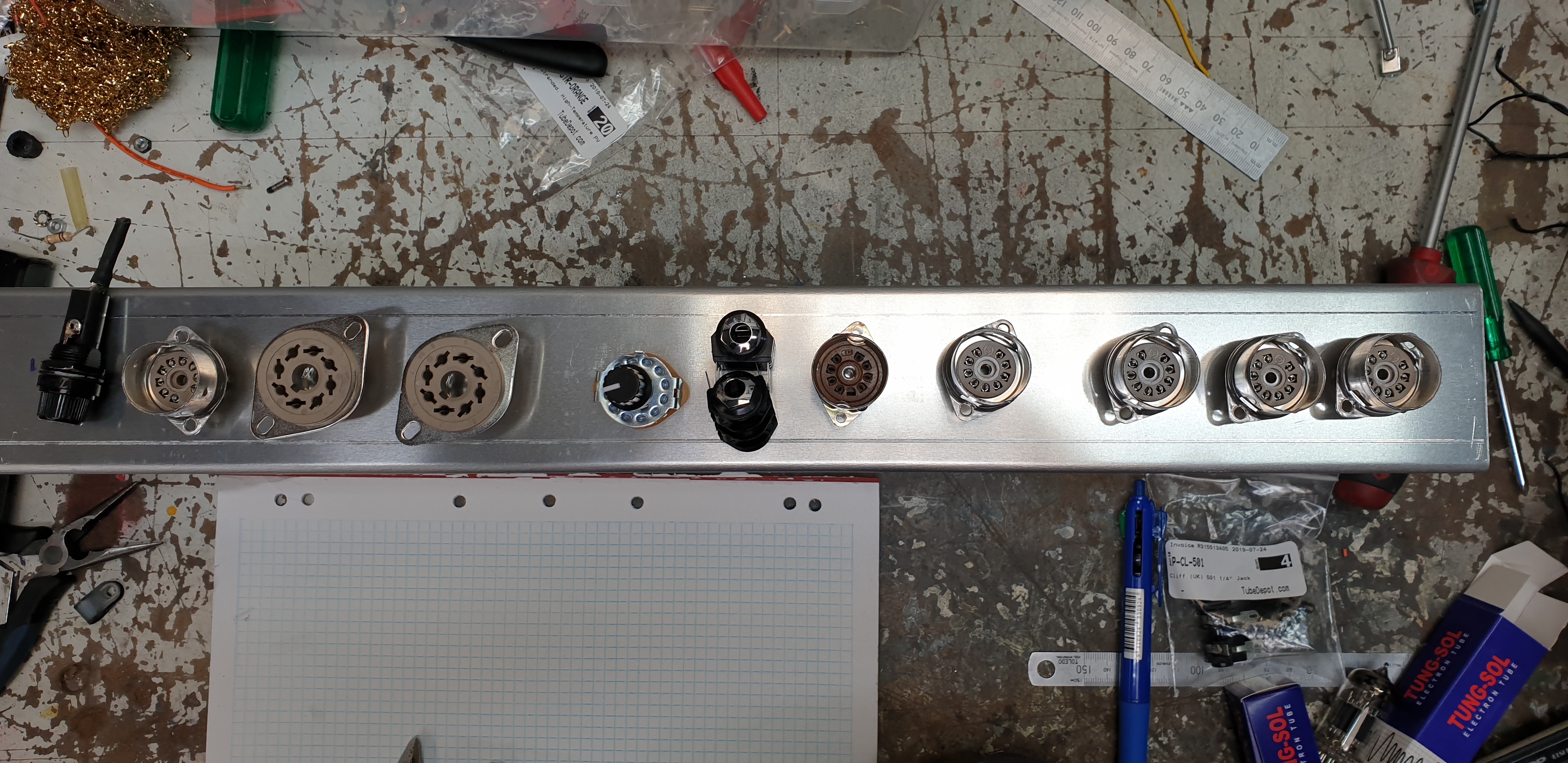

Another question that's probably been asked a million times before. How much space should be between tubes Im building the Trinity sIII V6 version in a combo which has 3X 12ax7,s 2X EL 84,s 2X 6v6 and an EZ81
The other things to fit is power lead, fuse, speaker plug and impedance switch. I have about 460mm to squeeze it into about 18.25 inches
It is going to be tight with about 16mm between the smaller tubes and about 25 between the 6v6,s. so I,m wondering if I should put the speaker jacks and or the power cable on the inside face instead or should I just put them all on the face Ive got and hope for the best?
I solved my turret board problem by adding additional turrets on the ground bus and dog-legging the bus

The layout looks OK. It would be best to give the output tubes as much space as you can, though. It helps with heat dissipation and makes the wiring easier. Heat dissipation isn't the greatest, anyway, when the tubes are mounted upside down.
