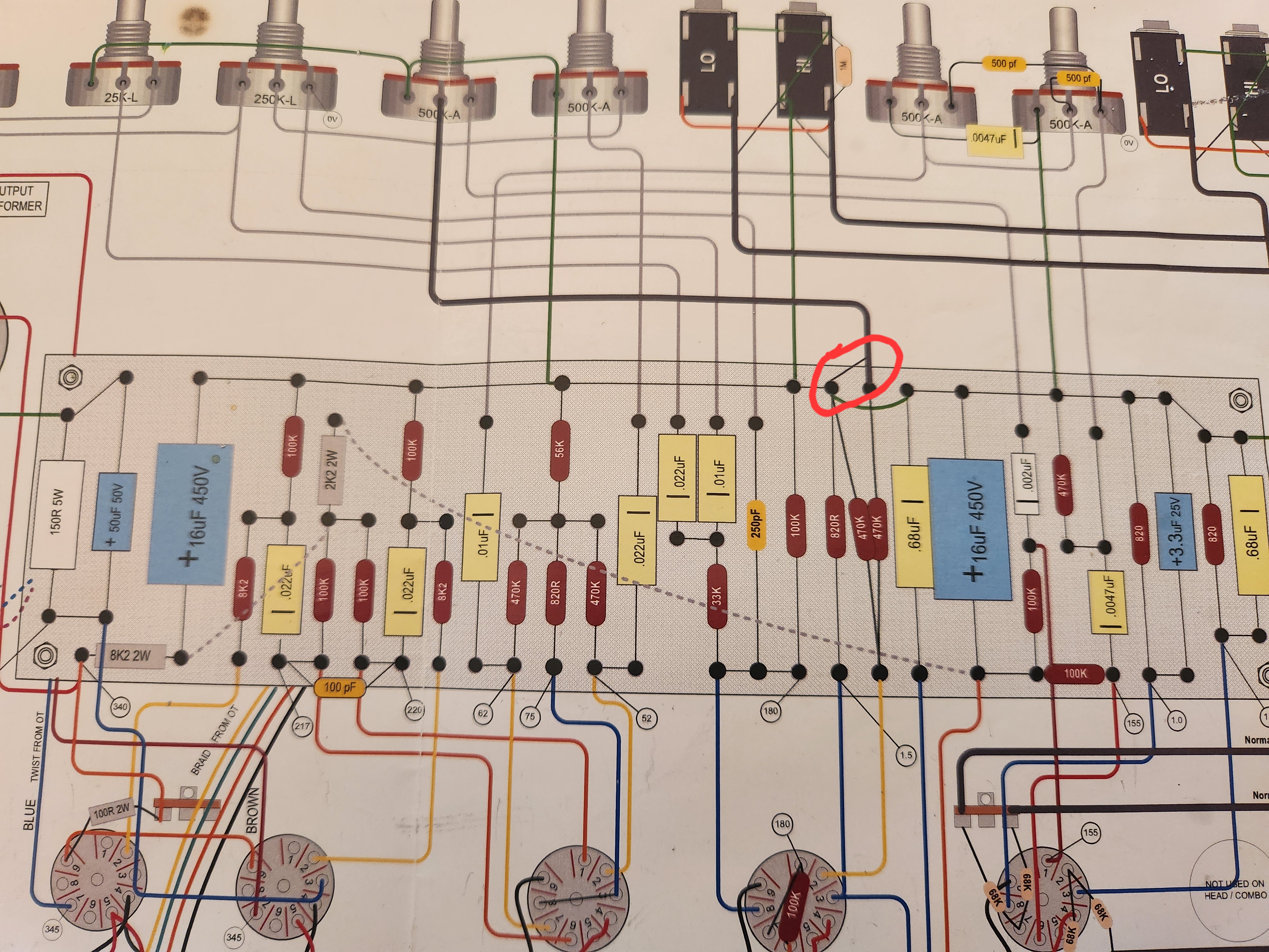

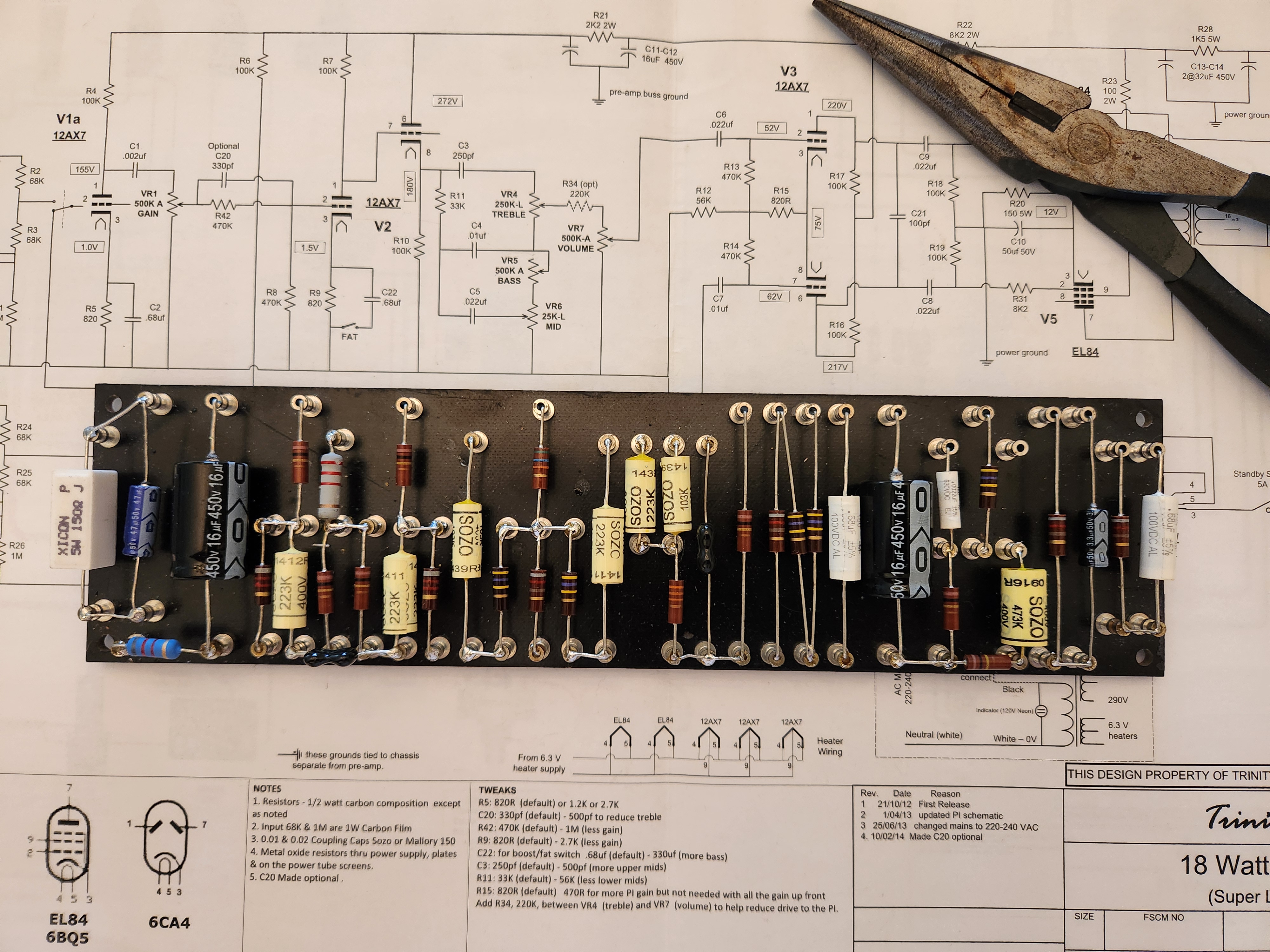

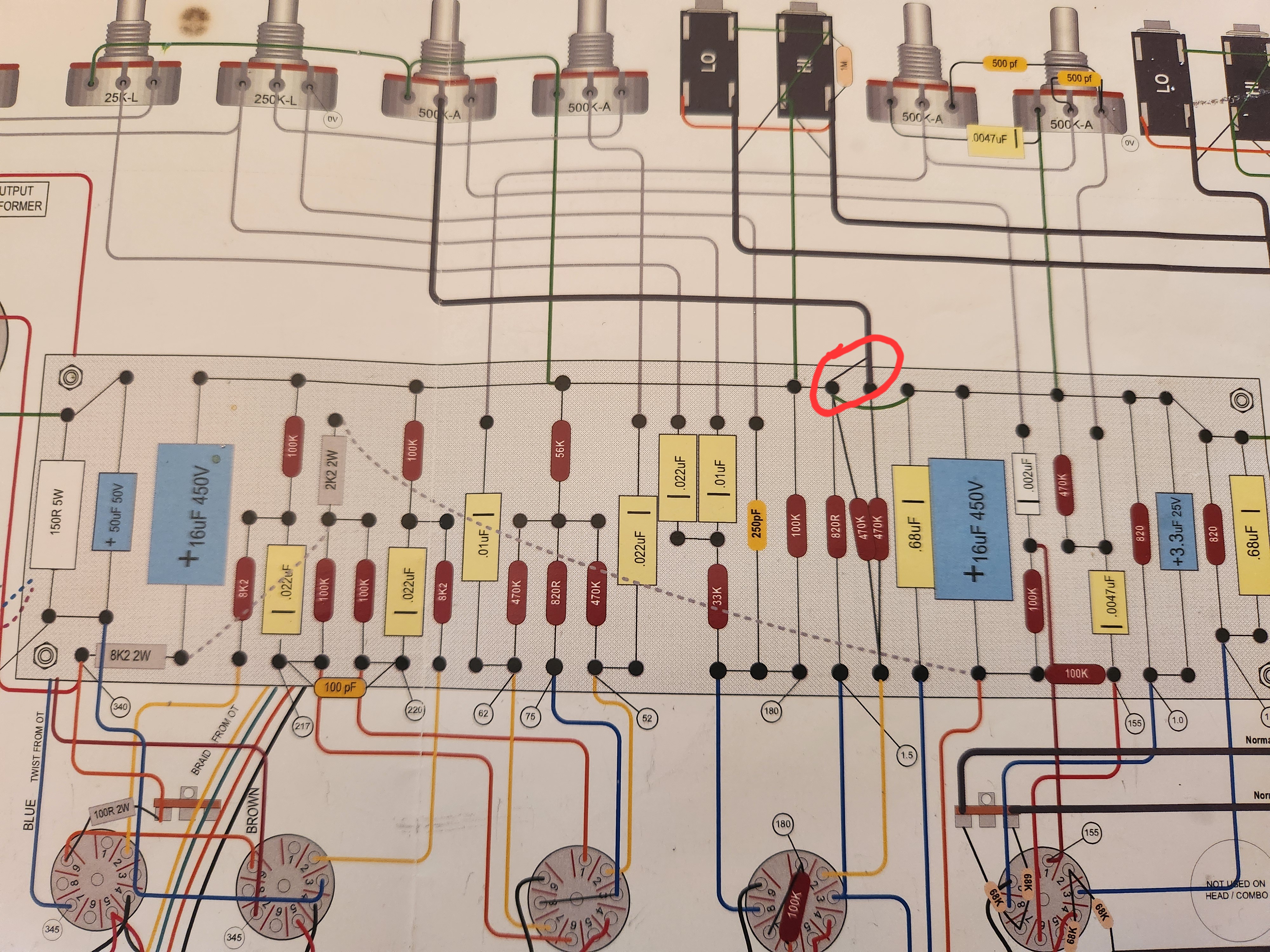

Had some "life" come up, and after a 7 year break, I'm picking my project back up. I decided to pick-up with the board. I have populated it and am running my bus wire on the top across the turrets. There is what looks like a jumper going from the turret to a wire that leads to the gain pot. (See pic, circled in red) I'm not sure what to do with it.
