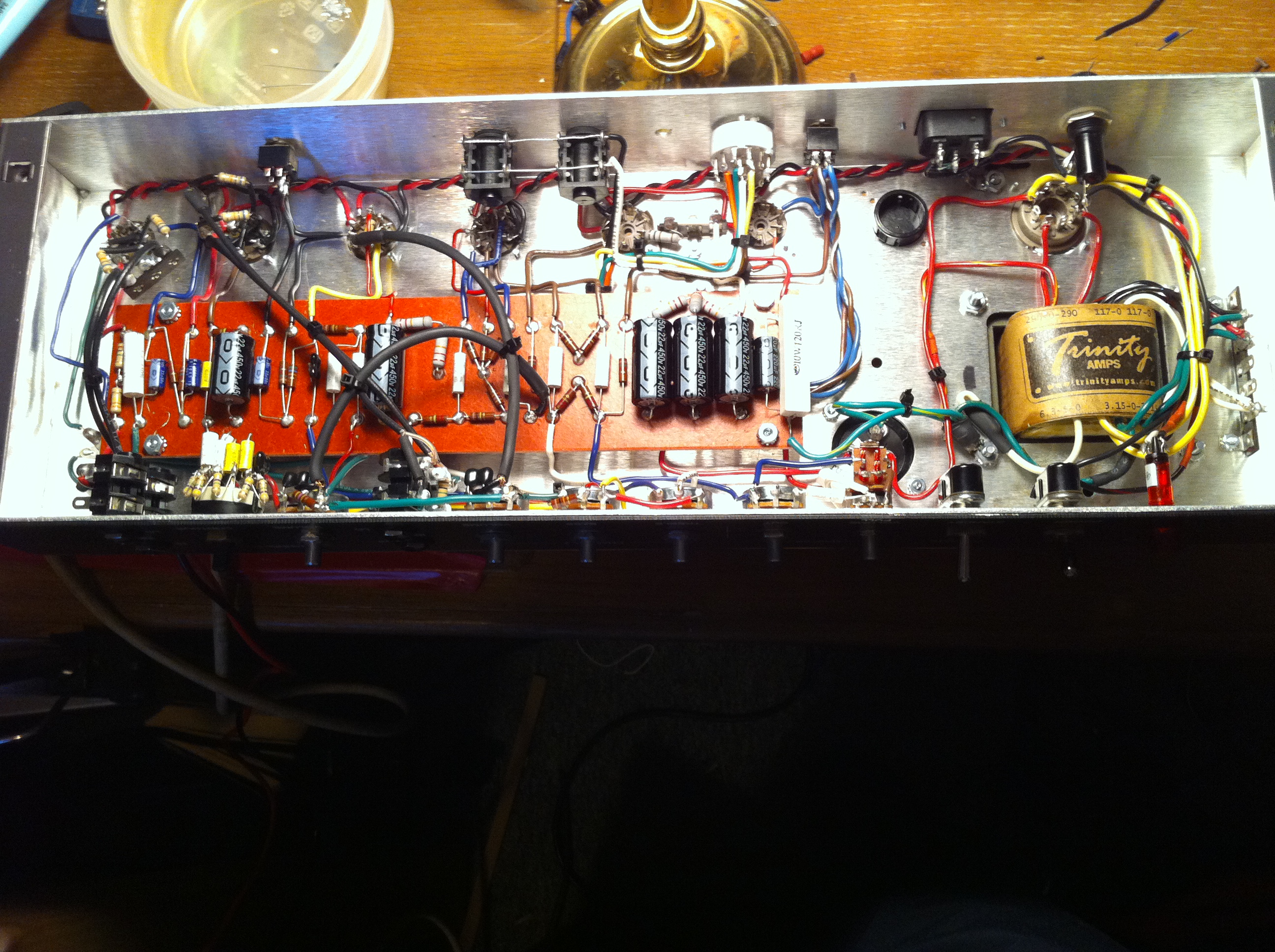

Here is the finished amp in it's cab I got from Trinity. Like usually a very nicely built cab with a solid tolex job (tolexing isn't easy!). The reverb tank barely fit, you can see how tight it is around the OT. It fit by mili meters.
 Post subject: Re: New TC-15 is Born
PostPosted: Tue Sep 07, 2010 5:54 pm
Incredibly there was no extra noise from the proximity of all that gear inside that head. A sweet reverb addition indeed! Nice job!

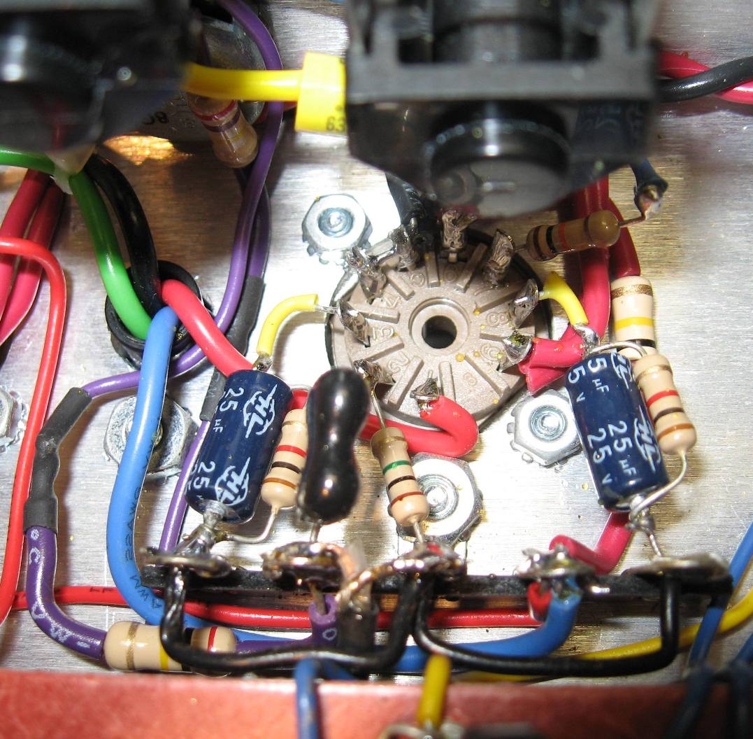

Close up of wiring to reverb tube socket.

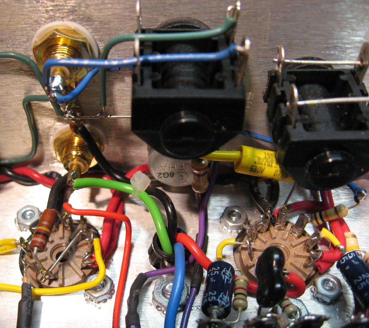

Close up of wiring to Tank In/Out jacks.
