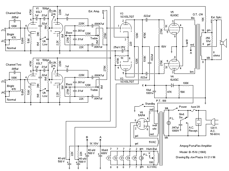

B-15-N 1968

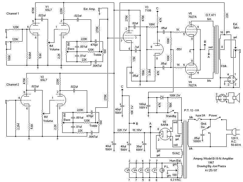

... and then there was a B18-N ...

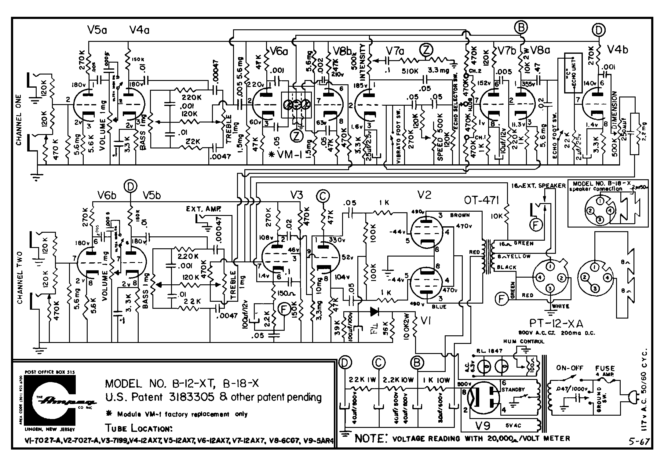

B1-18-X
