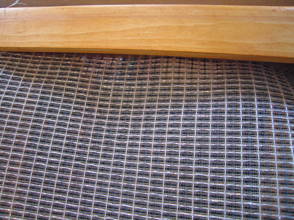

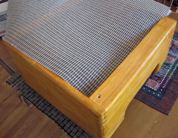

Here are a few pics of the aged blue white silver grill cloth I have just received. I put it next to my cabinet to see what it would look like. I have never seen such a cloth color/cabinet color combination, but I like it.

Nice looking job Gotie,
The Silver cloth looks better than I would have thought, TBH :thumbsup:
I still like the "earthy " colors on natural woods, but what is important is that you like this and it represents your vision of how your cab should look. That's what DIY is about.
I am looking forward to seeing the finished cabinet.

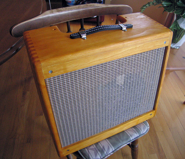

Thank you Casey. Here are two pictures taken today of the finished cabinet, minus the speaker and amplifier.
Edited to say that the grill cloth is a little off horizontal in these pics. This has since been corrected.
