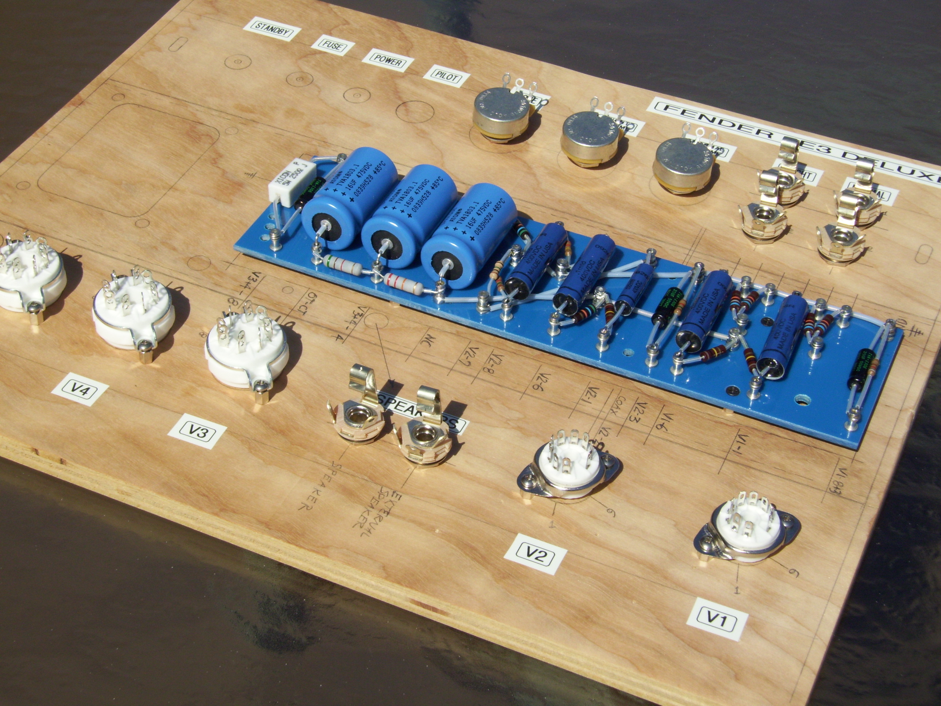

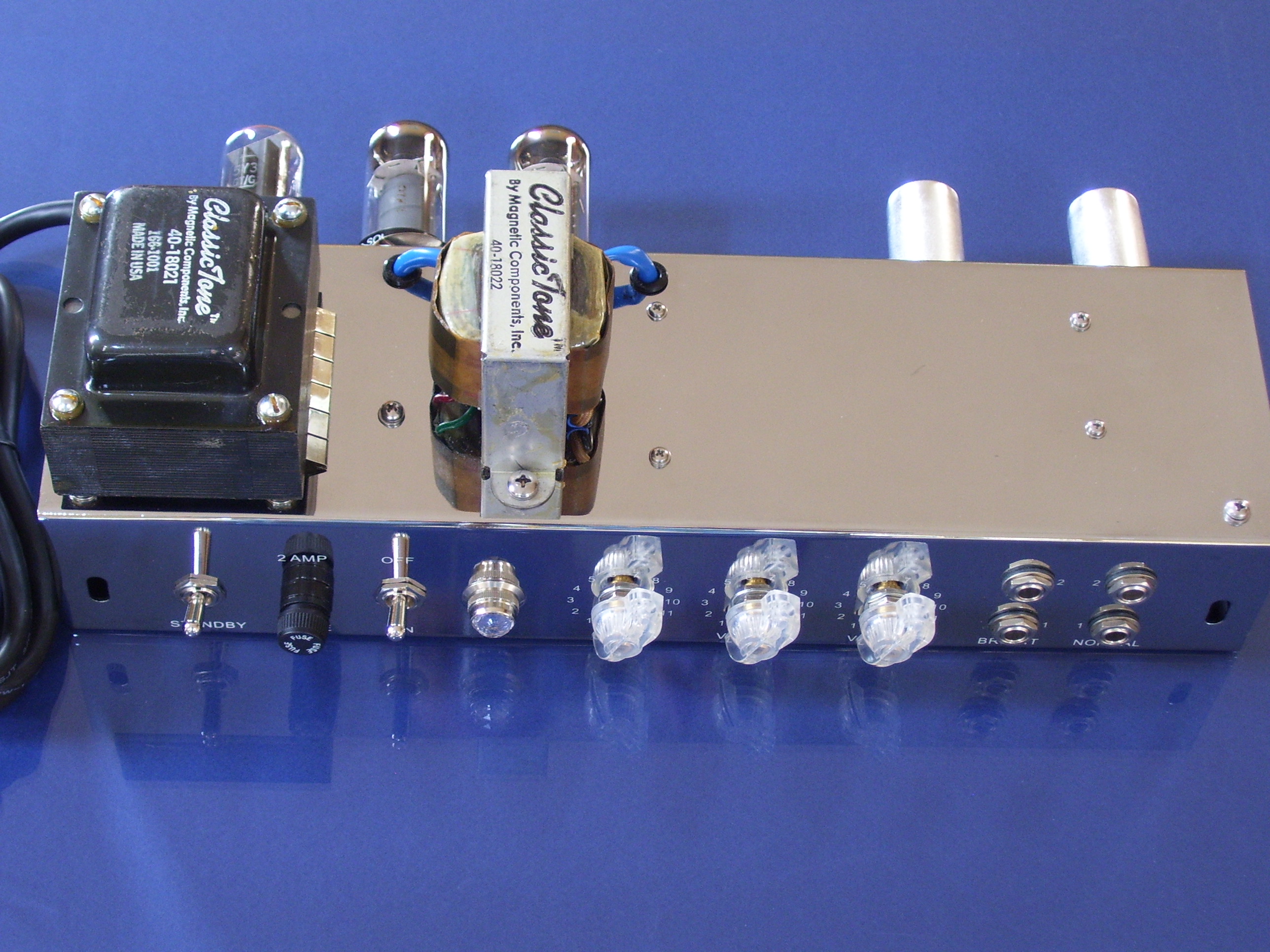

Hey, I started a new project, a 5E3 scratch build!
Hopefully I'll finish this one day :roll:

The board came from Ken Watts at http://www.turretboards.com/
First time I've dealt with them, but Ken seems like a great guy to deal with and this board is just beautiful.

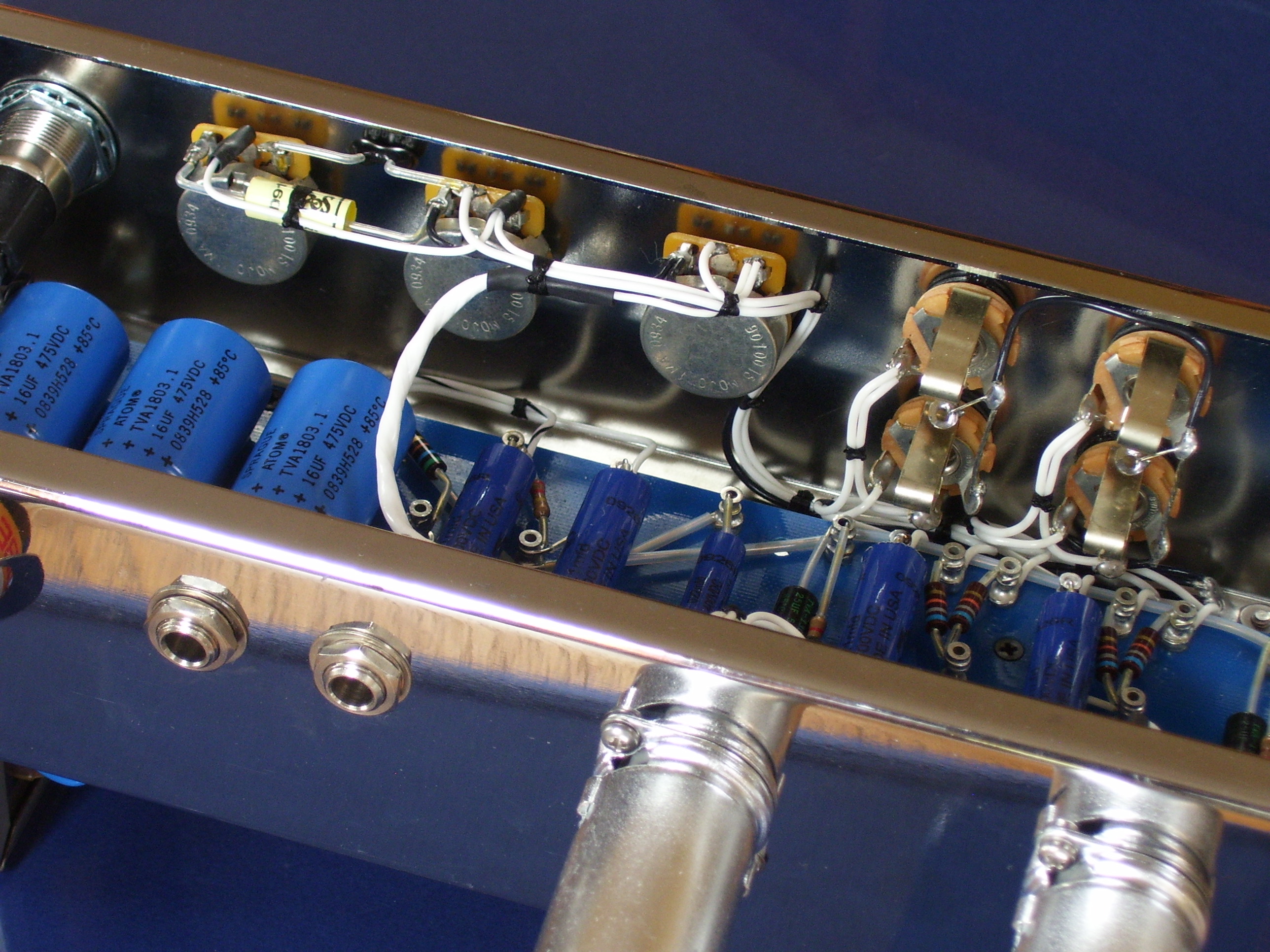

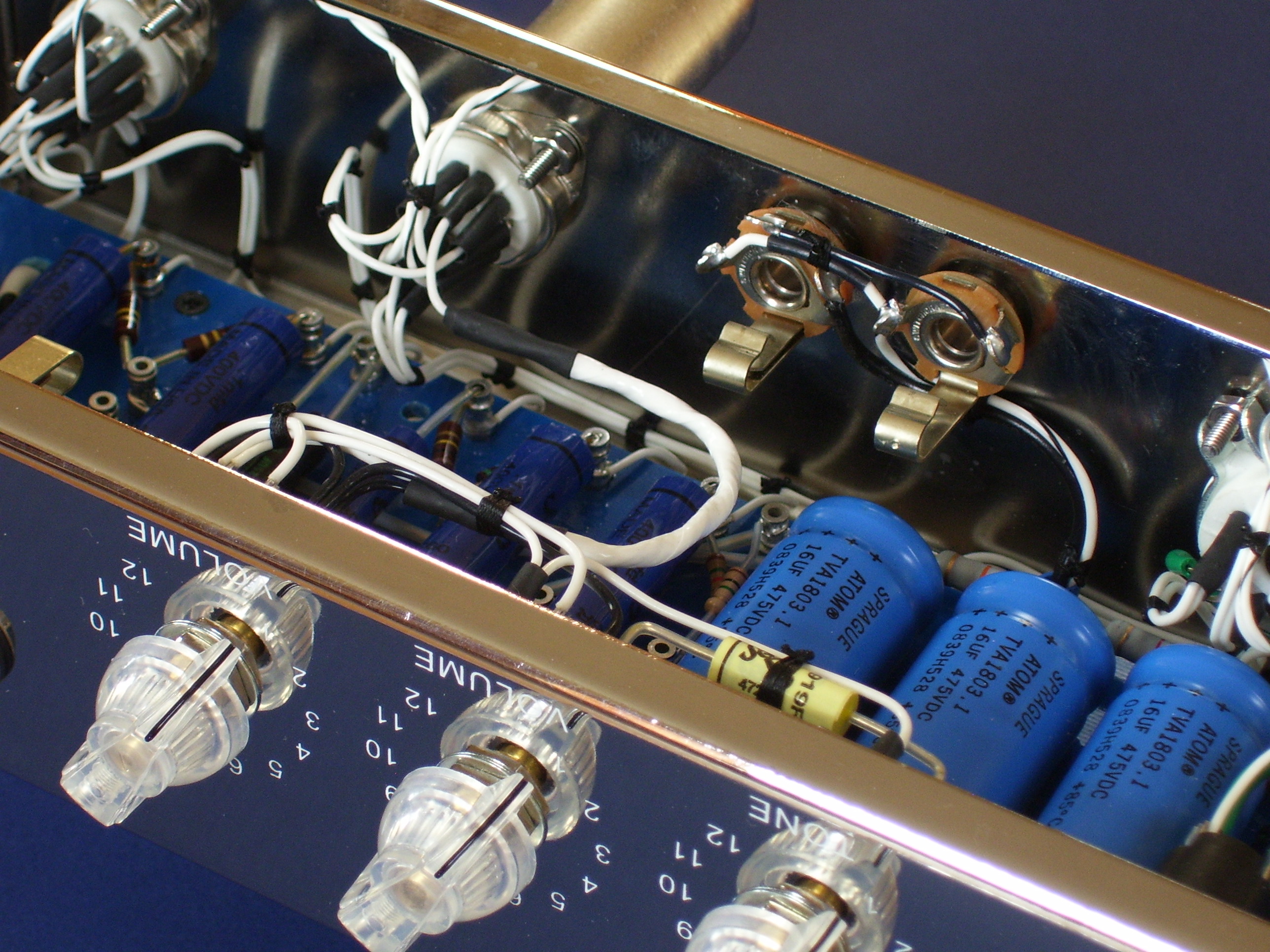

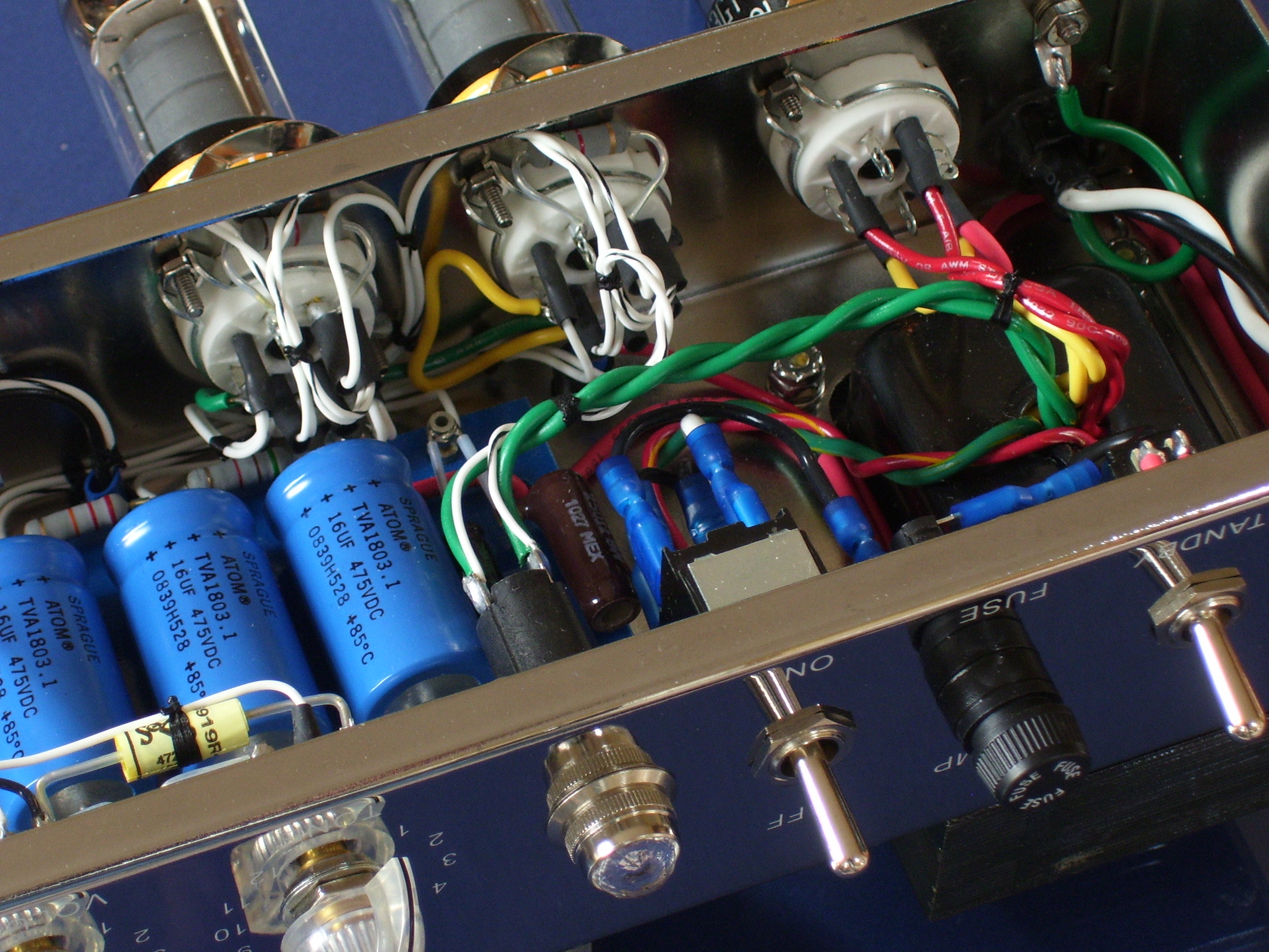

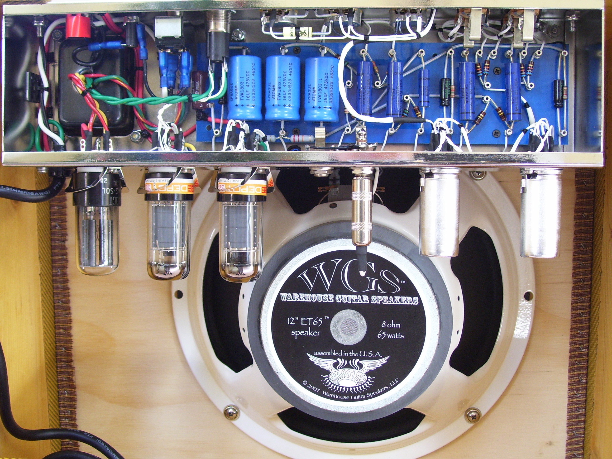

Hey everyone, I finally finished this...!
Joe G

Joe, that is gorgeous work, your usual of course but ours to admire! What are you using to bundle your wires - I don't recognize that material.

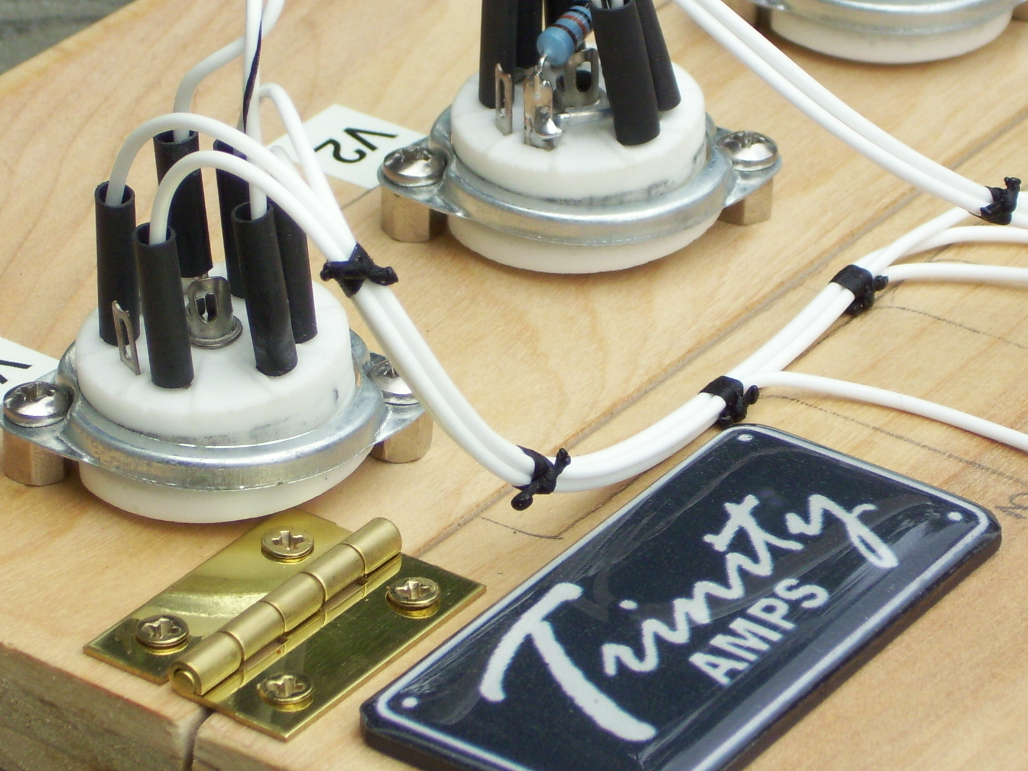

Hey Jim! Here's a link to a description of the lacing cord (or tape) that I used...
https://www.pegasusautoracing.com/produ ... oduct=4041
I like to use individual "NASA knots", but you can do a continuous run stitch as well like in the Hiwatts. After I tie the knots I cut off and cauterize the ends by hovering close to them with 1400F thermal strippers, then seal the knot the same way
You can see it better here...

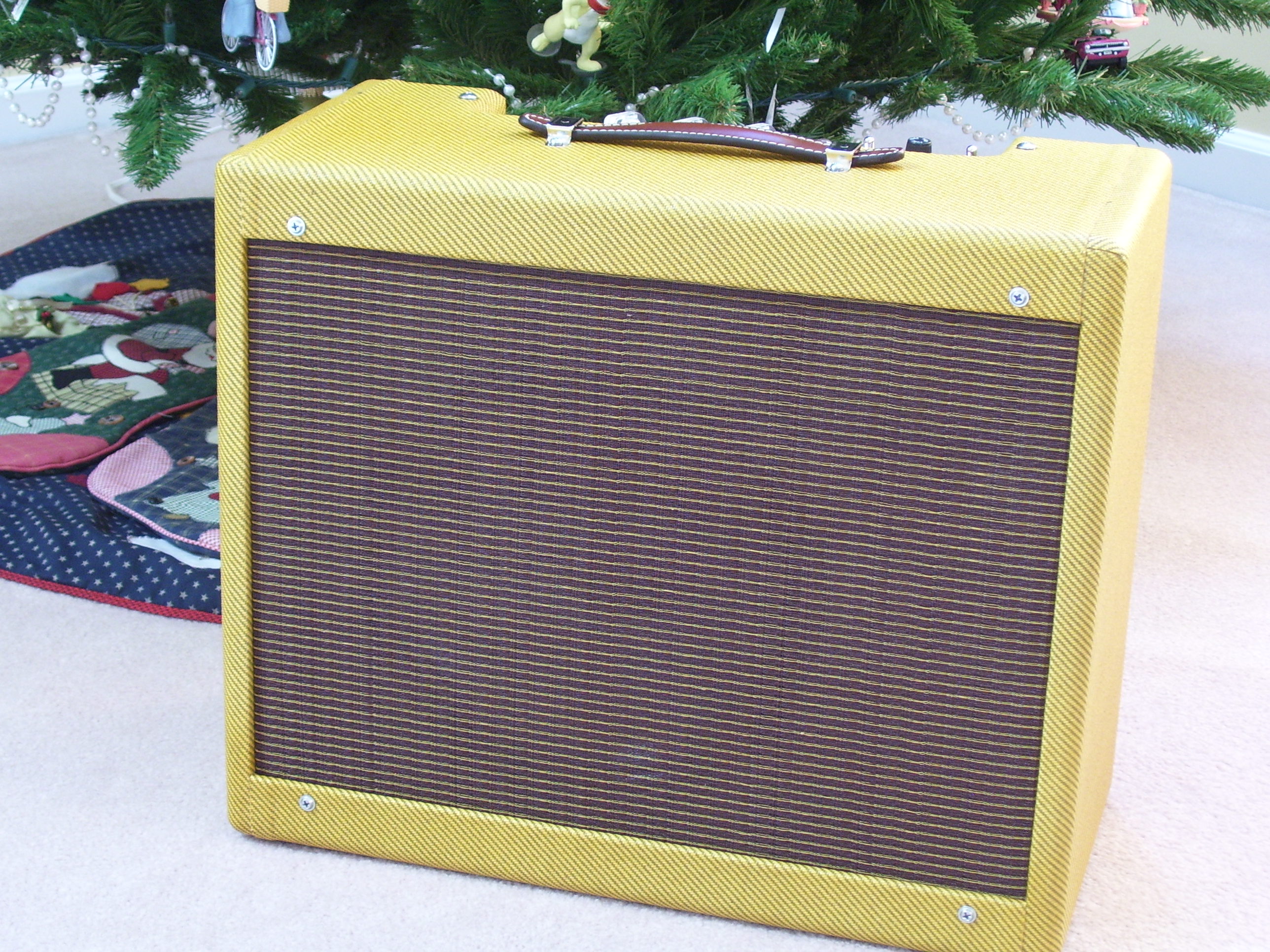

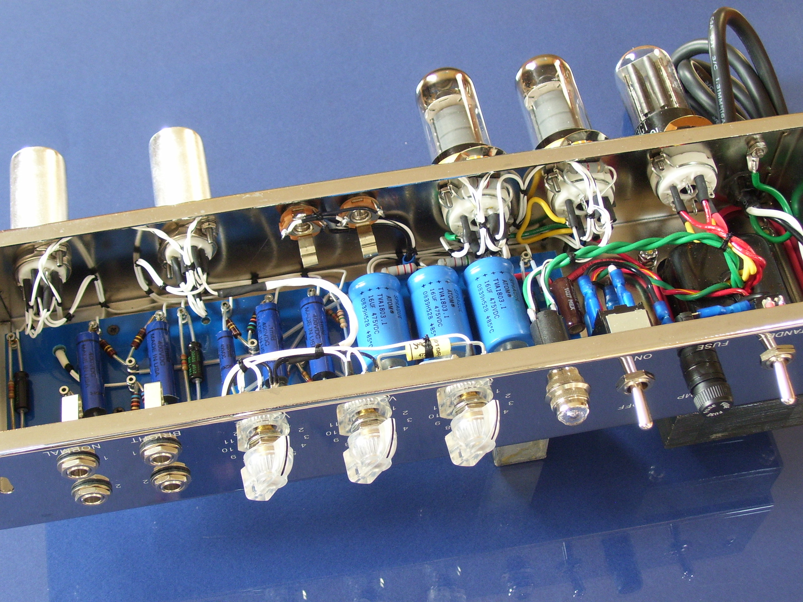

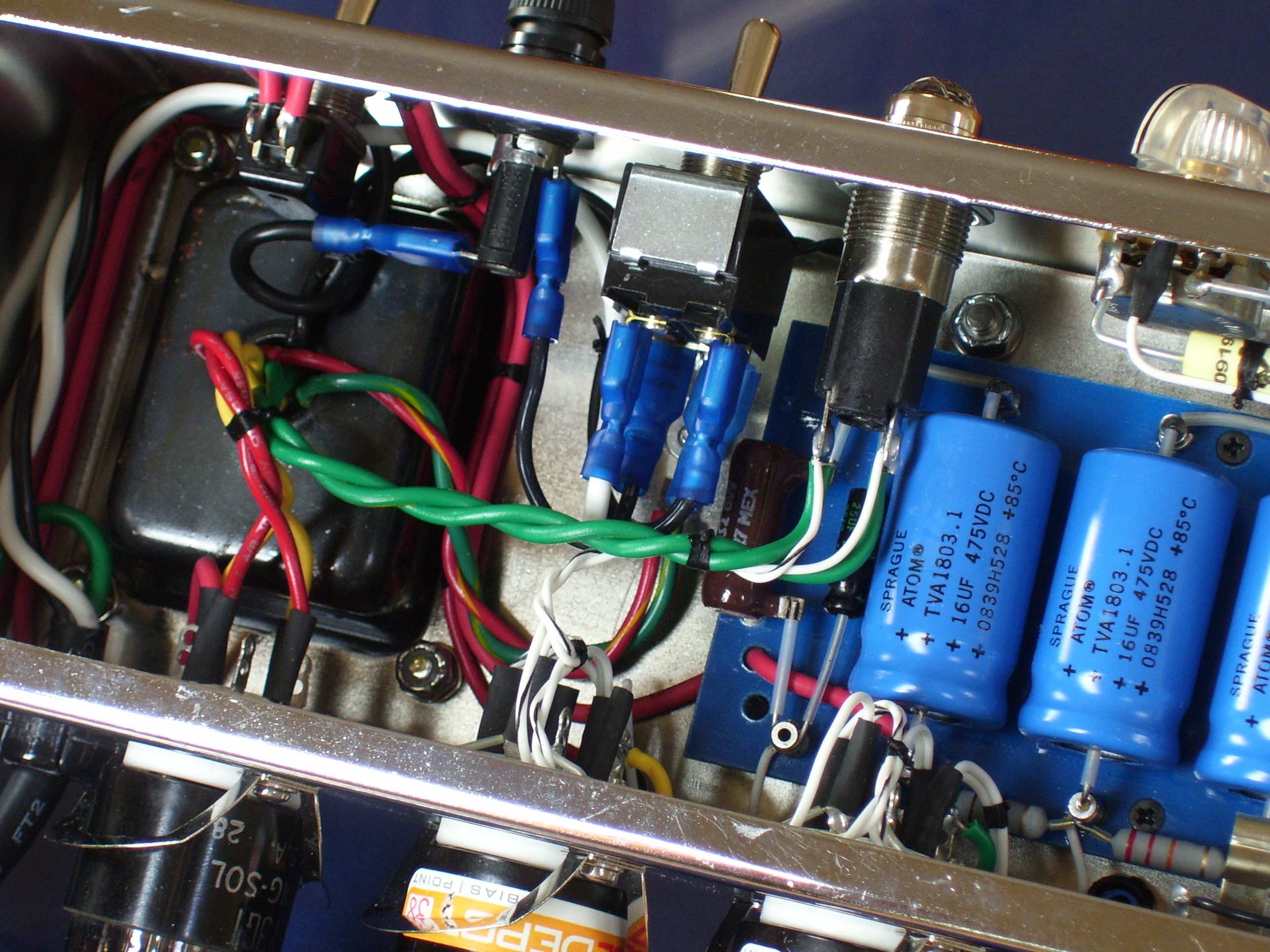

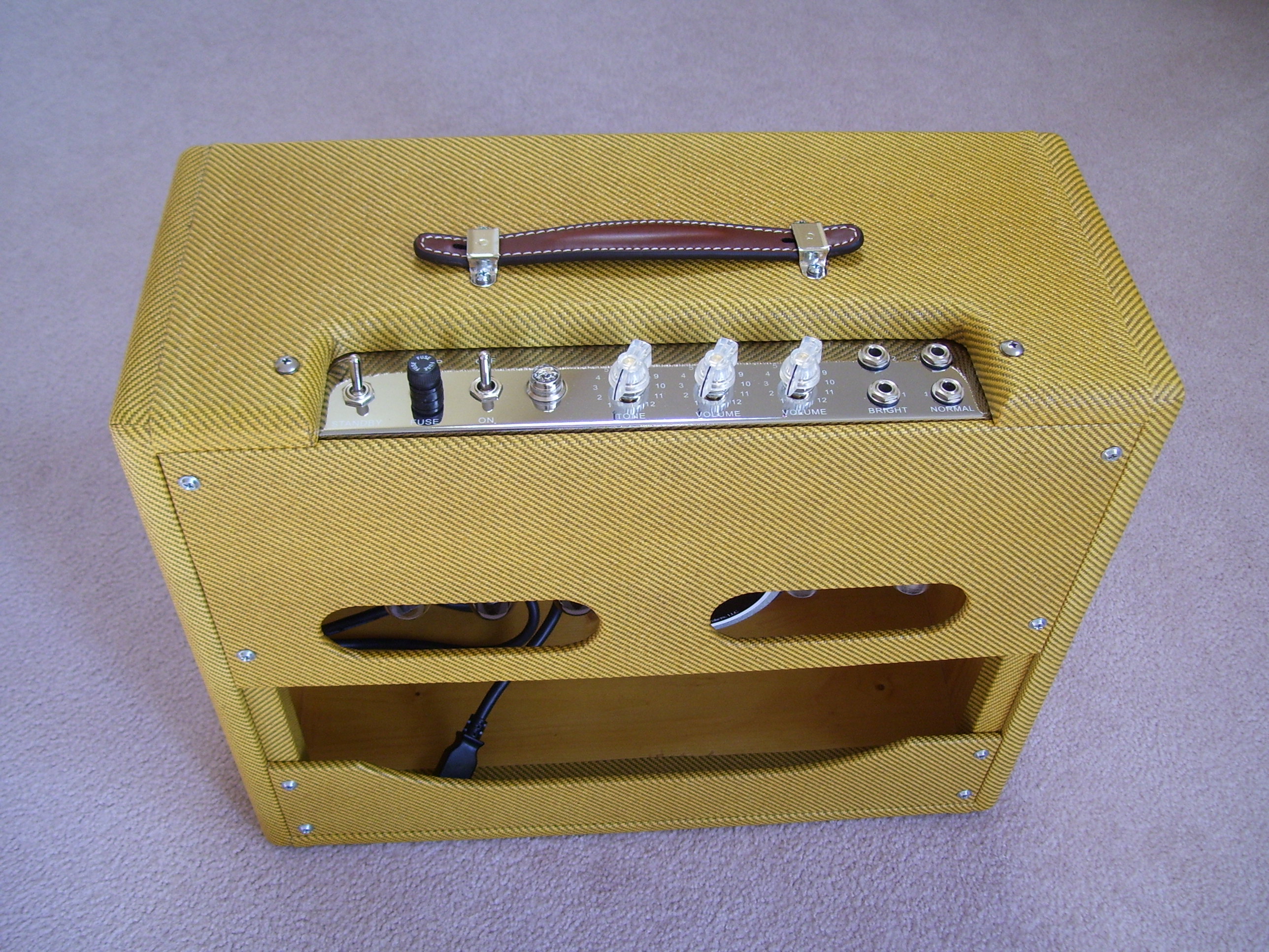

Thanks guys. Got this finished up today and it sounds gorgeous!

...and under the tree it goes!
Thanks Santa!!
