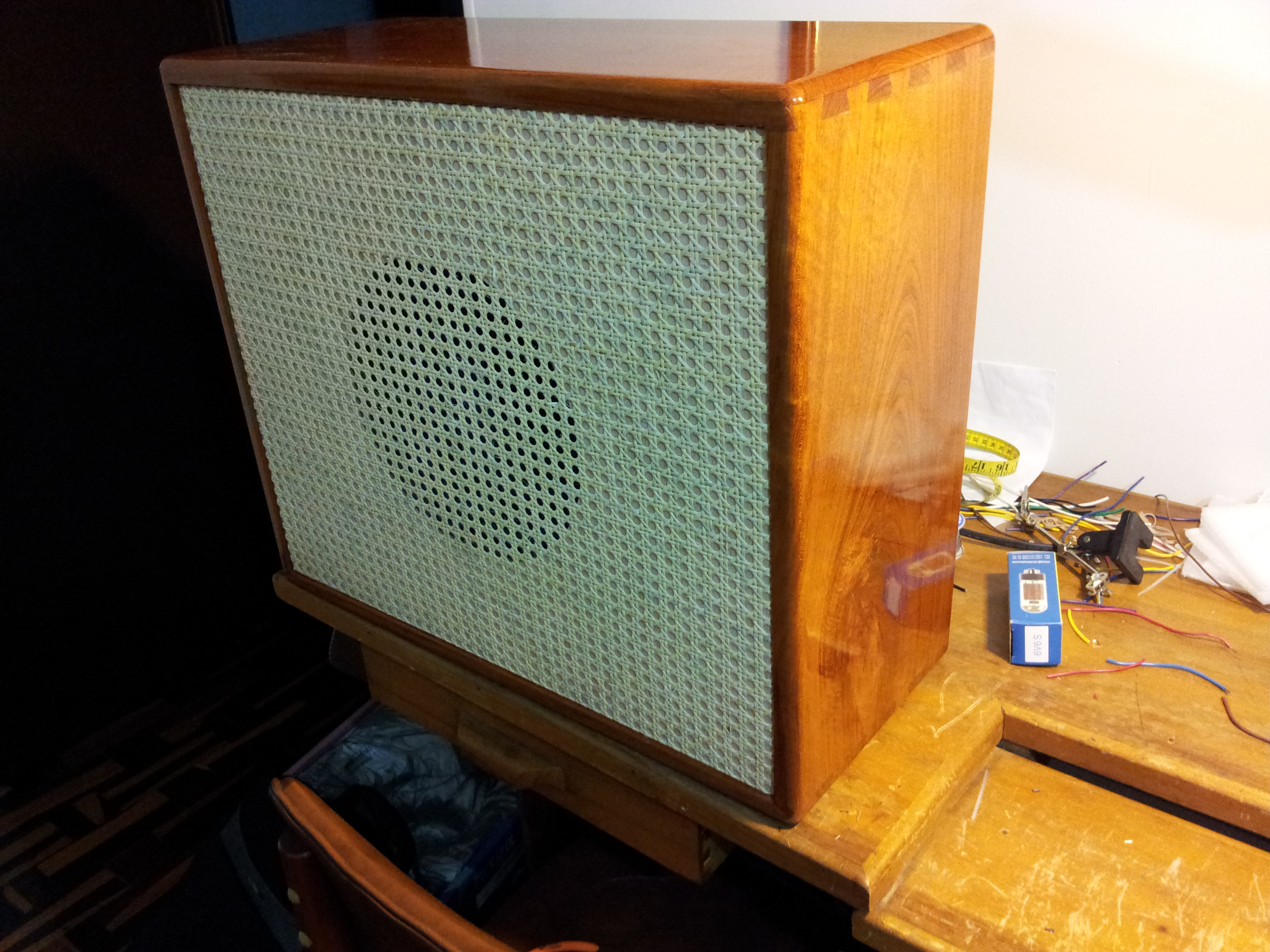

What do you think about the cabin? Its 100% Colombian Granadillo, a South American Type of Rosewood, completely handmade with dovetail joints.

Also, that cabinet looks amazing.

I agree with Cups, that cabinet is amazing.
