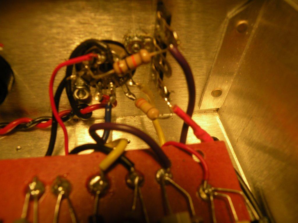

First I used the four screws and four standoffs (picture below) and attached the eyelet board to the chassis. This was a two person job. My wife has smaller hands and she was able to hold the standoff in the correct place while I placed the screw and screwed it in--four times.
Then I soldered the purple wire from the 22k resistor on the volume pot to the 8 ohm (green) wire's post on the rotary impedance switch. Picture is below.
Then I soldered the yellow wire from pin 6 on the power tube socket to post 2 on the master volume pot. Picture is below.
Then I soldered the two green ground wires on the preamp side of the eyelet board to their star ground and screwed it into the chassis. Picture is below.
I next set back and breathed a sigh of releif that this part of the project is complete (I hope). I took an overhead picture of the completed chassis (picture below) and one shot down the eyelet board from the perspective of the VRM Mosfet (picture below) and could not resist one last picture from above the chassis (picture below).
