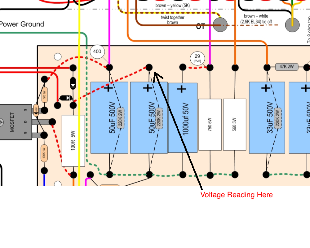

As I mentioned in another thread, the mains voltage in my house is a bit high (Just now I measured it at 123.8V) resulting in slightly higher voltages in the amp. I've noticed that the voltage on the first filter cap (C13) exceeds its 450V rating depending on where the VRM is set. Here are a few measurements of this voltage that I took at different positions on the VRM dial:
VRM at Idle: 460V
VRM at 5: 456V
VRM at 7: 452V
VRM at 9: 440V
VRM at Max: 431V
This doesn't seem too safe to me, but what do some of you more experienced builders think? Perhaps I'd sleep a bit easier at night if I increased that cap to 500V.
Thanks in advance for any replies!

It's actually not the B+ voltage I'm referring to (correct me if I'm wrong)...the other filter cap connected directly to the rectifier diodes. I've attached a picture to illustrate the location.
My B+ seems to be OK. Here are some readings I took the other night of BOTH the high voltage I'm concerned about and B+. Note that 450 volts wasn't exceeded at this time...I'm guessing because my mains voltage was a bit lower. However, it still sits pretty close to the rated value :? .

Ahh, so it looks like the B+ voltage dumper method should do the trick for me. I'll order a few different values of 5W zener diodes in the 20-30V range to see what works best. Is there any need to heatsink the diode?
PostPosted: Thu Jan 17, 2013 1:34 am
No heat sinking required.A 5w is a good Idea.

The diodes came in today and I ended up using a 28V, 5 watter. It did the trick nicely :). Thanks guys.
