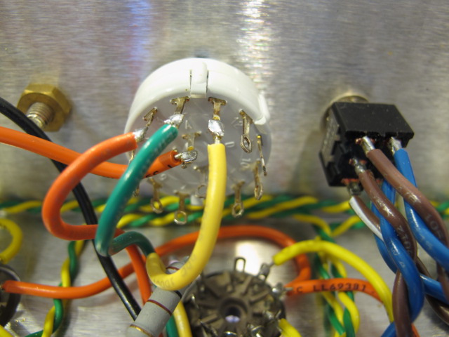

PostPosted: Fri Sep 13, 2013 7:56 pm
Hi korngold,
Here are a couple of pictures of the impedance switch in my TC-15. If you have a two-pole switch this might help with your wiring.
You can tell how many poles (individual sections) the switch has by how many terminals it has near the center of its body. A one-pole switch will just have a lug labeled "A". A two-pole switch will have lugs labeled "A" and "C". A four-pole switch will have lugs labeled "A", "B", "C" and "D". These are the common terminals and will be connected to the numbered terminals near the outer edge of its body depending on the position of its shaft.
It's a bit confusing until you get used to working with rotary switches. This switch style can be anything from a one-pole 12-position to a four-pole three position.
First you have to use the tang washer to limit the switch to three click positions as it says in the manual. I used pole A on the switch, so the lug marked "A" is the common terminal. I wired that lug to the speaker jacks.
I wired the yellow (4 ohm) lead from the output transformer to lug 1 on the switch, the green (8 ohm) lead to lug 2 and the orange (16 ohm) lead to lug 3.
If you have an ohmmeter you can verify that with the shaft fully counter clockwise, lug A has continuity to lug 1. The next click clockwise should connect lug A to lug 2. The next click clockwise should connect lug A to lug 3. This should be as far as you can click the shaft clockwise if you have the tang washer in the proper position.
I hope all this makes sense!

PostPosted: Sun Sep 15, 2013 9:46 pm
Thanks for the help Mitch. There is a section in the Manual on how to set the switch to 3 position in case you need help.

PostPosted: Tue Sep 17, 2013 6:32 pm
Joined: Mon Sep 19, 2011 12:07 am
Posts: 9
Cigarman, Mitch, & Holy Ghost--
Thanks for the help! I found it in my manual (I hadn't read far enough), and your photos really helped me to understand how to wire it up.
