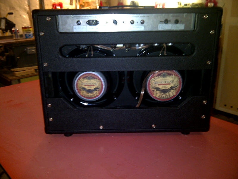

Here it is. Sorry, pictures are sad. Not a super original design but I really wanted a 2x12 combo that I could carry with one hand. Cab is some 3/4" weird 9 ply plywood from 40 year old kitchen cabinets I had but was straight, flat and voidless (I tapped every piece) and has what I think is a nice firm woody sound. Finger jointed and braced so should handle 2 12" speakers and some lugging around.
Still need to put a rear plate of some sort instead of duct tape labelling and am going to put speaker switching inputs etc. but is in the house and working great! Tolex is tricky but doable and learned a lot just by doing it.
Put a WGS Reaper and WGS Green Beret in parallel at 4ohms and they are sounding great together. Should get even better as they break in. They compliment each other nicely across all the different tones and one doesn't really outperform the other.
Cab dimentions 27"w x 19.5"h x 9"d. (Matchless Lightning 2x12 size I think). Total assembled weight - 51 pounds. Not bad for a tube 2x12 I thought and about as heavy as a full jerry can of gas.
Most importantly it sounds great! It can be pretty loud if you want it to but it doesn't HAVE to be sizzling to get decent sound especially for clean stuff. Playing in my 24x24 garage with 10' ceilings the sound just seems to come from everywhere in a good way. That's why myself I'll take an open back 2x12 any day.
I'm glad I put a switched pot for channel 2 boost on volume pot as I think it would be a pain in back as much as I have been using it. Besides, that's where I put the FX jacks!
I switched the cap on ch. 1 volume but changed it back so amp is pretty much out of the box. I isolated the EF86 mounting a bit with some CAT o-rings I had lying around and so far no rattles, put the FX loops in and put the boost switch on the ch. 2 volume pot and left the rest alone. The amp is fine the way it is as you buy it. I'm quite happy with chosing this amp. I'm actually a more accomplished bass player and with just the Reaper (G12H30 copy) hooked up it makes a good low volume bass practice amp too!
Thanks to Stephen and Trinity amps who were so good to deal with. I hope I did your product justice with my build!
Now for reverb... :hmmm:

I posted the pics before I put the piping and a nice chrome strip on so here's the finished ones for those interested. Better at guitar than photography.
Recommendations - if you don't want to deal with some of the rattle noise - build a head. For real portability build a 1x12 but for me I like the mixmatched 2x12 speakers and combo. It's worth the little extra weight and size to get the full effect and still be one hand-one trip. Jammed with a guy with an AC-30 the other day. Struggled a bit to keep up but that thing was stupid heavy for the difference and I liked the tone on the TC15 better. I think he may have too!
