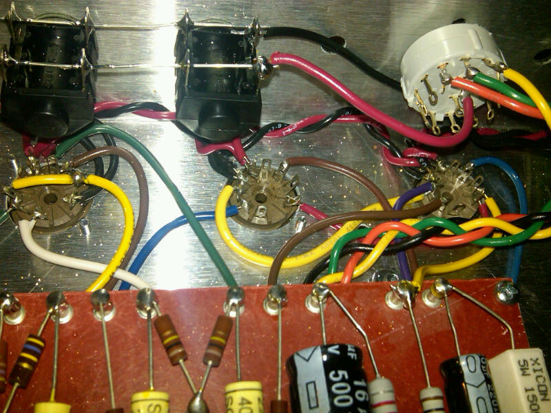

Check your impedance switch wiring
Trying to find a picture of another build
PostPosted: Mon Dec 02, 2013 7:31 pm
eco's and mine looks the same
yours
pretty sure the output wire is hooked to the pin closest to the impedance wires
Switch set for three clicks.
output on a
yellow goes to one
green goes to two
orange goes to three

On sazafraz's note: I hear you, I agree, my impedance main lead out is wired to the tap labeled "C"
(on my switch the other tap is labeled "A")
The image you have and in the Manual shows the tap on the switch closest to the
1,2,3 leads ("A" on my switch) receiving the main OPT out. Can anyone attest to the importance of tap selection A or C
on the impedance switch? The switch is set for three clicks.
HG? (I thought he had already "checked off" on my photo of my impedance switch wiring, but
my suspicions have gone there too.)
PostPosted: Mon Dec 02, 2013 8:06 pm
A and C have no continuity between them so important
As for the wires which numbers did you use to hook up to the switch the ones on the top ( switch side) of bottom (pin side) the do not line up to each other you need to hook up wires to the numbers on the pin side
So you can fix up the switch and see where that lands you

Yeh, sazafraz, you get free beer,
you spotted the problem--(though I was about to try the same fix,
serendipitously--I swear)
the impedance switch tap was mis-wired. (!)
I think the instructions could include a variant of sazafraz's advice: make sure the
tap chosen is the one closest to the impedance-wires, not necessarily the "center"
(or at least not necessarily the one marked "C") tap.
