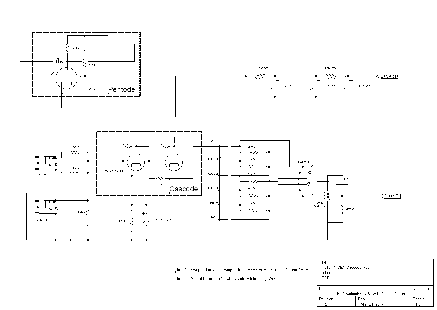

After almost 7 years since I built this amp I have been using it for playing out again and thought I'd pass on my thoughts.
What a great amp. It performs well and still has the magic.
After some years of moving around and storage etc. I found myself an opportunity to play again and out she came.
I did finally open it up to deal with the microphonic channel 1 EF86 and did a simple 12AX7 cascode just to see if I could use channel again and here is a picture of what I did.
It works well enough to replace the issue I had and gave me the functionality I was missing. Tried a few 12ax7's and found the Tung-Sol worked the best for what its worth. I did have to up the resistor value in the VRM to use at lower volumes as it starved the channel for voltage but for playing out I use the bypass switch I installed on the VRM usually anyways and just adjust the Master Volume which, although a little finicky, works well enough.
