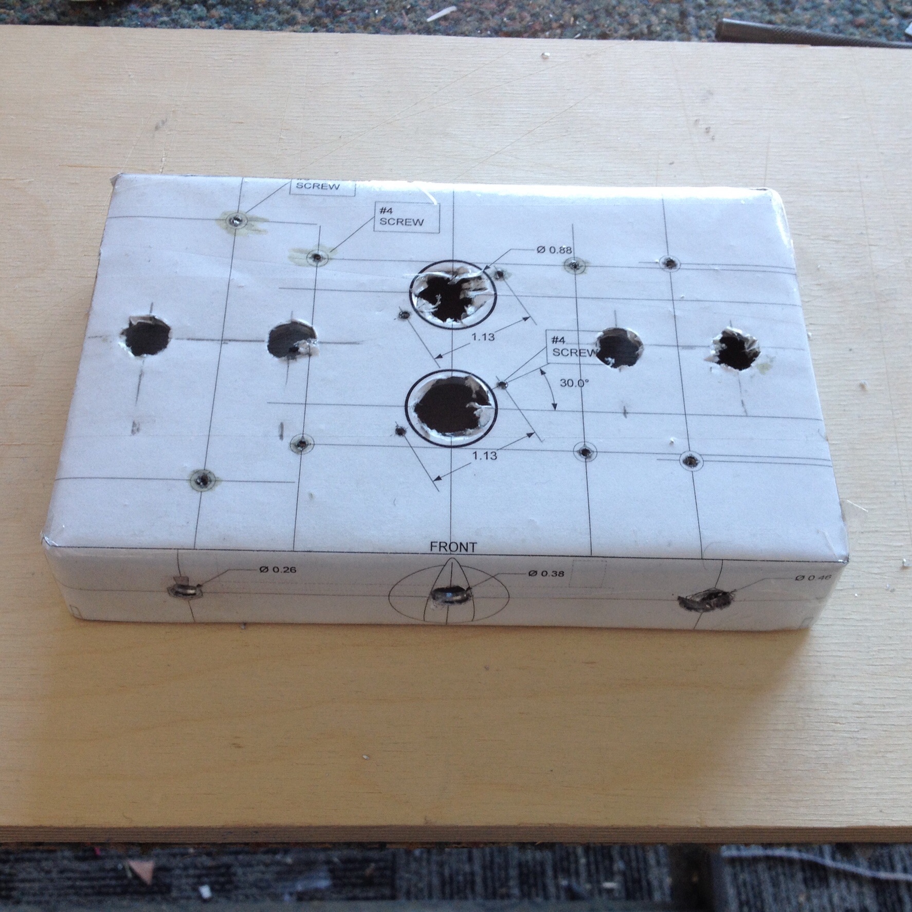

First we do the design on the computer. Then tape the drawings to the enclosure.
Then we drill out all the holes and tap holes where necessary.

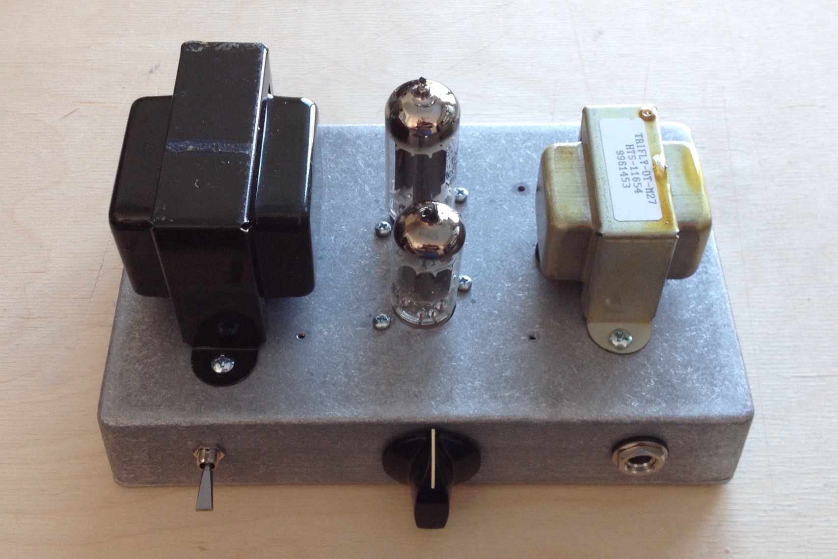

Next step is to fit all the parts to ensure they all will go in physically and then drop in a bare eyelet board and do a final fit.

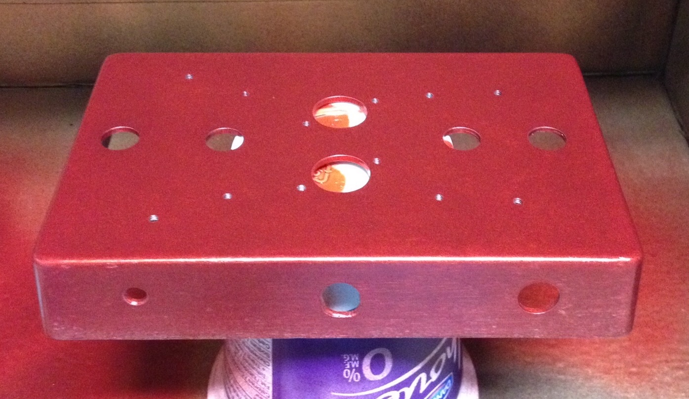

Next step in this build is to go to the paint booth and put a first coat of Red Sparkle paint.
Once that is done, the parts will go back on, the board built and installed and the TriFly tested.

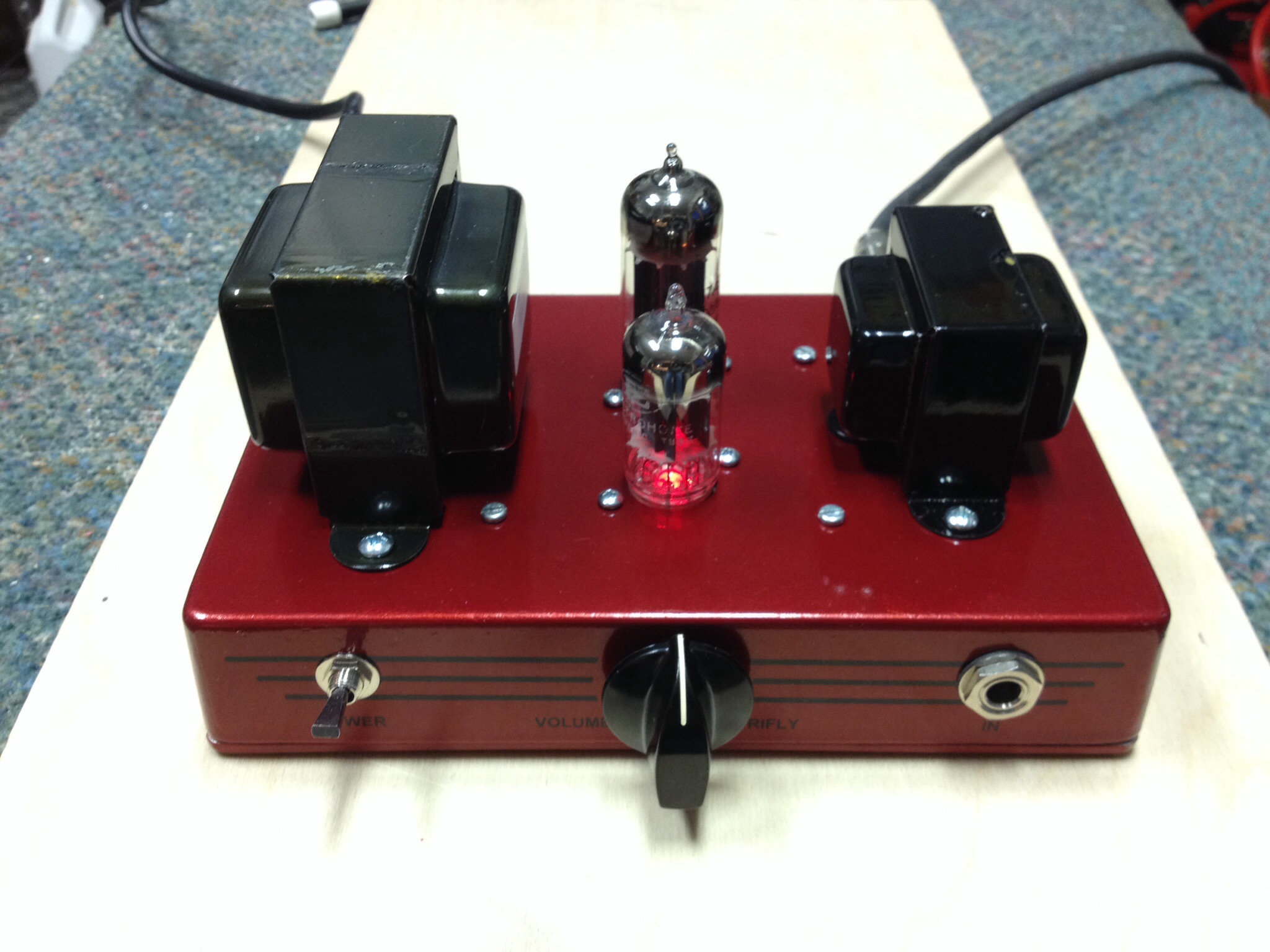

Here's a picture of the Final Prototype. Check out the Indicator Lighting!
