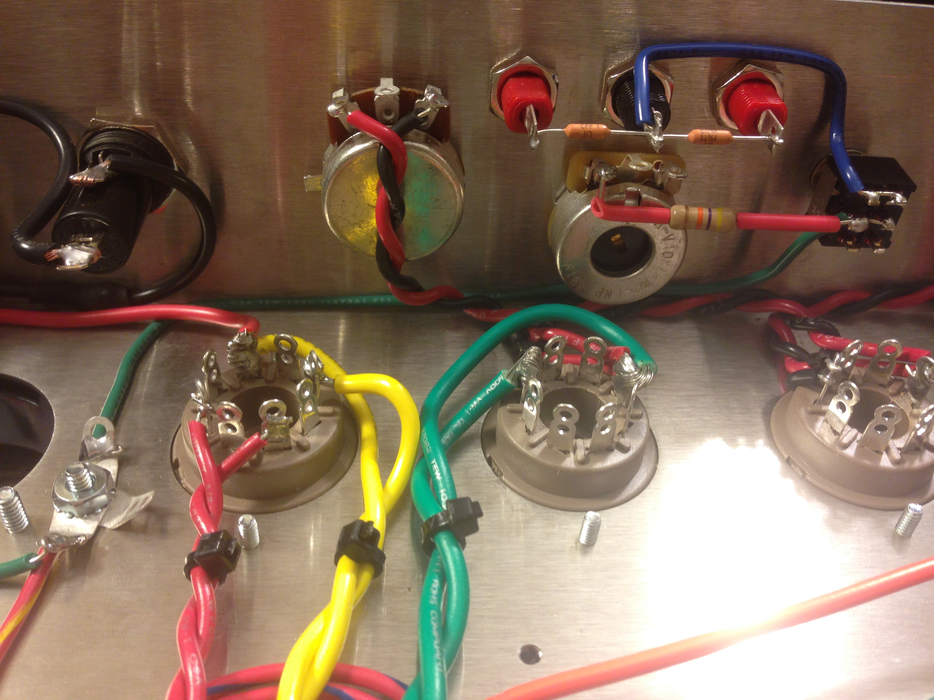

PostPosted: Sat Apr 25, 2015 9:15 am
Day 3 Bias Pot Wired Up

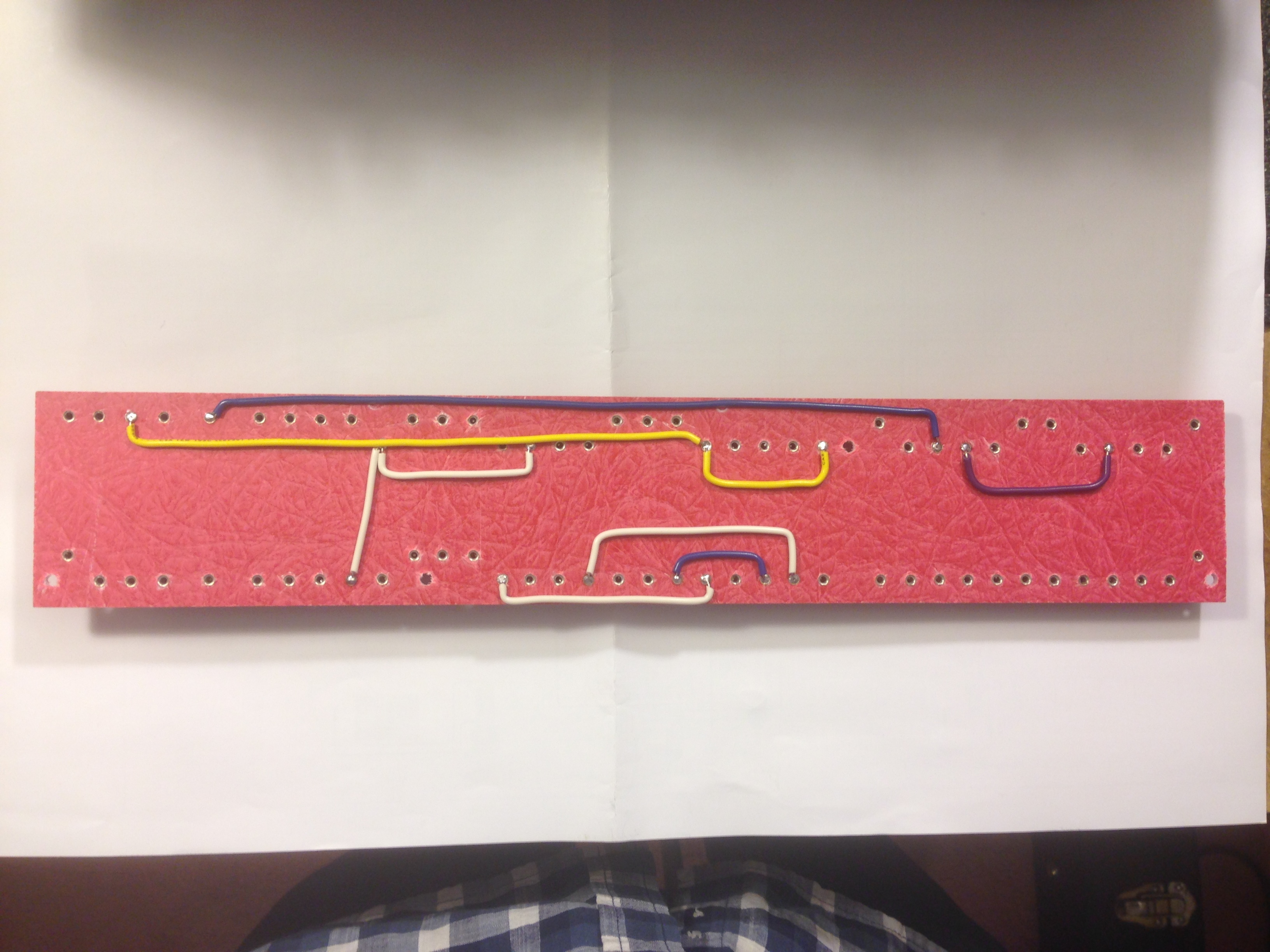

PostPosted: Sat Apr 25, 2015 9:23 am
Day 4 - Turret Board Built and Installed

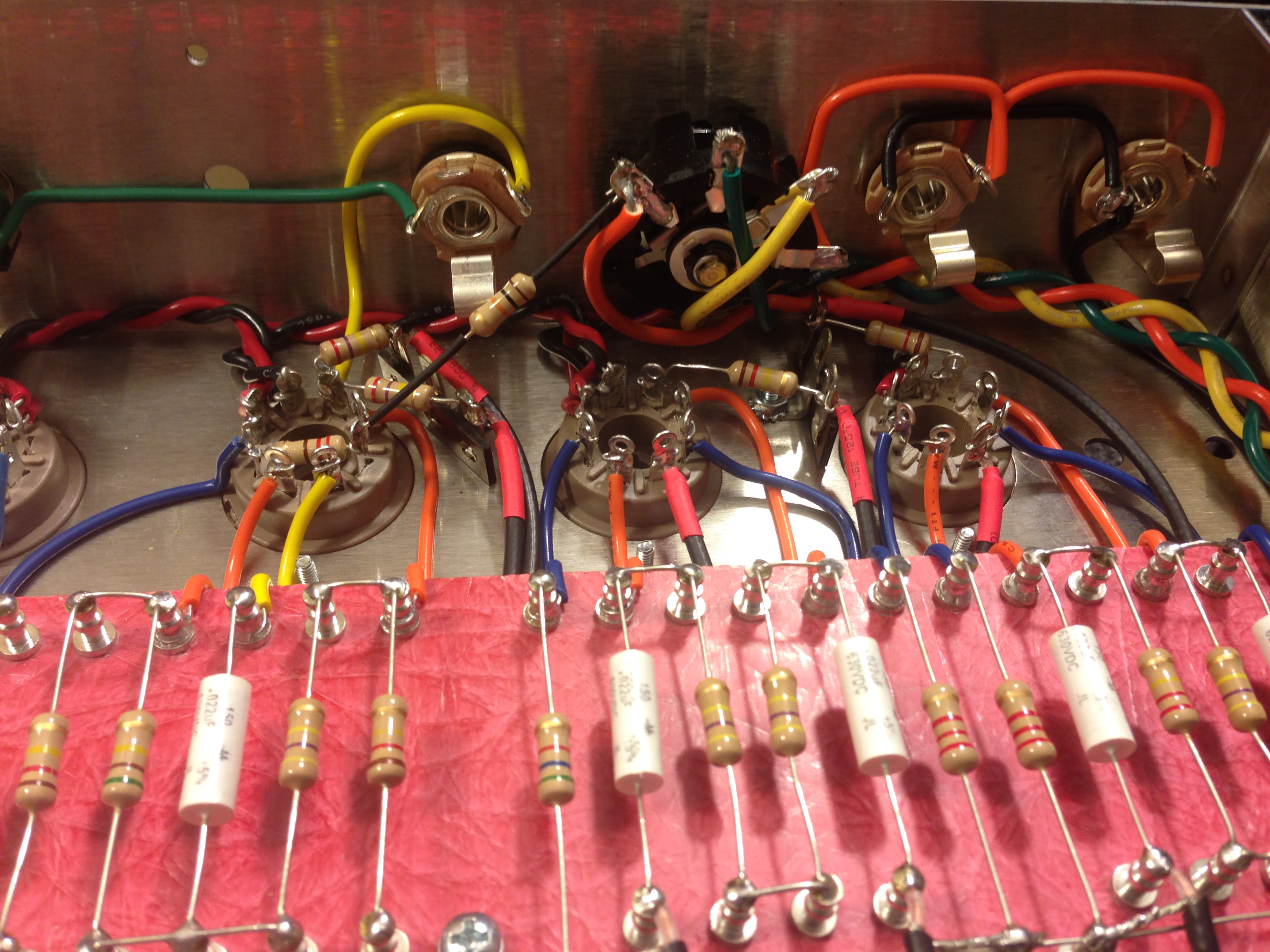

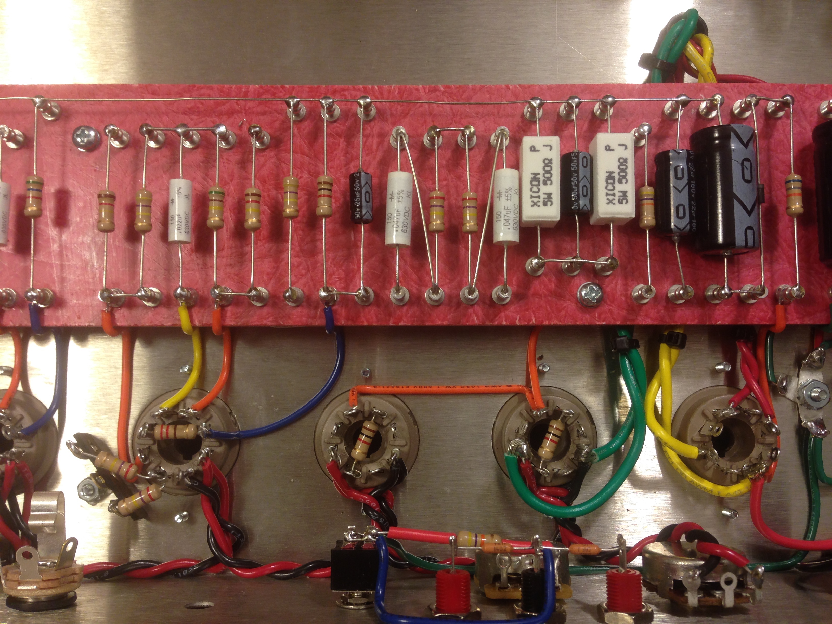

PostPosted: Sat Apr 25, 2015 9:35 am
Day 5 - Tone Boards Built. Grid Resistors Installed on Socket. Note Orientation of Terminal Strips. Bleeder Resistor on Can Cap. Control Bus Bar installed.
Turret Board connected to Sockets.

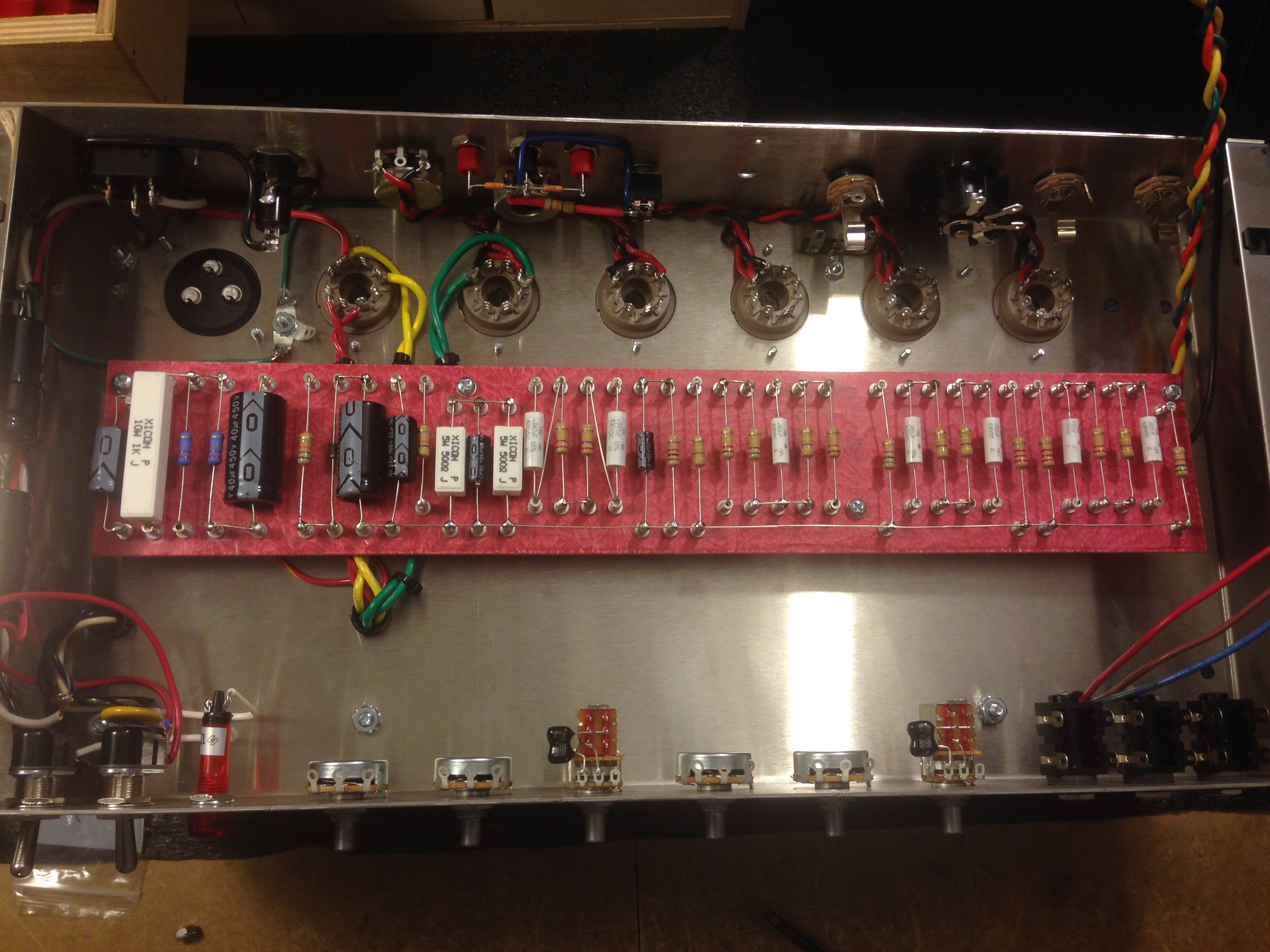

PostPosted: Sat Apr 25, 2015 9:53 am
Day 7 Tone Boards Installed. Input Jacks Built & Installed. Controls Connected with Coaxial / Shielded Cable.

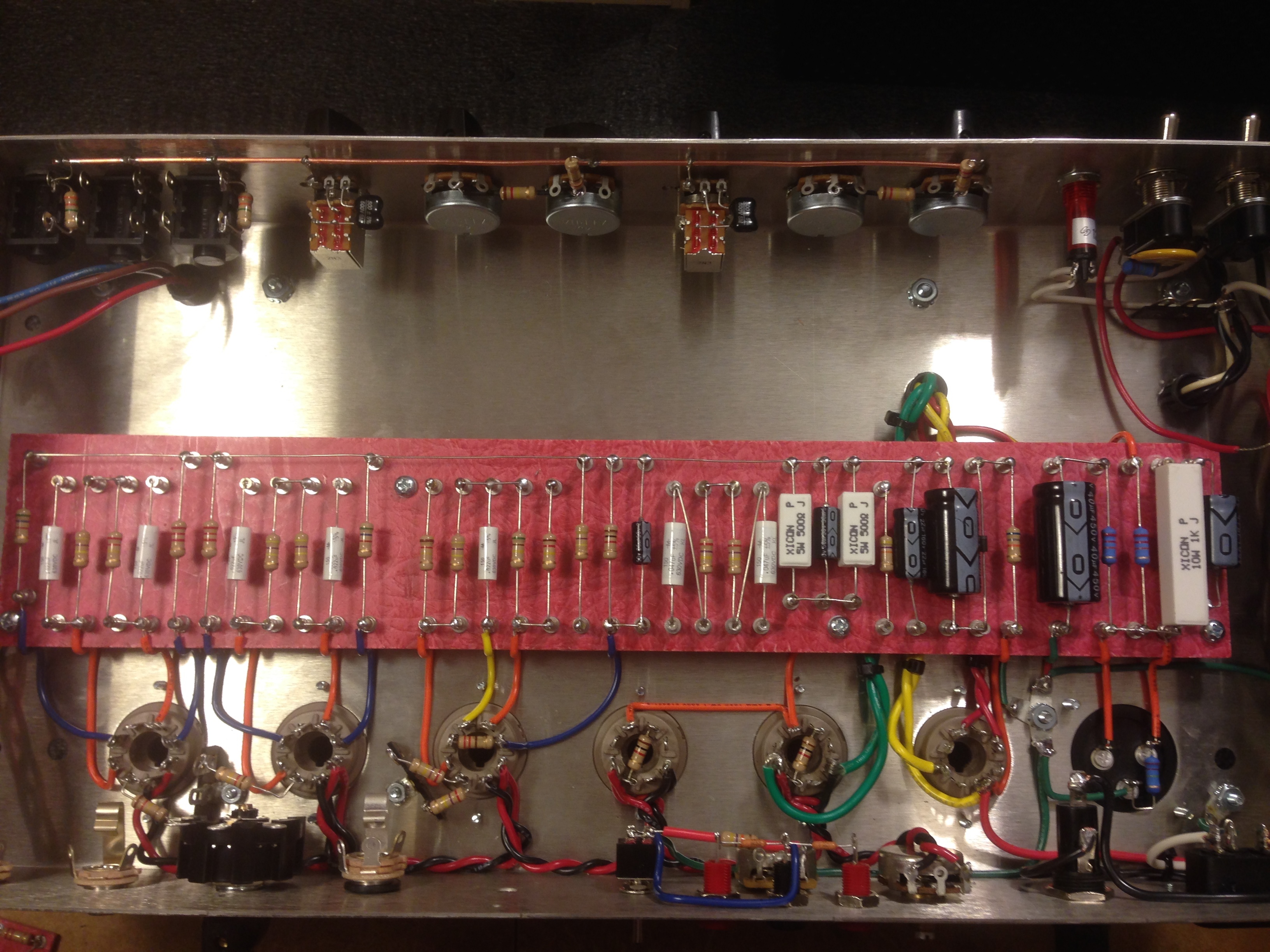

PostPosted: Sat Apr 25, 2015 9:59 am
Start Up Day. Tweaked Bias Tail Resistor to 22K 1W to get proper range for both 6L6 & KT88/6550
Ran 6L6 in Cathode Bias mode and Fixed Biased Mode at 43 mA
Ran 6550 Cathode Bias mode and Fixed Biased Mode at 48 mA
