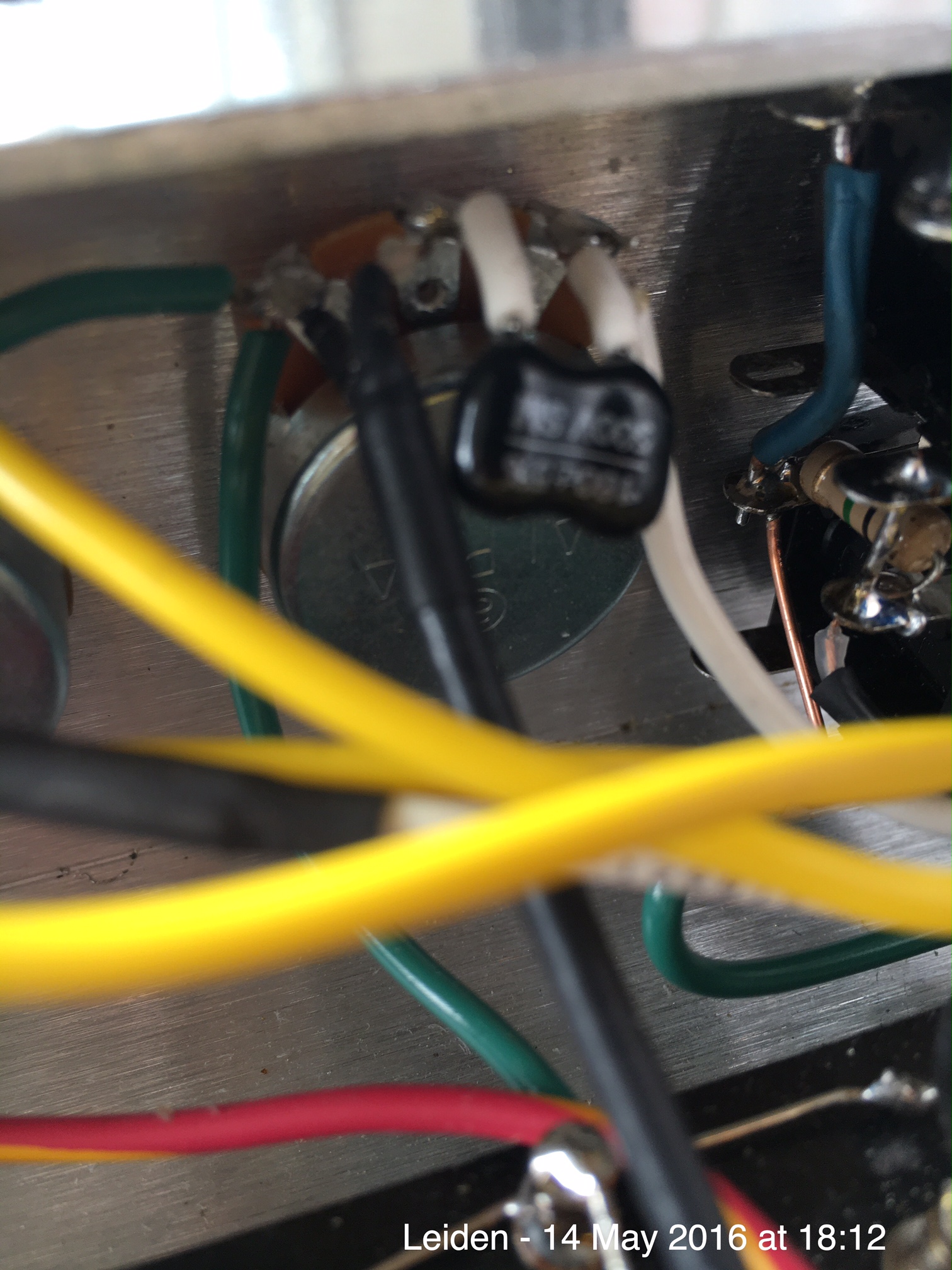

I have just finished my TC15 build and have spent some time tracking down a few problems I have but with no success yet. The amp works and plays with hardly any hum or hiss but there are low voltages that for the life of me I can't track down. Its very loud. The distortion on Ch1 is brittle and the general amp sound is muggy (esp. Bass which is in general flabby and when pushed it sounds more like a synthesiser than a guitar on the bass E notes). I'm keen to sort this out -as you can imagine- and Stephen has been helpful. But I am now pulling my hair out...
I'm not an electronics engineer so I'm essentially following the coloured schematic and pondering over the circuit diagram.
My main issues are:
1, pin 3 & 6 of V4 are 25V (should be 47V). When I probe the tag board with the meter grounded to the chassis at the take off for these pins, there is a pop in the speaker and a cut of all sound to the speaker (the hiss dies).
2. I also have low voltage on V1 pin1: 64v and pin6: 101V
3. I have for V5 and V6 Pin 7: 375V and for Pin9: 259V
B+ is 381V and all other pins on the tubes are in spec. voltage wise.
The other voltages probe points on the schematic are all about right.
What I have done so far
I checked all the components and board wiring and I can't see the error (but there is one!)
I changed the caps in the circuit to V4
I checked all the valve wiring and this is correct.
I have retouched all joints to eliminate dry joints.
I rebuilt the Contour switch (!) with some new caps
I tested all the resistors and all are within spec at 5%
I switched tubes (several times across the array)
I rewired V2, V3 and V4
I rewired the control Pots
Took all main board jumpers off the board that I had put underneath and put them into the top of the board to be sure (nightmare job once the build is complete)
Then I drank beer and pulled hair out like a madman at 02:00AM this morning as still no change - after essentially rebuilding the bugger and making all my nice work look messy inside with all the fart arsing about.
Few pics attached and maybe you might spot something or have an idea of the problem with another pair of eyes...
