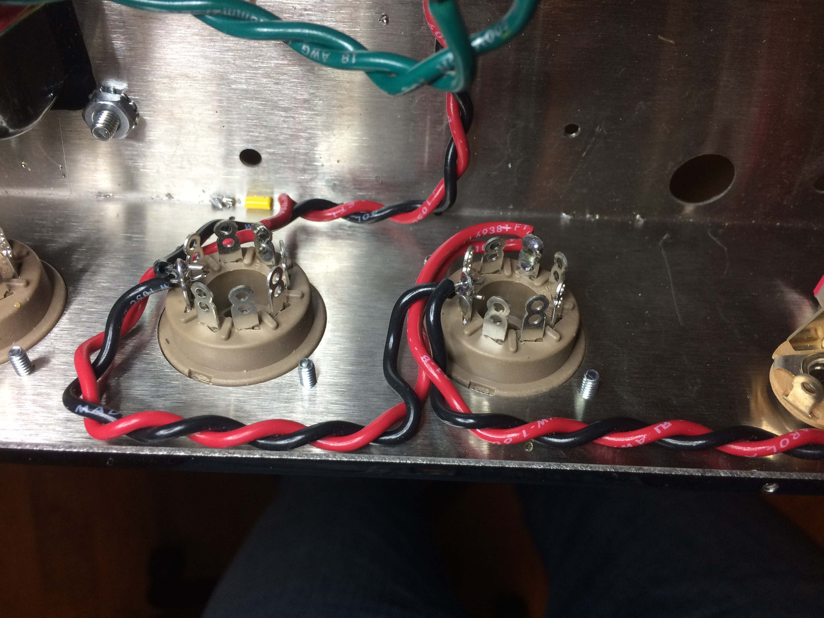

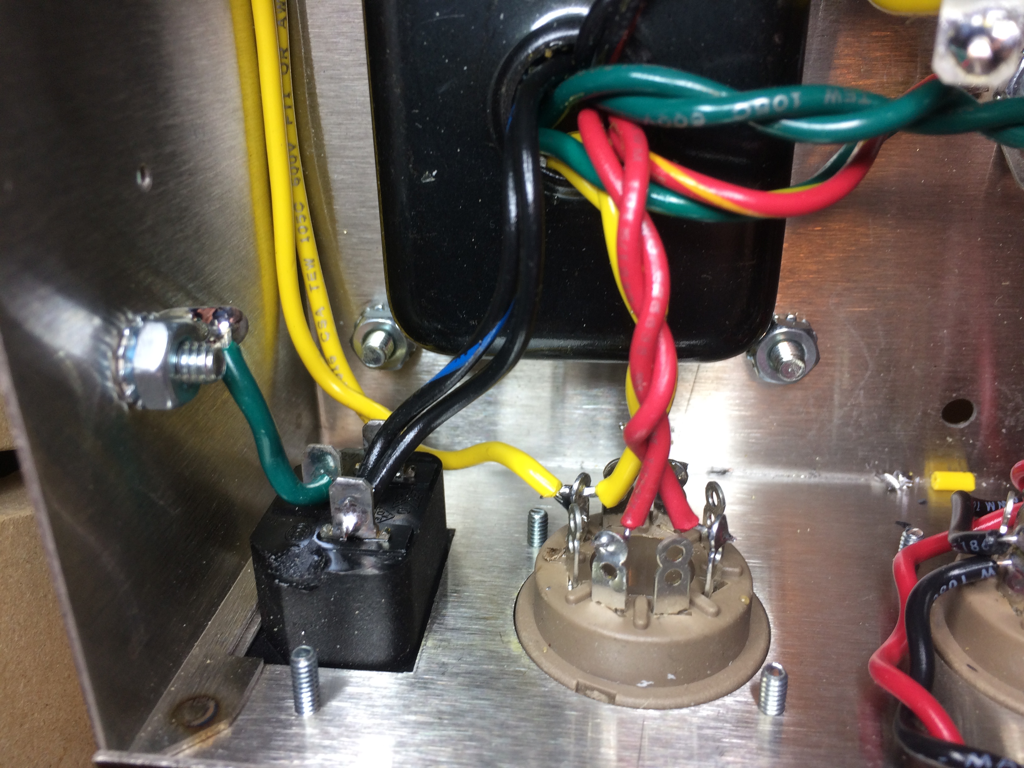

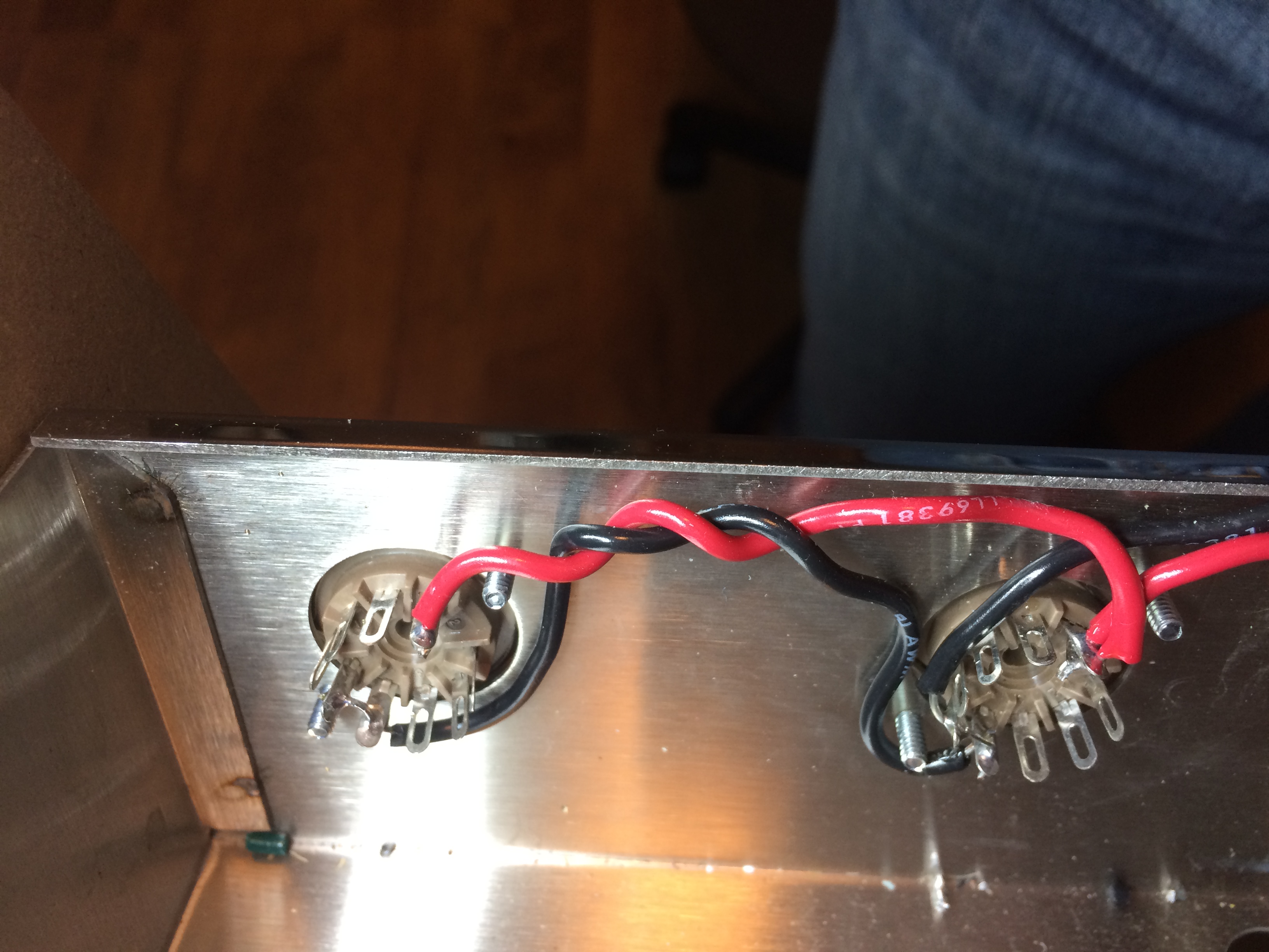

Hello,
I am a first time amp builder working on my Tweed kit.
I have wired up the heaters, power transformer, fuse holder, stand-by switch and the pilot light socket. The instructions say it is now a good time to check that the power transformer is working properly. It says to install the fuse and carefully apply power to the circuit (i have built a current limiting light bulb) and check the AC voltages are within range of spec.
I have not had a lot of experience using my multi meter, mostly I have checked my resistors. I have watched some videos on setting up my multi meter to measure AC but I am not sure how to proceed measuring on my amp (where specifically should I be placing my leads when doing the measuring). Also the instructions say the voltages will be higher with no tubes installed, how much higher is acceptable?
I have attached some pictures of what I have wired up so far.
Any advice/directions would be appreciated.
Cheers

Please double check your wiring from the mains to the switches with the layout again... (I am using Rev 10)
Something does not seem right...
Remember the black wire from the mains should go to the fuse before going to the power switch which then feeds the transformer...
Andrew
PostPosted: Thu Feb 23, 2017 11:29 pm
You can't check things too many times where line voltage or high voltage is present.
It looks like the wiring is OK, though. In the photos it looks like a yellow wire runs from the live terminal on the IEC connector to the tip terminal on the fuse holder. But it looks like the photo was taken before the wire that runs from the sleeve terminal on the fuse holder to the power switch was installed.
The transformer is wired properly. Black and Black/Blue to the neutral terminal on the IEC connector and Black/Red and Black/White to the power switch.

Thanks for checking my wiring. Yes I did use yellow wire to run from the live terminal on the ICE connector to the tip terminal of the fuse holder. And yes, in the photo I did not have the wire from the sleeve terminal to the power switch installed, it is now.
