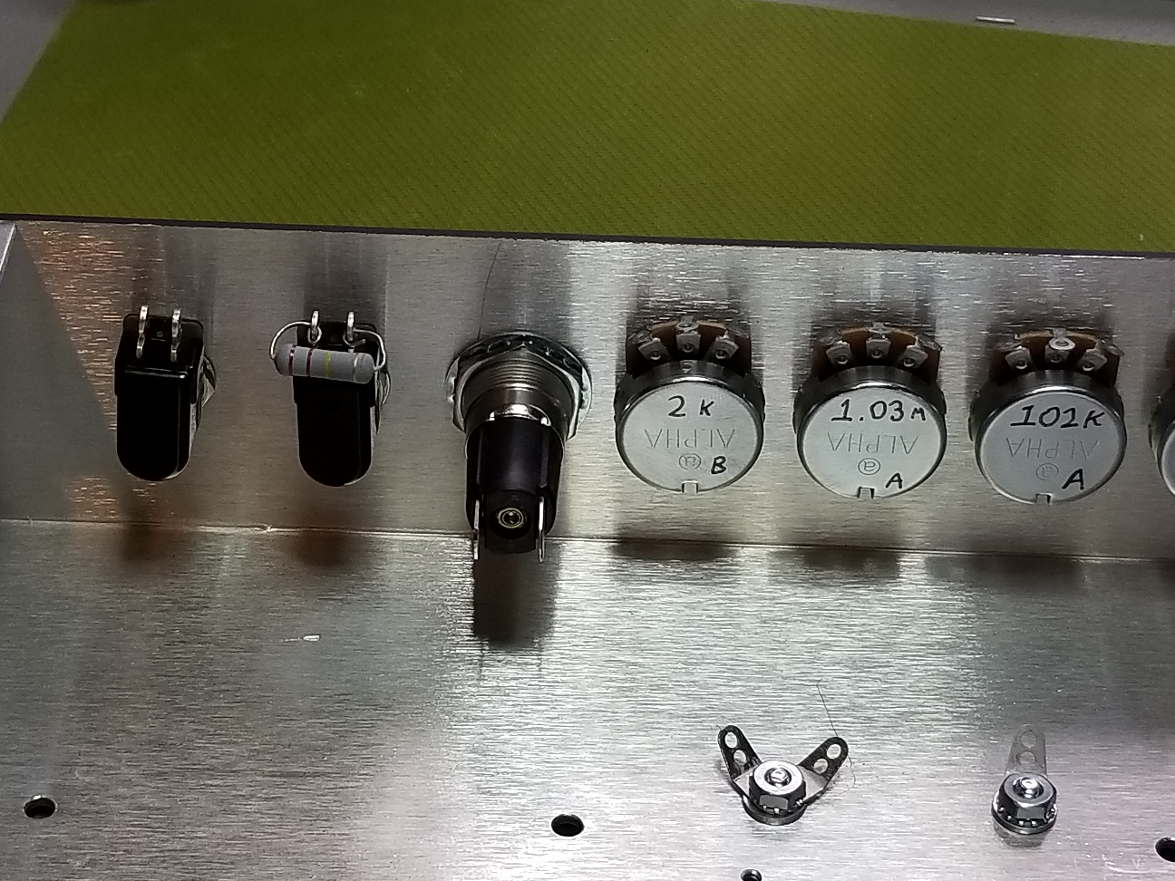

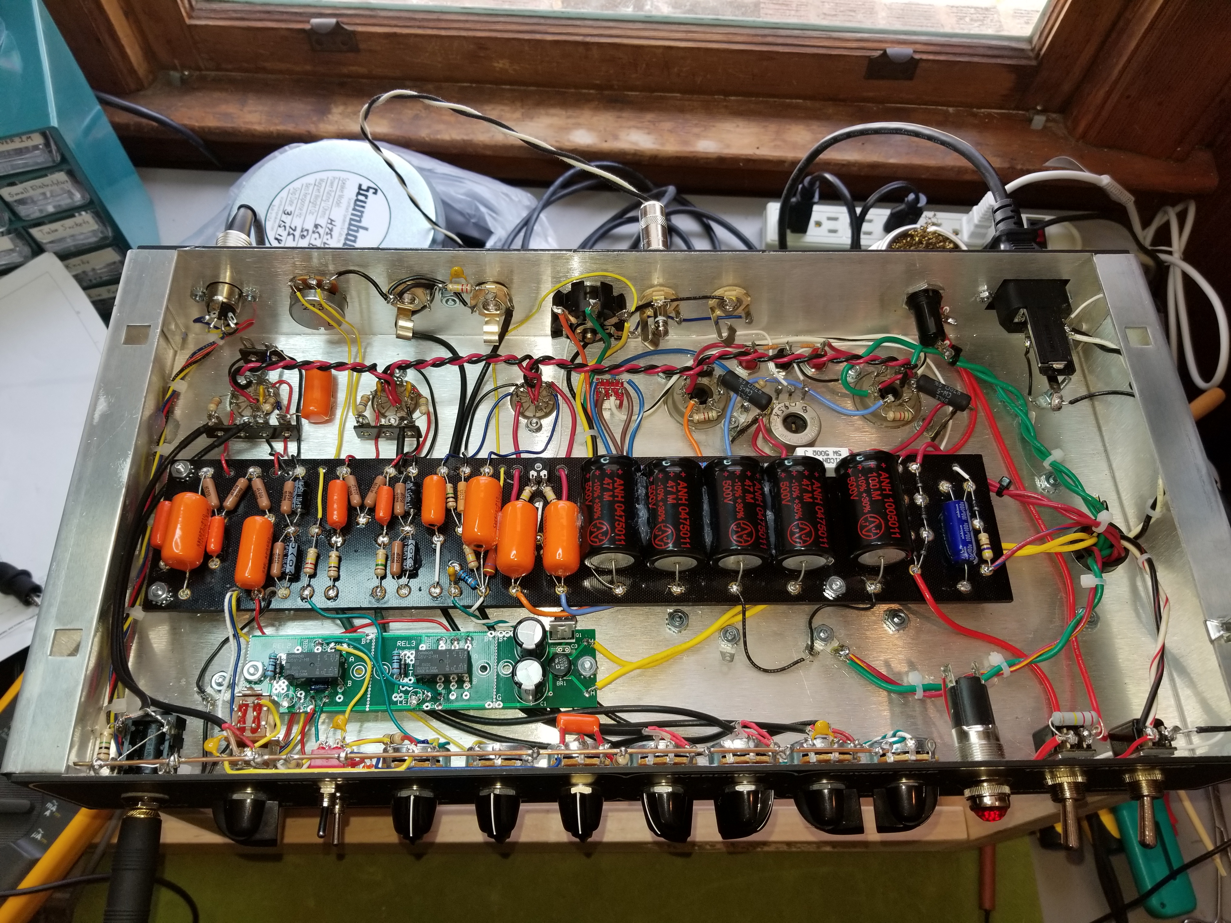

New member to the forum here. I thought I would post pictures of my OSD build as it goes along. I've long loved the tone of Dumble style amps, and I've made some attempts at Overdrive Special style builds in the past. I bit off a little bit more than I could chew at the time though, so I wasn't really satisfied with the results. I've built some Champs, 18 watters, and Trainwreck stuff since then, so it has given me some much needed time to work on my amp-building skills.
I picked up an OSD kit at the beginning of the month because I really liked how Trinity updated the layout - especially removing the FET board and powering the relays straight from the PT. I've been slowly working on it since then when time has allowed so. As you can see from the pics, I used a few different components for the coupling caps and the power light because I had them on hand and have worked with them in the past.
Special thanks to Stephen for his quick email responses when I had a question about the layout or builder's guide!
If anyone spots anything obviously incorrect please feel free to point it out!!!
All the best,
- Matt J.

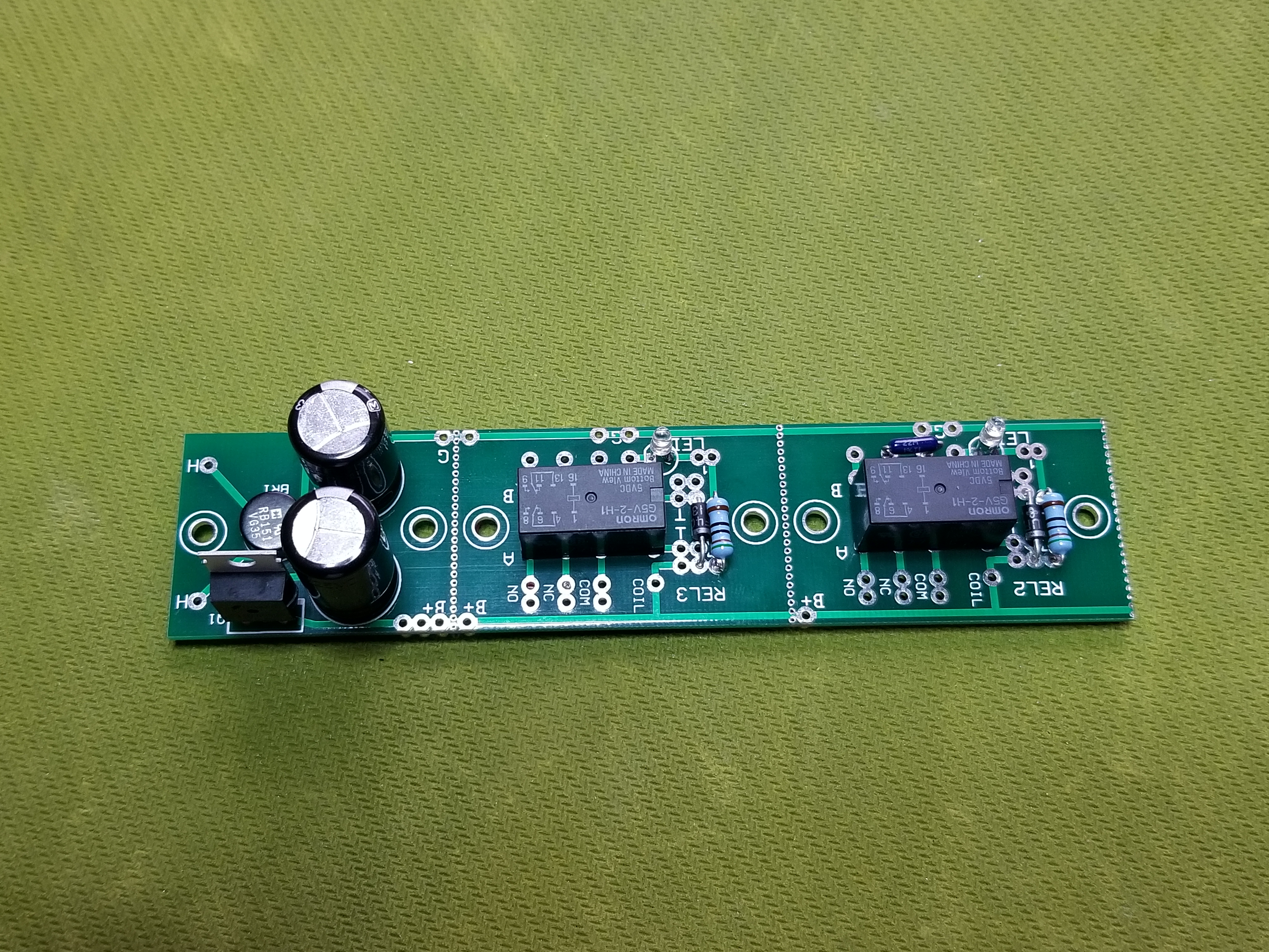

Wired up the PT yesterday and tested the secondaries. Everything checked out ok.
Built the footswitch and tested the relays. LEDs on the relay board and the footswitch lit up fine and the contacts points tested ok with my DMM.

Update:
Finished wiring everything up. Checked all connections and made sure there were no shorts. Gave it a test run with the current limiter. Everything came out ok with. Switched on the Standby and checked the B+. The power supply voltages came out ok, within the specified ranges from the layout. I set the bias for the 6V6s and checked plugged in a guitar. The amp did work when I plugged in a guitar, but the volume started dropping pretty soon and eventually cut off. I doubled checked the plate voltages and found an issue with V1B. There, the plate voltage was well over ~310DVC, when it should be about ~210VDC.
I've checked over the plate resistor, it measured out to the correct 100k, same with the 1.5k/10uf cathode setup. I switched out tubes in case one was faulty and got the same results. This is the section where the LNFB is located, so I'm curious if that could be affecting the voltage. Any suggestions or feedback would be greatly appreciated!
- Matt J.

Hey Everyone!
I have been out of commission for a bit due to a kidney stone attack, but now that I am feeling better I've been able to spend some more time working on my OSD.
Everything works fine mechanically, switches, pots and controls. I did rewire the Trim pot so that full clockwise, looking from the back, sends the most signal into V2 and vice-versa. Also, I changed the presence cap to a 2.2uf tantalum to give the presence control a little more depth.
The amp has had some noise issues since I finished it. I the JJ 12Ax7 I used for V1 to be a little noisy, so I replaced it. I also plugged the amp in into a different outlet since my house is fairly old and, due to some older wiring, may have some grounding issues.
That cut down on much of the noise, but, there still remains a great bit of hum when you are only in the clean mode. The OD doesn't hiss or buzz anymore than you would expect from an overdrive circuit, but the clean side has a LOUD hum/buzz when it is only activated. The sound and scope of this noise changes when you wave your hand over the chassis. Also, the level of the noise increases when the PAB is engaged, or when you set the Rock/Jazz switch to Rock.
I've taken some more pictures of the area. If anyone spots any errors, questionable solder joints, or wires were they should not be, please let me know!
- Matt J.

PostPosted: Mon Apr 16, 2018 8:41 pm
Posts: 112
Location: Bangkok
For what it's worth.
My OSD is really quiet.
And I play vintage style singlecoils mainly.
Anyway, go through all solderings. Wiggle the wire a bit, so you can confirm the solder is solid.
I found a couple of loose solderings that way myself.
Good luck:-)
