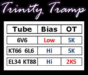

Mitch, glad an amp guru chimed in. Since I'm fairly new, I erred on the side of caution. Lighthouse understands what can be done with an amp better than I do! :oops: PS My guitar playing buddy likes the sound and tone with the 1K resistor in place of the 560 ohm resistor. As Coco states in the in Tone Tweaking addendum, works well with EL 34 and KT 88 (have used both tubes).

Lighthouse, check page 8 of Tramp board, topic: Installing a switch for EL 34 by kurtlives. I remembered the other night having read this before :idea: He shows a wiring setup for the selector with 6 positions, selectable for 4, 8 and 16 ohms for 2.5 and 5k OT both :!: Check it out. Edit: You still have to use the bias switch for the 6V6 (low)

Build threads are ALWAYS good! How else am I going to satisfy my amp porn addiction. :thumbsup: PS Thank CheopsisIV for the bias and load chart, I just saved it, it's a good reference :!:
