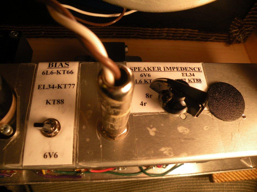

Cecelius2, I made this up to print out and stick to my chassis. I used the Hi/Low bias (6V6 being low) and the rotary switch as explained above.

Here are two pictures of the two temporary labels I made for the rotary impedance switch and the bias switch [the first is the same picture from my build thread]. If I decide to keep this then I will have a real stickers made, but this serves my purpose for now.
File comment: Pictured with knob
File comment: pictured without knob so you can see the whole label

Great thread. Would be nice to have clearer photos or link to clearer photos.
