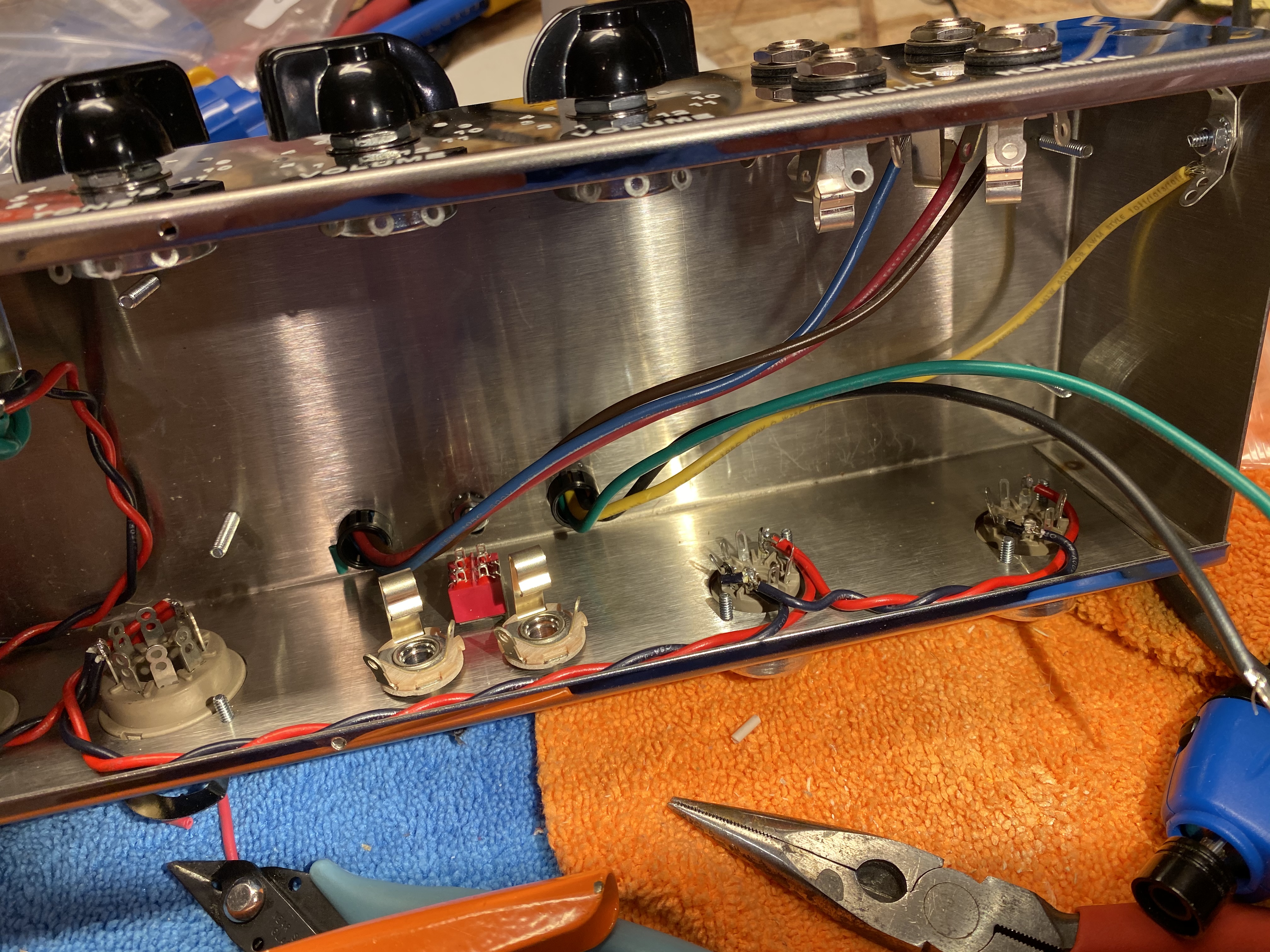

I’ve started in on a tweed build... I’ve got some experiencing soldering from other hobbies and like to try things myself while at the same time not afraid to ask questions along the way. I’m finding myself reading the directions over numerous times to try and figure things out so hoping the forum can help me along the way so I’m not driving Stephen too crazy with emailing my questions and maybe some else can learn something too.
First question... which way do I orient this switch? So I have it in the 4ohm or 8ohm position based on them picture?

Roar, it doesn't matter which way the switch is oriented. What matters is how you connect the wires, that is the center lugs will go to the output jacks and if you imagine a diagonal line through the lever(toggle) it will point to the lugs you want connect the 8 ohm wire to. In your picture, for example, with the toggle up you would connect the 8 ohm wire to the bottom lugs of the switch and with it down you would connect the 4 ohm wire to the top lugs. Does that make sense to you? It's easier to show than to explain :shock: Also you can check the Tramp guide, V.3.51, pg.47 for a good explanation by Coco. Hope this helps and doesn't confuse the issue :bugeye:

Hi Roar, welcome to the forum!
Like Hank said, these little switches connect their center lugs to the lugs opposite to where the toggle is flipped. You can see this for yourself with an ohmmeter. Look for which lugs have continuity and which way the toggle is pointing.
The layout drawing (at least the one online) shows how to wire the switch. Here's the side view of the switch:
And here's a view showing the back of the switch :
The speaker jacks go to the center lugs, the green 4-ohm wire goes to the lugs closest to the top of the chassis and the yellow 8-ohm wire goes to the lugs closest to the speaker jacks.
Good luck with the build!
