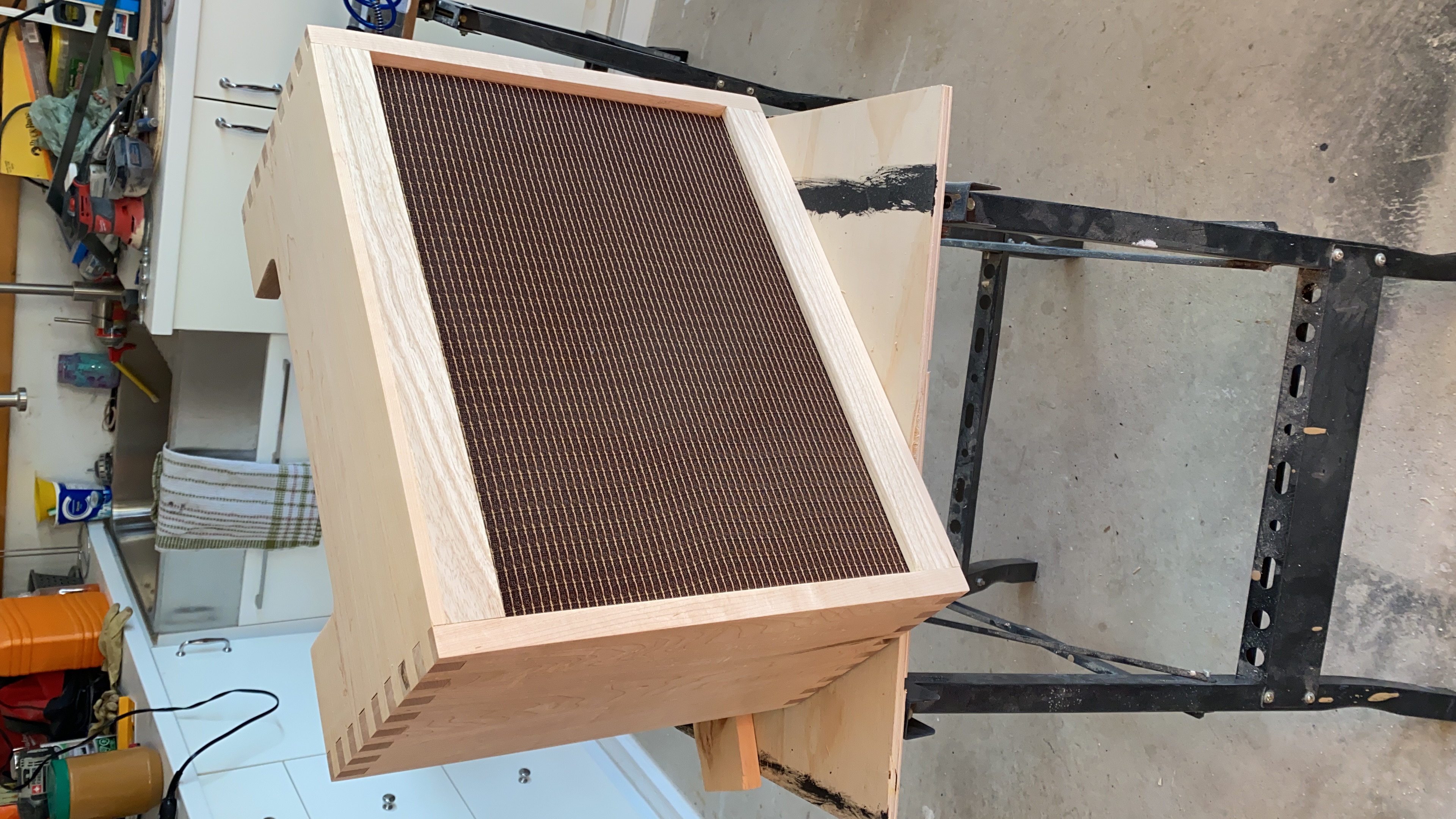

Wow how time flies. The new year rolled around and the guitar portion of my project kicked in and and kept me occupied. I'm working with a local Luthier building a telecaster and having a blast... until COVID. So with that shut down for a couple months I decided to start in on the cabinet build. I still haven't mustered up the courage to test my amp yet... really need to do that. I've included a photo of the cabinet build though, hope to upholster the speaker baffle tonight. I think the natural maple looks amazing, I'd never done box joints before and they turned out alright... plan is to paint the cab to match the theme of my guitar build but right now I just like looking at the natural finish.

Good to hear from you again :thumbsup: Cabinet looks good, first time building one? Box joints look good and strong.

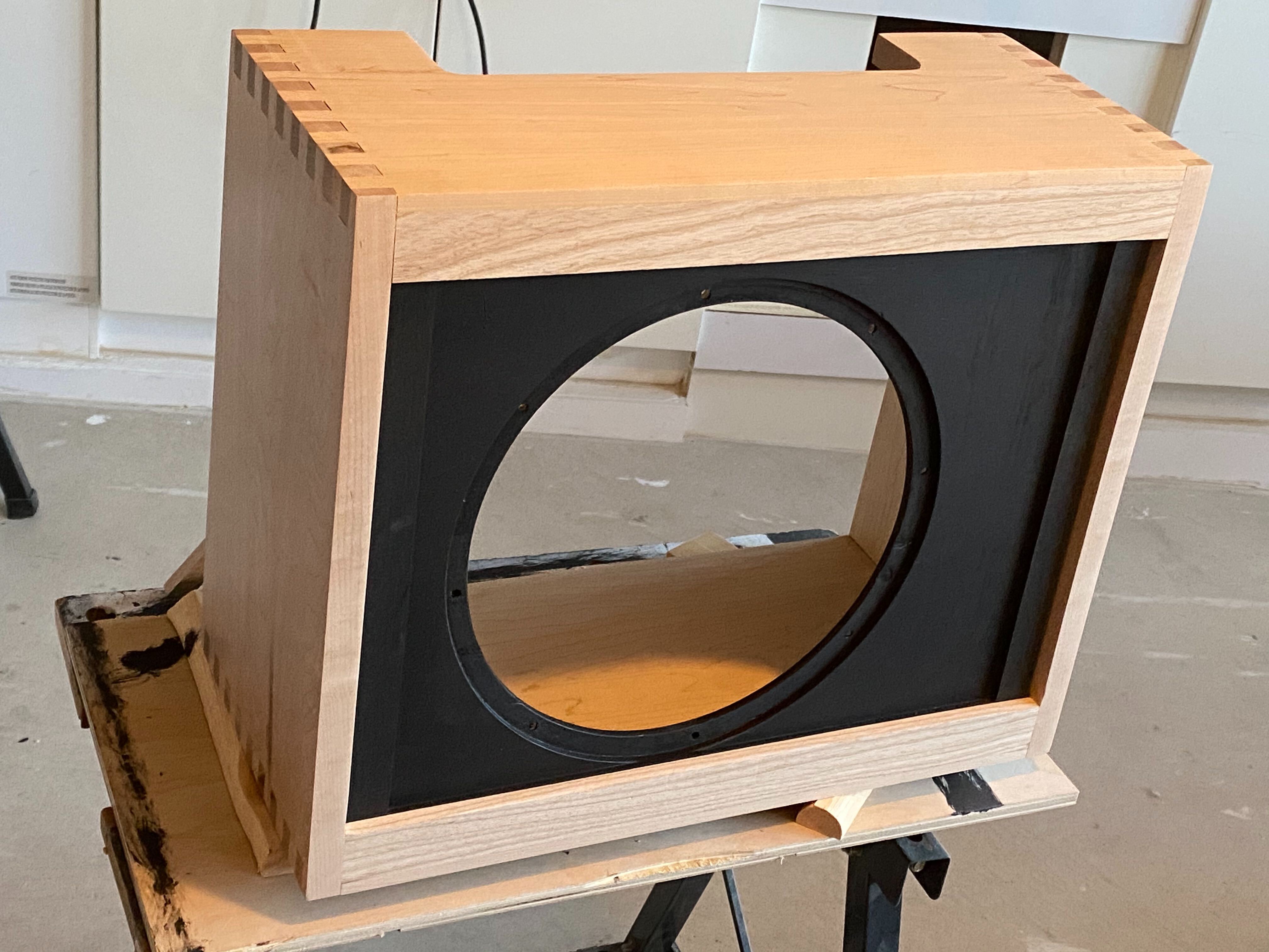

First time amp build and cabinet build, so far so good. Got the speaker baffle covered last night... not entirely happy with the result. Hard to get the right tension across both sides and not warp the pattern. I used a hair dryer to warm up the material and that helped get it wrapped around the wood better. It is nice and taut though so I've got that going for me :).
I've only ever really dealt with low voltage electronics before so the clips I do use are not a terribly thick gauge, they are just cheap ones from Sayal that look like the attached. I usually just clip those on to the end of my probs... I think I'll look for clips that plug right in the meter and not screw around with these cheap ones. I also read MitchM's response and it's helpful, I should be able to sort those measurements out.
I also need to round over the edges on that cabinet and build the back panels. Looking forward to trying to get the radius right on the lower panel.

+1 on on meter probe/clips. Be sure not to get the cheapest ones. When my Craftsman MM went south on me, I bought an Amprobe AM 560 (subsidiary of Fluke)which included both pointed and clip probes. Was fairly reasonable on Amazon, although I've heard A-zon doesn't ship to the Great White North.
Coco posted his trick for grill cloth somewhere, but can't find the link. I seem to remember that it involved folding, squaring up and stapling the cloth along the top edge, then taking 2 lengths of wood (1x2) and clamping the cloth between them. That way you could pull the cloth evenly around the bottom of the baffle to the back and staple the cloth. Hope that makes sense. When I did the roundover on my cab,I used a 1/4' roundover bit, so if I didn't like it I could step up to a 1/2". Liked and left it at 1/4". BTW, here's a link to 5E3 cabinet plans at Modulus Amplification https://modulusamplification.com/DIY_DOWNLOADS-W4.aspx

We've got our own Amazon.ca up here but with an entirely different and higher priced inventory :). We can order from the .com though, Prime doesn't work for free shipping and we may get whacked with duty. Things are starting to slowly re-open around here and hardware stores are one of the ones doing so. I've got a Princess Auto close to me I may venture out to on the weekend, they've got some clip's that look like they attache to the end of my probs I'll give a try.
That cabinet plans are the same ones I used to build my cab, the 3" radius on the lower back panel took some figuring out but I got it cut last night so the cab is about 95% ready for paint... just need to cut and attach the cleats.
I also watched a video where part of the baffle was clamped down to aid in stretching the material... unfortunately when I made my baffle I built it in a way that you insert the speaker through the baffle and then fasten the speaker to the baffle so it needs to be attached when I upholster. I may cut a new baffle and try again... not sure how crazy the waviness of the material will make me. Also considering different colour upholstery too.
