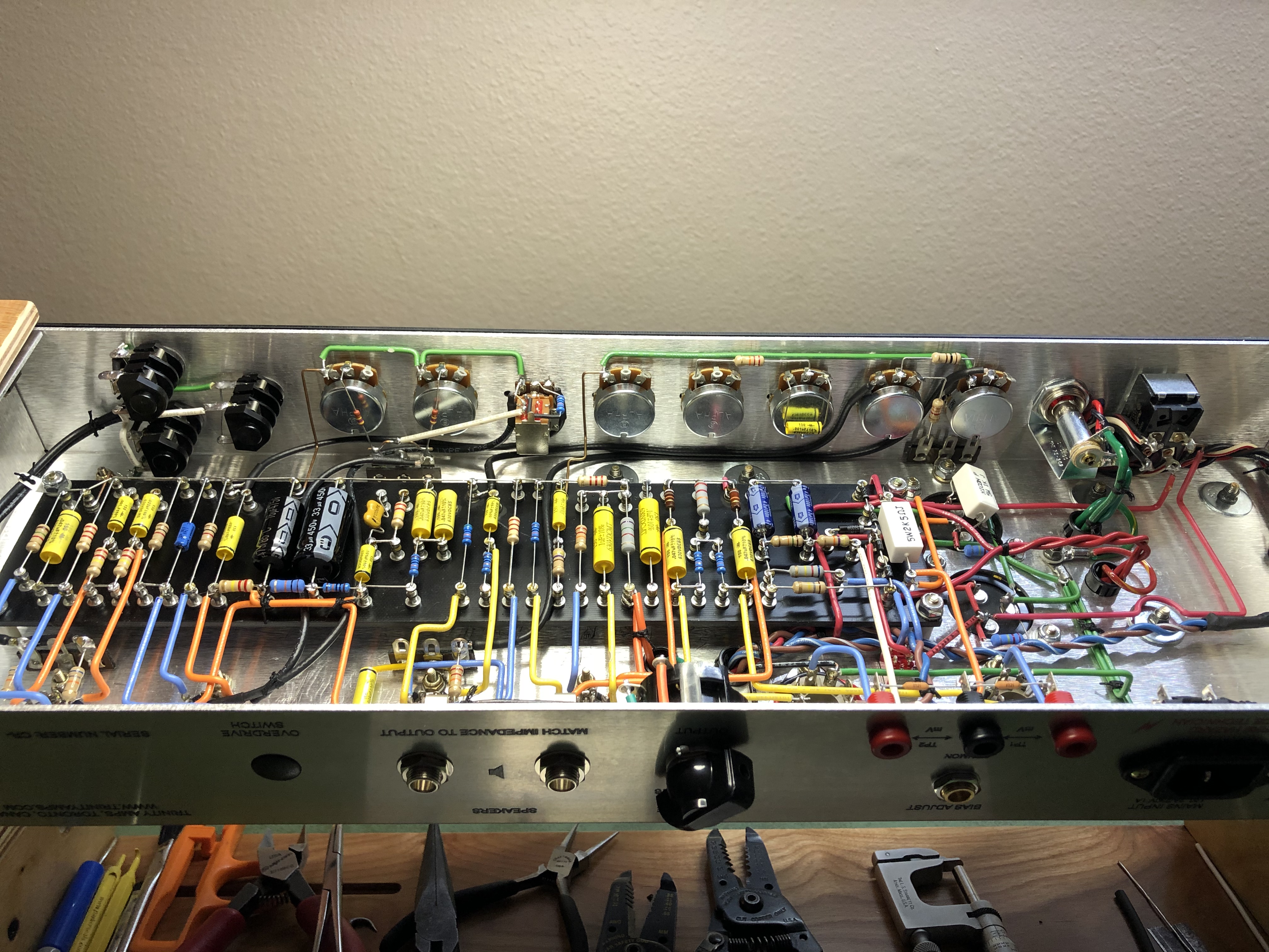

Here is my build so far

Looks very nice.
