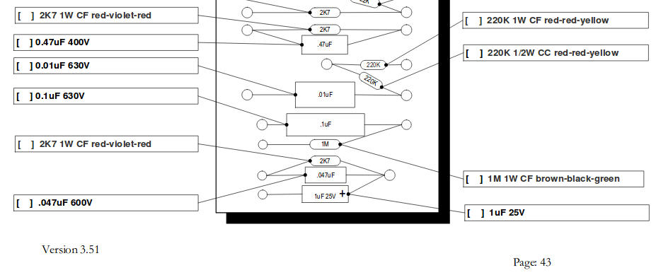

This is just a quick post to point out a two spots in the Build Manual I found confusing.
On page 43, I think the positions of the 220k carbon film and carbon comp resistors are swapped.
File comment: In this picture, I think the diagonally mounted 220k resistor is CF, not CC.

In both of these, there's plenty of other information to get builders to the right place, but I thought it was worth pointing out the parts that were confusing to me.

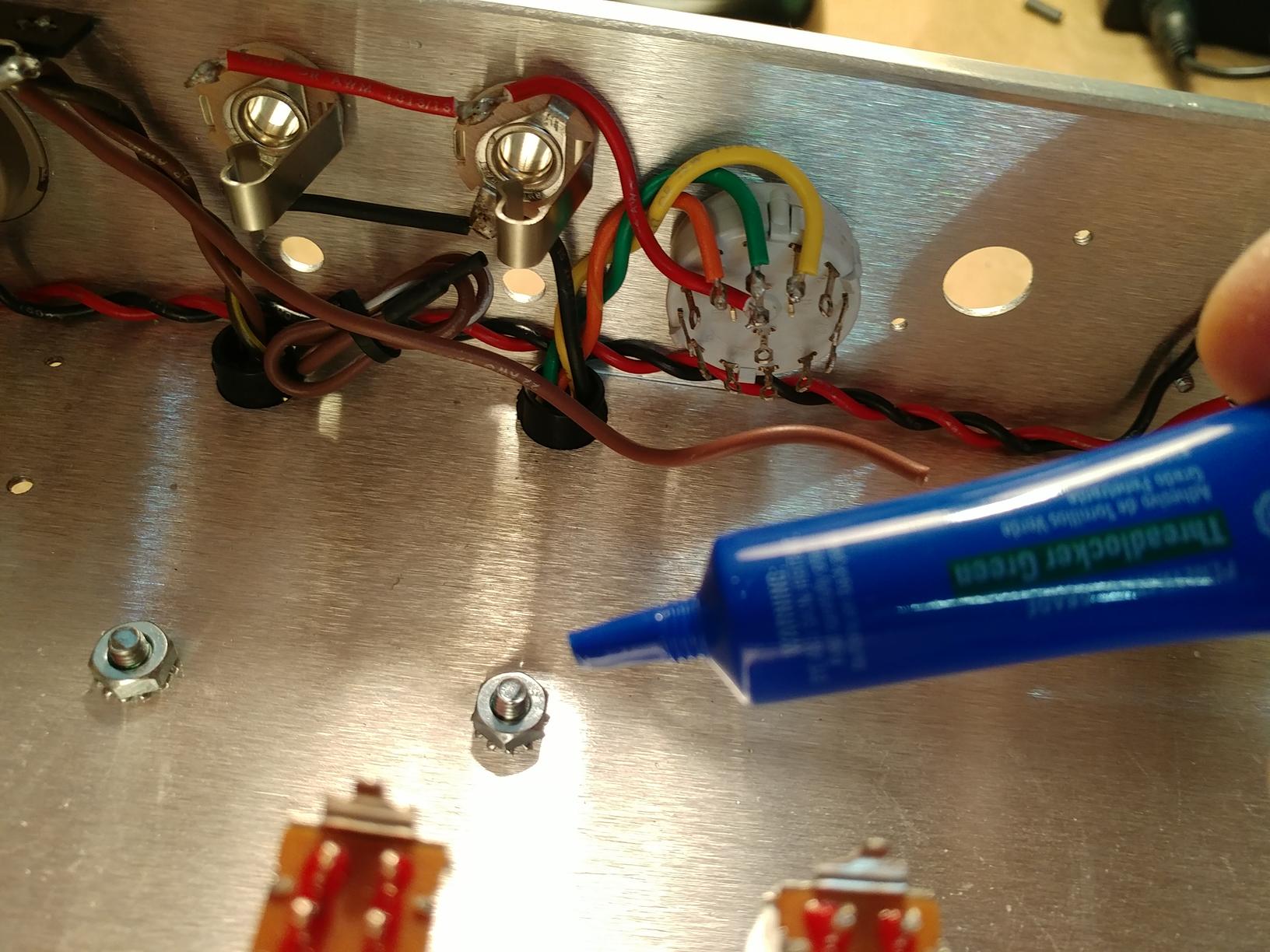

Before installing the board, I got worried about the transformer mounting screws and nuts loosening up. I don't want to later have to deal with tightening nuts that are hidden behind the eyelet board. I had some "green" threadlocker that's supposed to wick into the threads of already-assembled fasteners, so I put a drop on each of the nuts. Next time I'll put blue threadlocker on before assembly.
File comment: Adding threadlocker after assembly

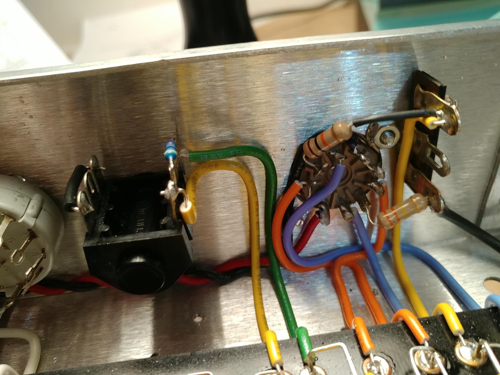

Next I wired up the remaining connections inside the chassis.
There are a few connections that run from one side of the chassis to the other, such as the negative feedback line from S5 to R18, and the line from the wiper of the Volume pot to R14 on the grid of V2. Instead of running those directly across the chassis opening, I routed them under the board because I think that looks neater. For the line from the volume pot I used shielded wire to make up for the longer (and likely noiser) wire routing. The Builder's Guide mentions using shielded wire for this on pages 48 & 49.
I decided to omit the high-voltage impedance selector switch on the primary of the output transformer. It sounds like this is a common source of problems, and I think I can get the same effect by printing a different label for the low-voltage impedance selector switch on the secondary. More on this later.
Here's a picture of the completed chassis build.
File comment: All wired up
I used a 470k resistor for the PAB circuit because that's what I had handy. I'll see how it sounds, then go up or down if necessary.
Here are some more or less blurry detail shots in case they're useful to anyone.
