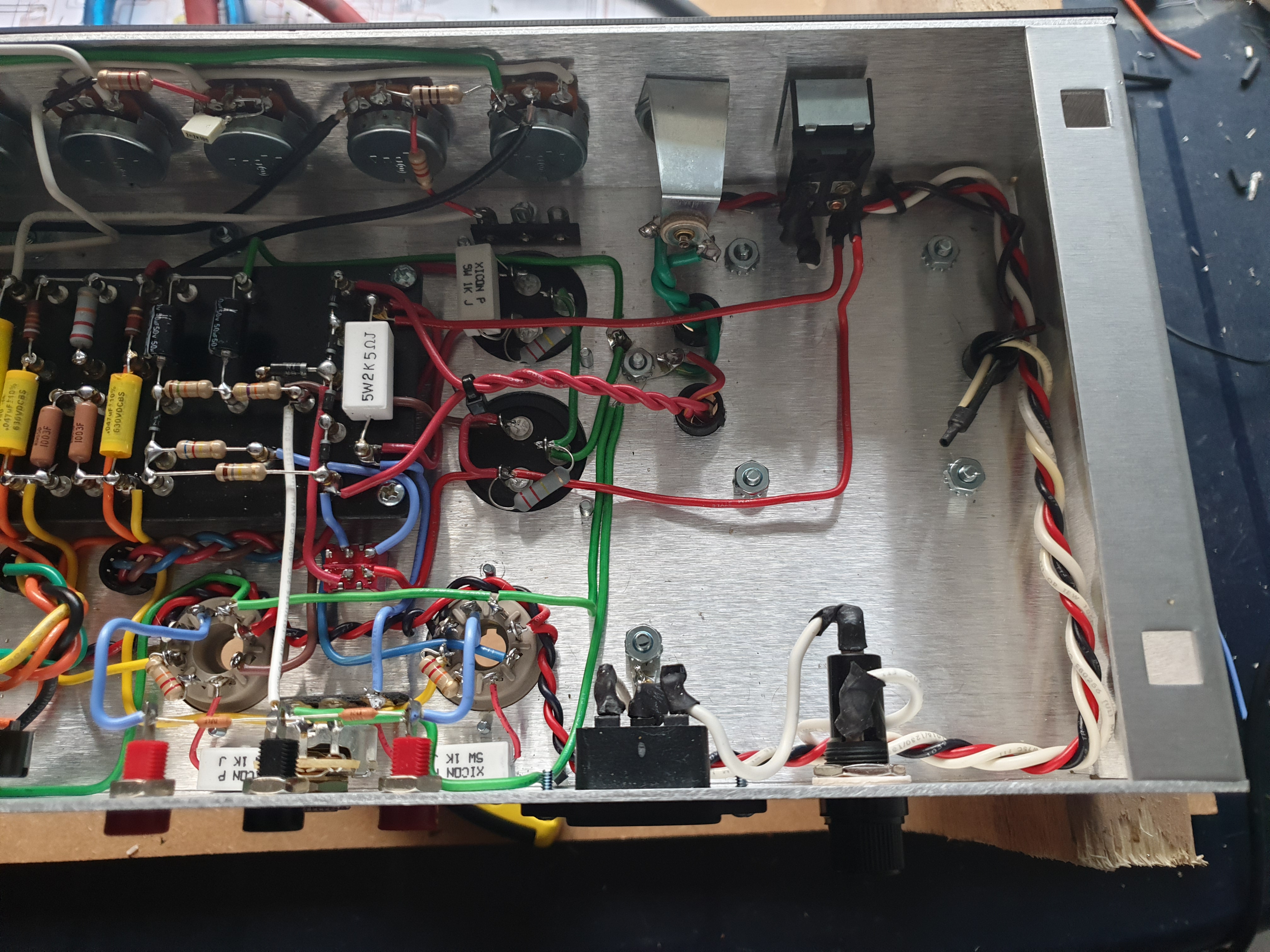

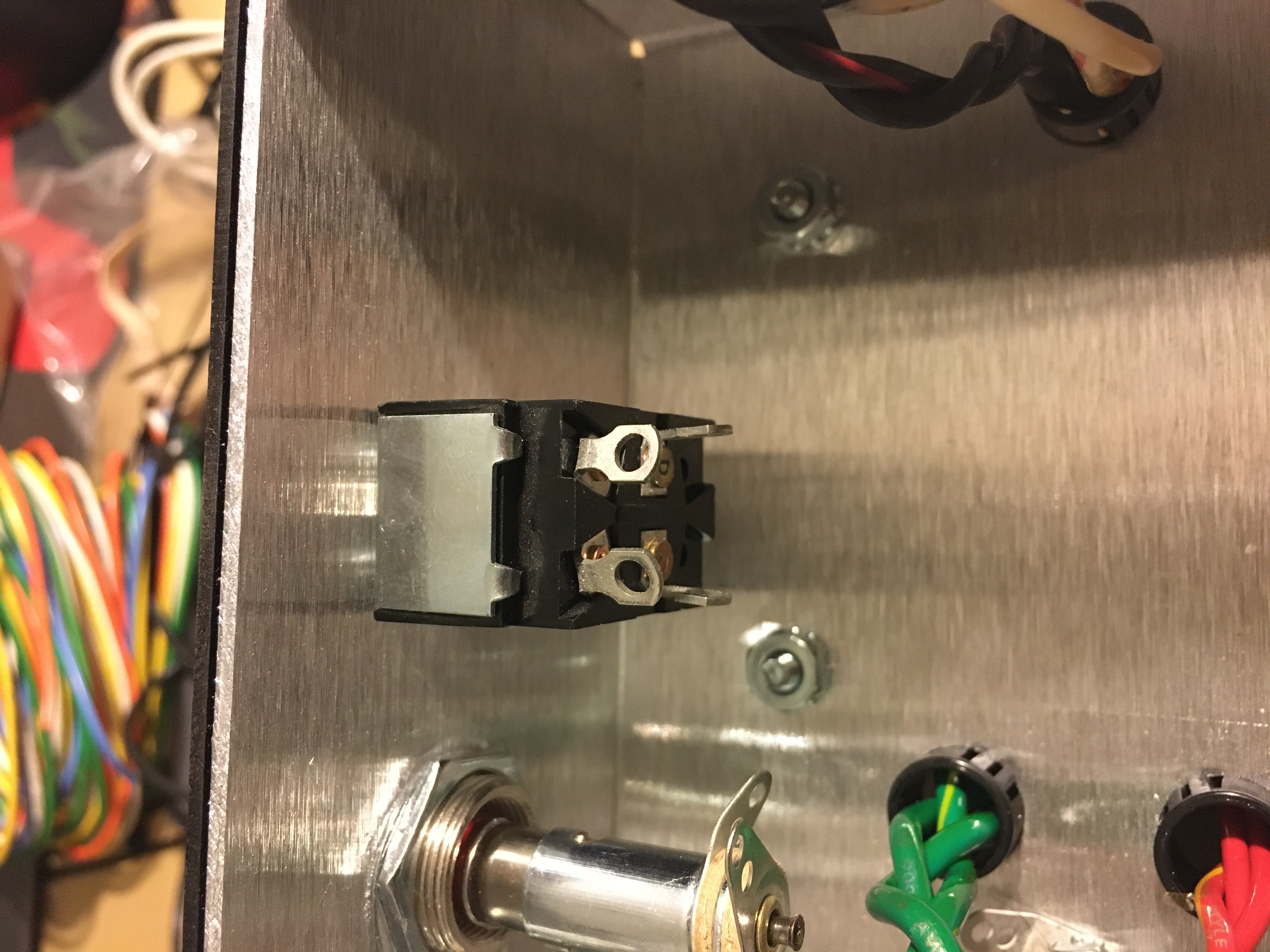

Hi folks, I have taken the plunge and started my Triwatt head build. Chassis component installation has been going steady, but unfortunately I'm getting wrapped around the axle on the power switch orientation and wiring. I've been poring over past forum posts and seem to see the switch oriented both ways, and I'm having difficulty from the instructions understanding which wires should go where for my build.
Per the instructions, "On" is when the switch is pointed "down" toward the 4 lugs. However, the instructions also show the "On" position with the installed switch pointed at the top/intersection of the chassis. This doesn't seem to match my front panel, since this "up" position is labeled "Off." According to the diagram in the instructions, the angled lugs should be on bottom when I'm facing them, but with "On" correctly matching the front panel (i.e., "down"), the angled lugs are on top when peering into the chassis. Do I just flip the wiring diagram shown in the instructions, or am I missing something?
Interestingly, a sampling of others' photos shows the switch orientation and wiring both ways (see photos in "Triwatt Build - Almost Complete" and "Triwatt Build" from April for examples), though it seems maybe the combo version is reversed because the chassis is located at the top of the combo instead of the bottom of the head. Everybody building a head like me seems to have the switch backward from how I'm interpreting, but why would you want the "Off" label aligned with the switch "On" position? Hmm...

PostPosted: Sun Jan 05, 2020 6:18 pm
Posts: 61
Location: The Netherlands
I had some issues with this as well.
Check my build pics in my previous topic.
Mine is placed with the angled lugs facing towards the chassis.
I've added two pictures for clarification.
Let me know if it helped.
Kind regards.

PostPosted: Sun Jan 05, 2020 6:38 pm
Posts: 19
Thanks for replying! Yours was one of the builds I'd looked at :)
Can you confirm with that switch orientation that the amp power is "on" with the switch pointed down, toward the "Power" label? Since so many people have theirs oriented this way I figured I would just wire it that way (per the instructions) with a little extra lead in case I needed to rotate the switch after installation.
PostPosted: Mon Jan 06, 2020 4:43 am
The easiest way to figure it out is just connect an ohmmeter to the lugs and see which way you have to flip the handle to get continuity. This is the "On" position. Then mount the switch so that position agrees with what's printed on the faceplate. Traditionally, down is "On" with English amps.
PostPosted: Mon Jan 06, 2020 7:08 pm
Posts: 61
Mine is off like this.
Just check with an ohm meter like Mitch said.
