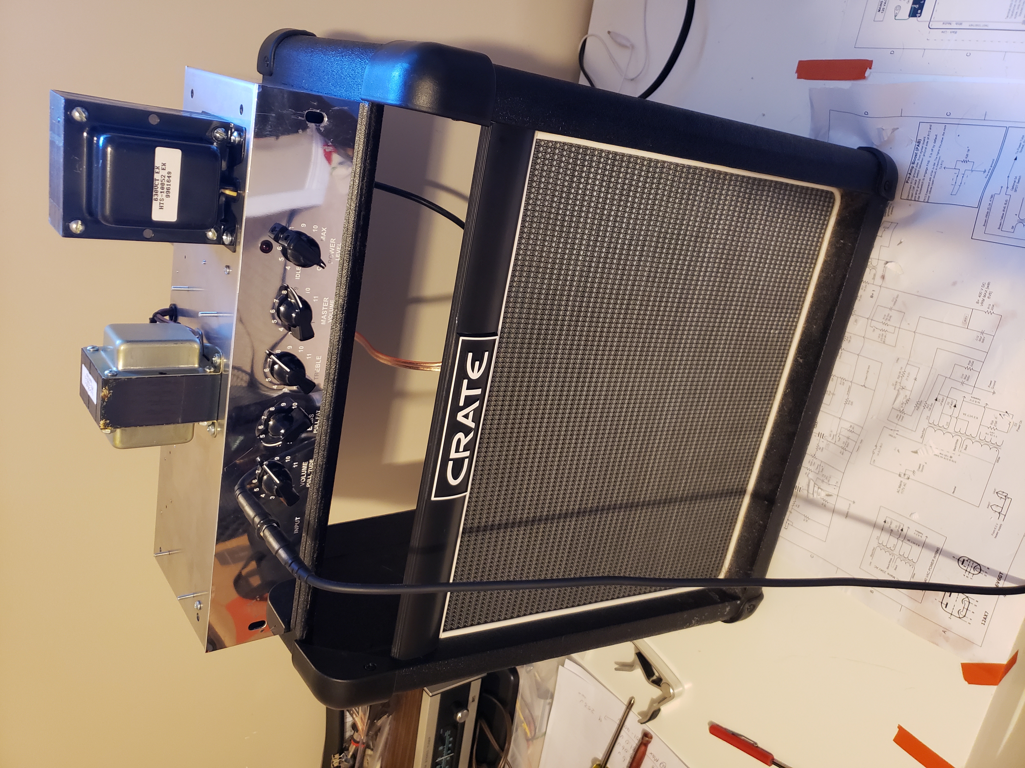

Hello everyone! Hope all are doing well. I have spent a bunch of time with the Tramp over the past few weeks. Still haven't gotten the parts to fix up the vrm yet, however I have still been able to enjoy the amp running at full power.
Currently I am running a 6L6 and a 12ax7 both from the preferred series from the tube store. Amazing! Was getting a little bit of oscillating from the preamp when gain is maxed and in tude but this was a quick fix. Moved a few wires around in the preamp section, squeal gone.
My buddy dropped off a huge Rubbermaid of pedals to play around with the amp. Wow this amp just loves pedals. My favorite has been providing large amounts of boost, +18db and it just roars. Back off the volume a bit on the guitar and a light touch it cleans right up with just a touch of grit just beautiful sounds. Can't wait to do some recording with it! Huge tones without blowing my head off (as much hehe).
Love how responsive it is, the attack is clear and doesn't get mushy. I assume this is from having a solid state rectifier. And when the amp is cranked you get just the right amount of sag without being total mush. The amp loves to feedback (in a good way) and is so rich it just wants to sustain for days!
Super happy with the Tramp, haven't found a bad sound yet. As the ultimate compliment, my wife, whom isn't interested in anything related to guitar or gear, came downstairs and asked what album are you listening to that sounds so good? Shimmering and thick, almost like piano? Ah that's just me babe. Really? Wow, you've never sounded so good...
A man can't ask for a better compliment than that! Thank you Trinity for making a thing of beauty. The Tramp is certainly here to stay. Now I just have to wait for my brother to get the cabinet done for me so she can be boxed up properly. For now it's an embarrassingly awkward setup, but it works.
Cheers,
Kim
