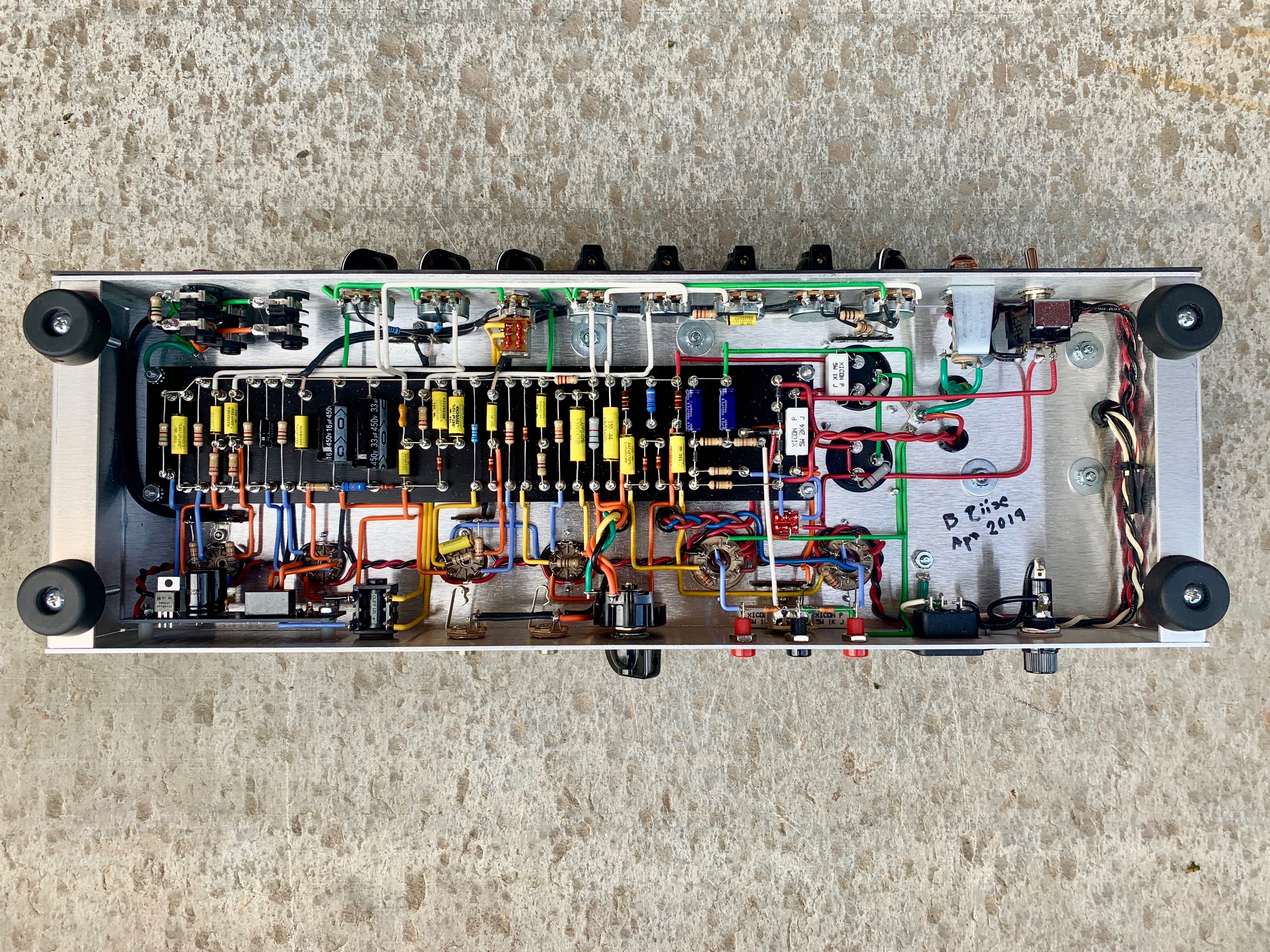

I have now finished my Triwatt build and it sounds fantastic!
But I have problems with hum/buzz from V2 induced by the OD relay board.
Apart from this the amp is very quiet and the noise floor very low but the hum is louder than I think it have to be.
I have performed the following tests:
1. disconnected the 6.3 V AC heater cables from the OD PCB and powered the OD board from a 9V battery. Result same hum level as when powered from the heater supply.
2. When battery powered grounded the OD board. All hum disappears! A very low hum can be heard on full volume, same as with no OD board installed.
Conclusion:
The OD board needs some form of ground reference. But how to do this when it is powered from the heater supply?
When the OD board is not grounded the whole board acts as an antenna for hum and the cables to the front panel OD-switch are very sensitive. Whit the card grounded this is not a problem and you can touche all cables without inducing hum.
Any tips what to do? Is it verified that the new OD-board works without inducing hum?
/Bjorn

 Post subject: Re: Triwatt build
PostPosted: Tue Apr 30, 2019 8:18 am
Give me a little time to test this. I am workng on one right now.
We do have a seperate transformer we can send if necessary. No charge.
This is a new design.
PostPosted: Sun May 05, 2019 3:05 pm
Joined: Sun Feb 03, 2019 12:59 pm
bbrodie, The hum appears when you turn up the master volume, regardless if the footswitch is connected or not. The hum is proportional to the volume setting and doubles when the overdrive gain stage is engaged and the overdrive volume is set to full.
The pull switch works when the footswitch is disconnected. There is no difference in hum level with or without the footswitch connected.
I've had no time to investigate this further. My plan is to exchange the voltage regulator and the relay for 3V versions and supply the card from only one side of the filament winding and the center tapp (grounded). I will order the components tomorrow and return with the result when tested.
I suggest that you wait for Stephens answer. I'm convinced that he will come up with a much more elegant solution.
Bjorn

If we test and we have to send a small power transformer for this, it will be able to be grounded.
PostPosted: Fri May 10, 2019 8:27 am
So we did some testing and it seems we will need to send a small relay power trasnformer. We cant get a ground reference. Although we didnt put the new board iinto an amp yet, we know a seperate transformer will work. We will send detail out shortly. Anyone with this issue should let us know to make sure we cover you. We will also look through our sales records.

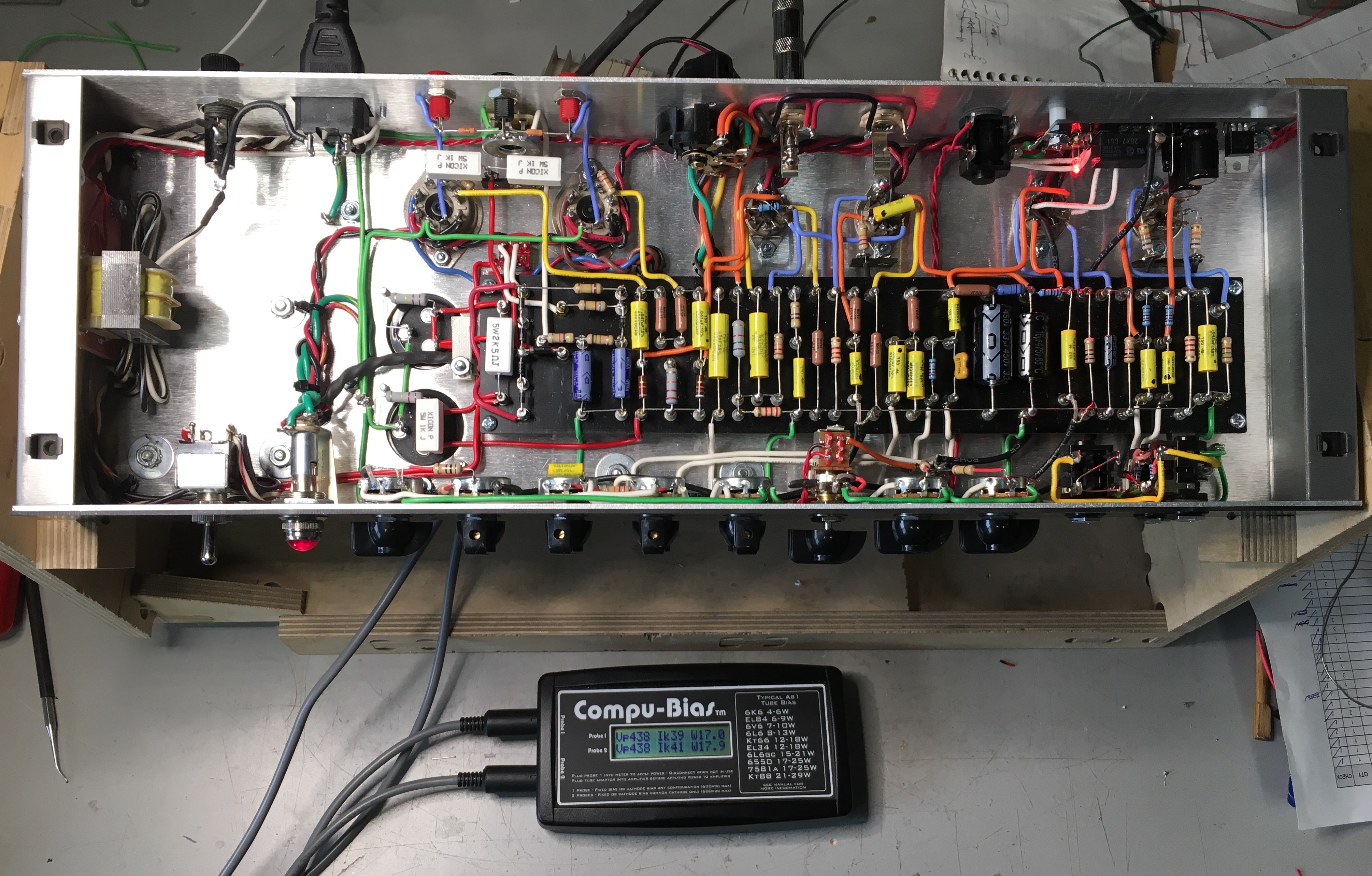

PostPosted: Fri May 24, 2019 8:24 am
All tested with the extra mini power transformer and ready to go. Will send out docs and parts this weekend to those who still need them.
Below is a picture of a current build with the new mini transformer installed at the powe end of the amp.
Riise also developed a working solution we will try when we can get the parts in.
PostPosted: Fri Jan 10, 2020 3:46 pm
Posts: 19
Riise/Bjorn, I just wanted to say thanks for the great internals pic--I found it very useful in my just-completed Triwatt build. Your wiring is absurdly neat, and although I'm really not capable of that level of control, your pic did elevate my game when it came to keeping things clean and orderly! One thing I have to ask that puzzled me from your pic--the 2 red wires coming off the right side of the progressive power switch appear to have their downstream connections reversed compared with the layout diagram--is that something related to the OD footswitch, or was it done with some other intention, or does it just not matter which is which?

PostPosted: Sat Mar 27, 2021 12:21 pm
Posts: 47
Hi all! New to the forum but not to amp design and building.
I’m currently building a Trinity Amps TriWatt and have a question, most specifically for Riise, but anyone who can answer, please feel free to chime in.
My question relates to hookup of the relay board and how that changes wiring on the Overdrive pot. I’m trying to sort out whether the jumper wire (orange on the layout diagram) from the mixing resistors to the back tab of the switch on the Overdrive pot is still needed. Likewise, the coax from the middle tab on the switch to the grid. Looking at the schematic and tracing the connections on the relay board suggests not. Also the gut shot Riise posted seems to support that. However, the pic Steven posted shows those connections present.
Thanks for any input!
BTW. I’m posting videos of my build to my YouTube channel if any of you are interested in checking it out. You can find my channel here, https://youtube.com/user/TheJagJones.
PostPosted: Sat Mar 27, 2021 1:33 pm
Posts: 47
Actually, I see now that Steven’s does not have the coax on the middle tab of the switch so, the orange connected to it does not do anything. Got it sorted out now. Thanks
