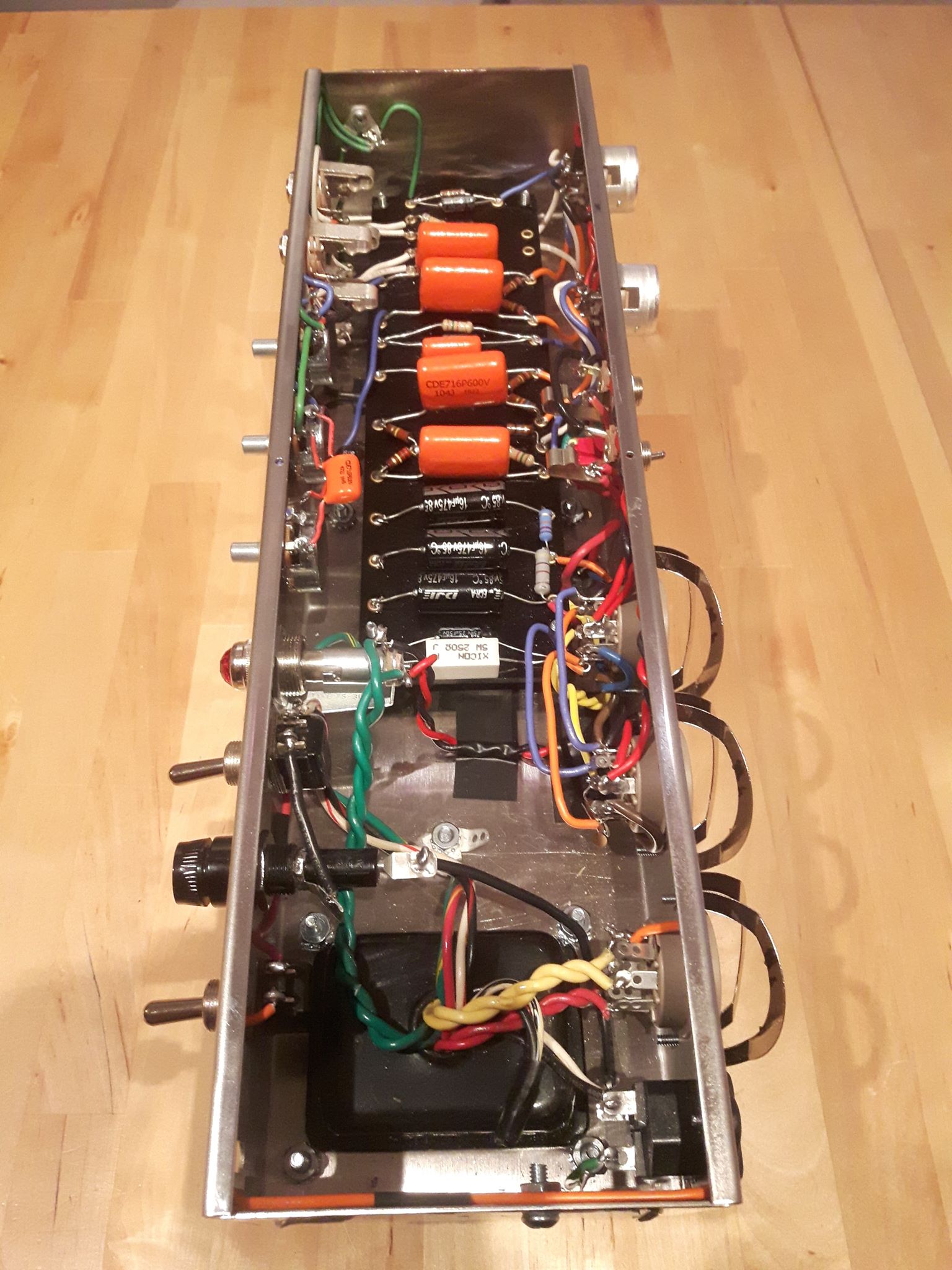

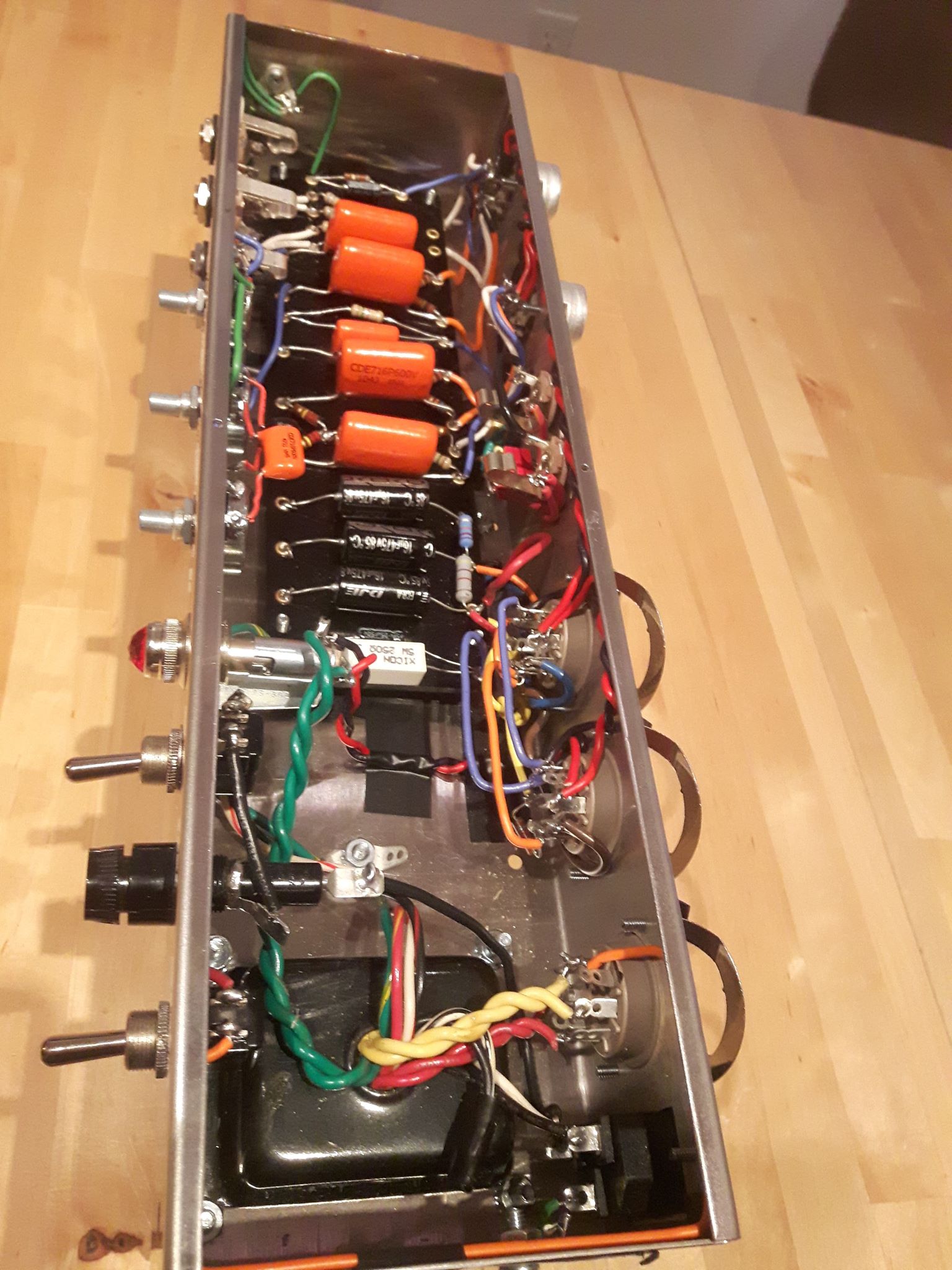

Ok, I've put it aside for a while but finished the build this evening.
I'll do more checks tomorrow but I think it will be ok. I've checked connectivity with my multimeter after each soldering. I've tried to keep wires close to the chassis when possible and keep them away as far as possible from the heater wires. I've put the coax cable is under the eyelets board. Since it has also to be close to the chassis I thought it would make sense. I've taped to it. I was also finally able to twist the yellow wires together from the power transformer, same for the reds. They are tied but I think it's overall better now. I've tried to have an overall neat build and soldering ( and to be able to desolder if necessary).
Oh and yes... I put the screw from the outside to install the board (on purpose, I prefer this way). I'll get 4 nuts tomorrow.
I haven't install the VRM. Maybe later.

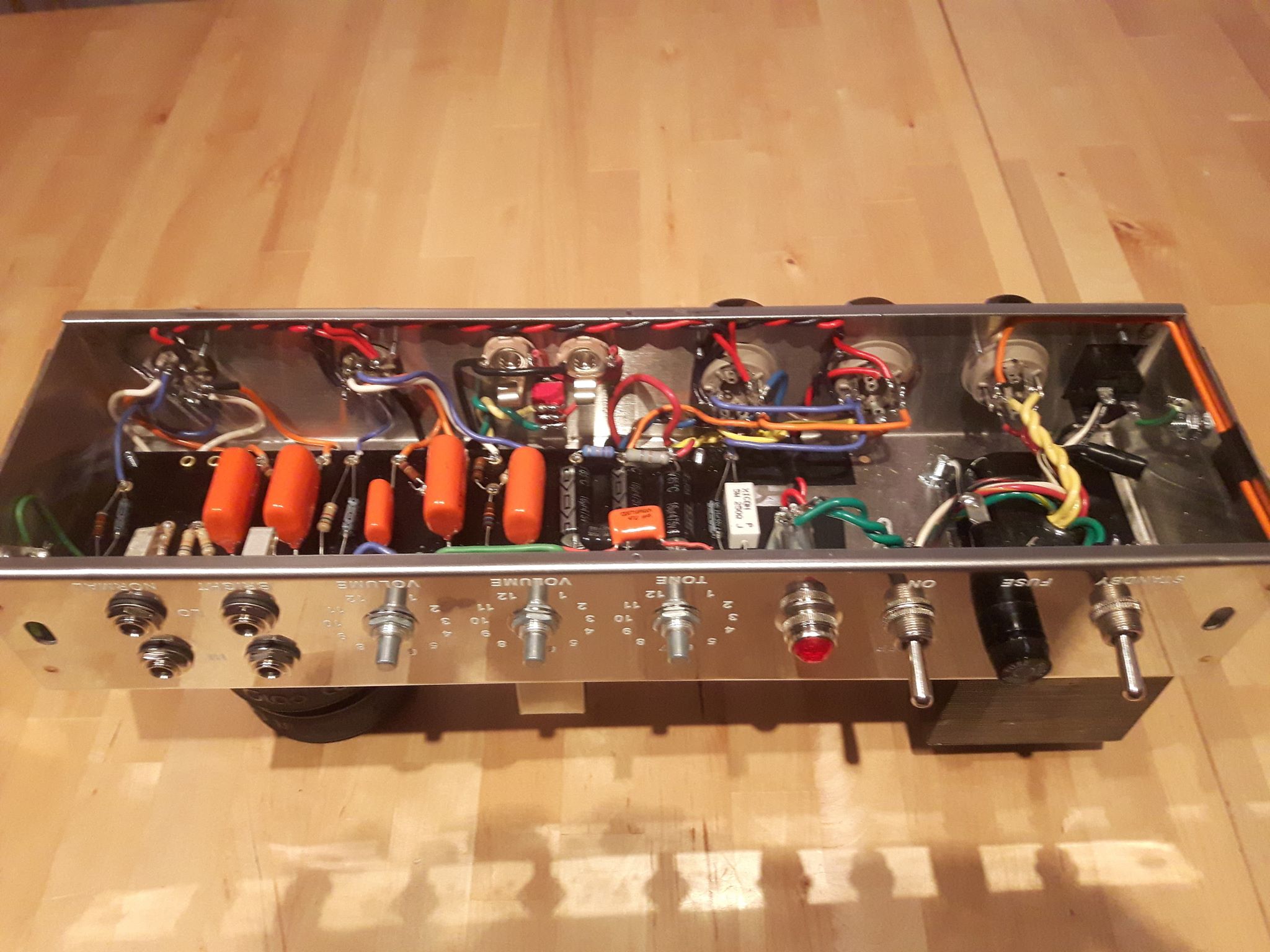

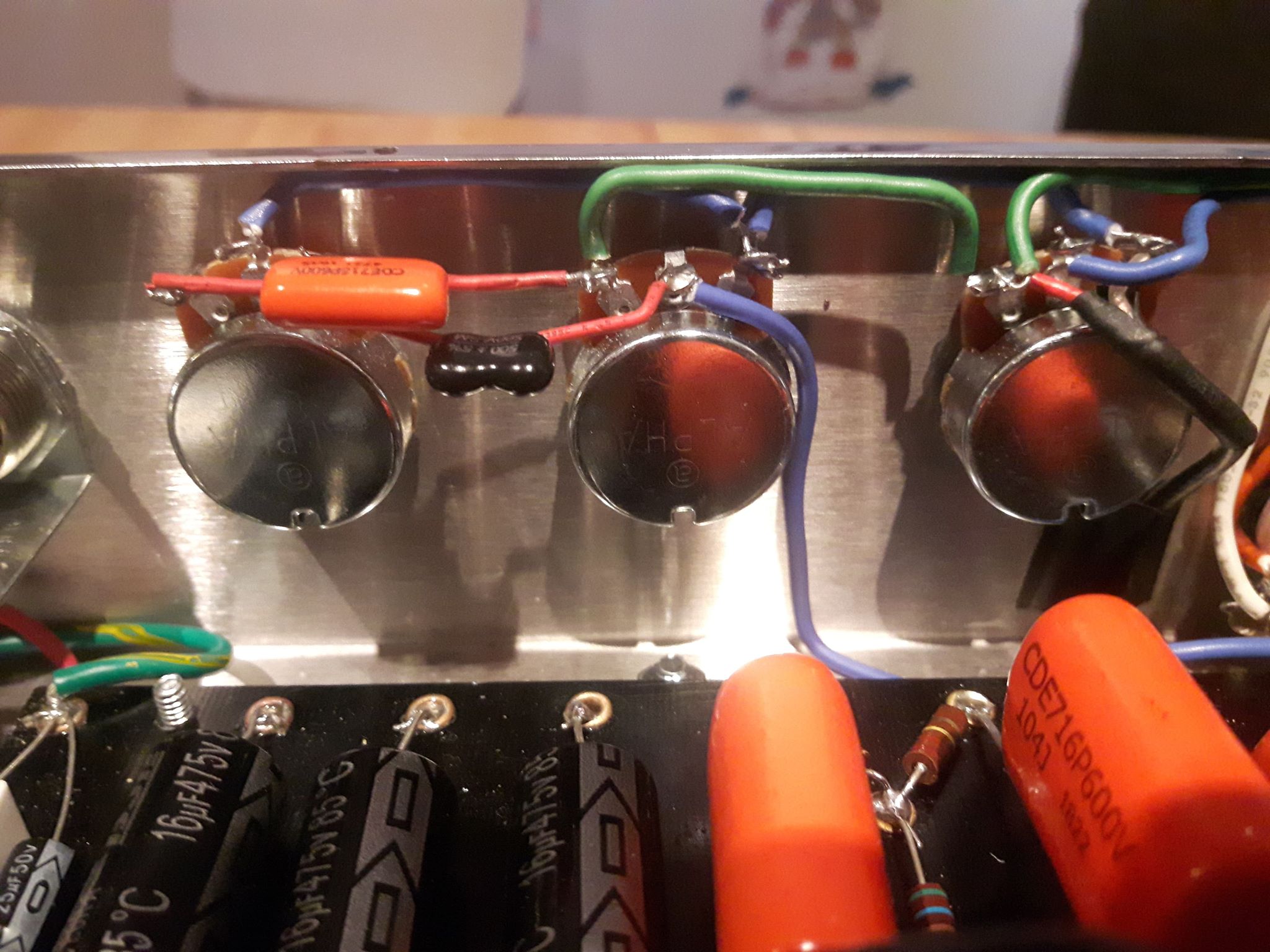

In the meantime here are some pictures of where I am now.

Thanks for the pictures. The build looks good. Nice and neat. Looks like the amp should work well. The only thing I noticed that could be improved is using more solder on some of the eyelets on the board. I like to see them completely filled to make sure the connections are good.

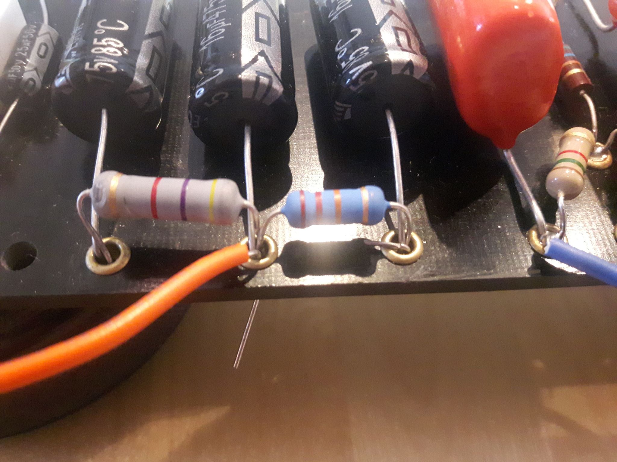

I'll add more solder on few spots on the board as you say (I like/try to think in advance and I was concerned about futur service. I didn't want to put too much to get more easily removed in case pieces need to be changed :) But of course, main and first concern is to get a proper/durable connection ! I'll do it !

Also, I was wondering about the 22K resistor. I've seen it on every build it's a bigger one in size, like the 4K7 just besides. Mine is blue body and smaller, I guess it cannot cause any issue.. They are only two different kind, bothe metal film and doing the same job, right ? it's supposed to be 2W but I was only able to confirm the value of the resistor.

The 22K resistor looks OK. The one in my Tweed amp looks the same. Sometimes it's hard to tell if a resistor is 1-watt or 2-watt.

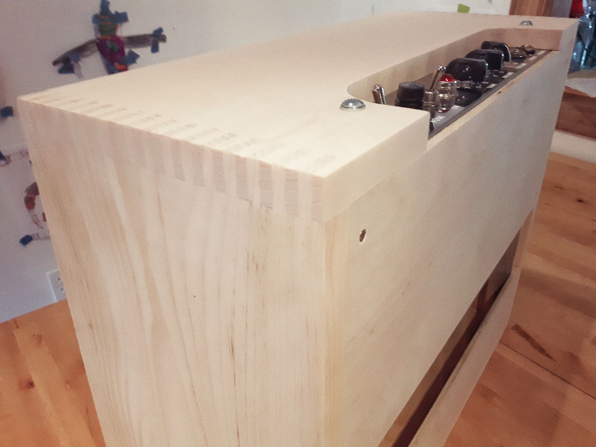

Hi Mitch, thanks for the answer. I took some time to work on the cabinet in the meantime. It's not finished but at least I've been able to play the amp in the cabinet. Not the final speaker (I've installed one of the two in my Bandmaster reverb, a C12N, 8 ohms). I have also read some stuff https://robrobinette.com/How_The_5E3_Deluxe_Works.htm and https://robrobinette.com/How_Amps_Work.htm among others. I'm far from being an expert now but at least few thing make more sense. I should have definitely read that before the build !
Installing the chassis in the cabinet helped I'd say (+ moved/played it in a room with much less electric devices). There's absolutely no hum. I do like the sound but the interaction is a still a little weird I'd say. I'll redo some stuff just to make sure. I'll make a short video later to explain but for example, I don't hear the -6db between the Hi and Lo from the normal channel. For me they are at the same level (on the bright, no pb, the -6db is clearly audible). Also, when plugged on the bright channel, when the volume of the normal channel is between 10 to 12 it decreases the volume (no change if I dial between 1 to 10 on an other hand..). But that's examples. It may be as it supposed to, I've never player on a Tweed before.. I don't know...
I'll install the VRM later for sure. I don't have access to the great gain/distortion since the amp is way too loud when these sounds are reached. For now the sound really hurts my hears (really) if above a certain volume (I've never exeprienced this with other amp and my vintage Bandmaster). I'll see what happend with the right speaker (certainly a W.eber).
So, here are some pictures of the amp/cabinet so far. I still need to order a grill cloth, an handle etc. (+ shape the two pieces of wood in the back).
I love wood in every aspect so I won't put the traditionnal tweed fabric on it. I'll just put few layers of (dark/brown) shellac as base coat. Maybe I'll french polish it as I do for the acoustics I build (even if it's absolutely not the best/suitable finish for a cabinet). Btw, that's the last Telecaster I've 100% built for a friend. The maple top is gorgeous !

PostPosted: Sun May 31, 2020 7:56 pm
Cabinet looks great, are you planning to ease (round over) the corners? Also, are you going to put some cutouts in the top rear panel? Tubes need air. One of these days I'm planning on making a genuine slant front 5E3 combo cab, courtesy of Modulus Amps in UK. He has some nice downloads at the bottom of the page on his site (Imperial/metric and box/butt joint options in the plans). And the quilted maple on the Tele is gorgeous.
It looks like you appreciate good wood, found these in grandfathers garage, were shelves in white painted storage cabinet. Ran them though the planer and found what I think is long leaf Southern yellow pine. Can't use in a cabinet, though, it's really dense (read as HEAVY!) and someone would probably hurt themselves trying to lift it.

Thanks! About "rounding" the corners, just a little. I'll definitely won't use the traditional/suggested radius. I'll round the edges at the same radius as the Telecaster I think. I want to keep it that way.
Yep, I wrote that in my comment before, the cabinet is not finished yet. I'll shape the rears panels soon for sure... :)
Modulus, yep, that's the plan I've used :) It may not quite well visible on the pics but it's slanted, 8.5 at the top and 9.5 at the bottom. If I remember well the fingerjoin were supposed to be 0.5 but I did them at 0.25 (they will last forever !)
Too bad if it's too dense/heavy for the yellow pine. Higher density would mean less vibrations and then decreases the low frequencies I suppose. Matter of taste.. What I like with pine is that it's so light ! Now when I see the solid pine shelves in my house, I see amp cabinet.. No choice, since I have all these raw materials at home I will have to do others builds in the future, it's too late now... ahah ! (I think I'll do a Blackvibe from Robinette and since I've been hesitating with a Tramp, maybe a Tramp. Low wattage for sure for the last one..)

The cabinet is looking good. It should look great with slightly rounded corners and a french polished finish.
