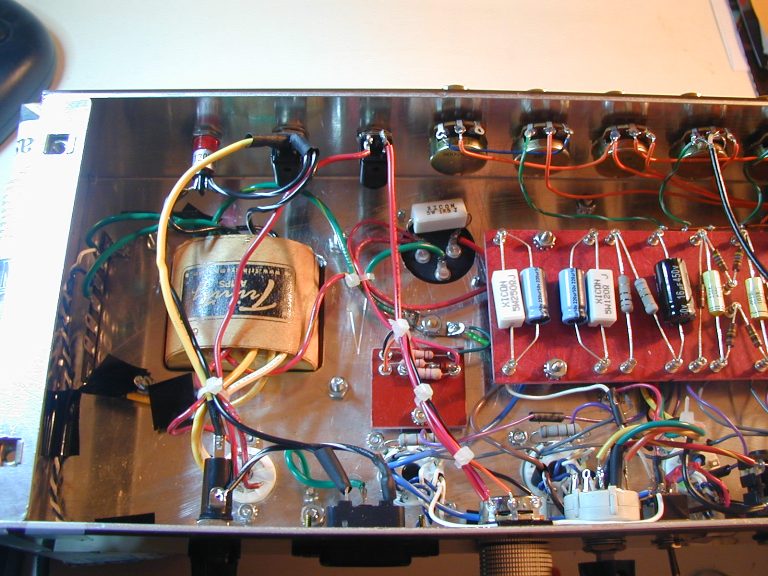

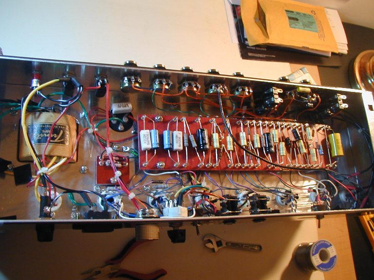

Here are a few snapshots of the VRM install on my SIIIv6. There are some extra wires on my setup as I moved the boost and tube select switches to the front panel and put them on push-pull pots.
Thanks for the helpful tips, jcny! :D You're right, it is a bit cramped in there. Didn't get a chance to play with it too much, but it seemed to work great. The real test will be if my wife is happy with the lower volumes!!! :roll:

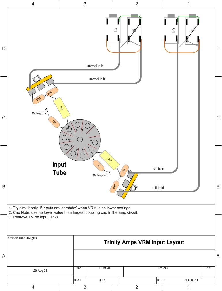

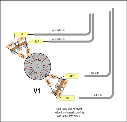

Does this amp have the entire high voltage rail (all plates) variable or just the output tubes? The scratchy guitar pot was an issue over on Powerscaling.com as well but only on amps where V1 was scaled along with the rest of the amp. It's not a problem when only the output tubes or output and PI are scaled.
Stew
PostPosted: Wed Jun 04, 2008 7:55 am
oxfordmini wrote:
Only one little issue seems to be, and it is completely minor to me, the volume pot on my guitars are a bit scratchy with the VRM turned down. Could there be some DC leaking onto the guitar's volume pot?
Yes - It does scale the whole B+.
Yes - At low voltages, there is some DC leakage through the V1.
If it is bothersome try this:
Remove the input cables to pin 2 from the tag strip. Install a 1M resistor to ground from hi grid resistor on the tag strip & another from the lo grid resistor on the tag strip.
Tip: Use the middle tag to anchor them as it goes to ground.
Then install a .1uf cap or less (see note) to each of the tags for the grid resistor and reconnect the input cables to the new caps. Let us know how it works out.
Like this:

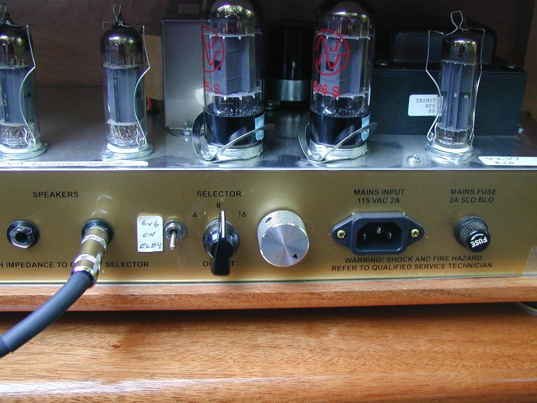

Time to try to post some pictures of the VRM install
This shows the "upside down" position of the VRM
The whole board
The back panel, I chose the BIG KNOB so that I could tell it was the VRM from the front

There is another way to skin the cat to deal with any leaked DC. I'll post another layout soon.
PostPosted: Thu Sep 18, 2008 10:37 pm
Latest - Try this
