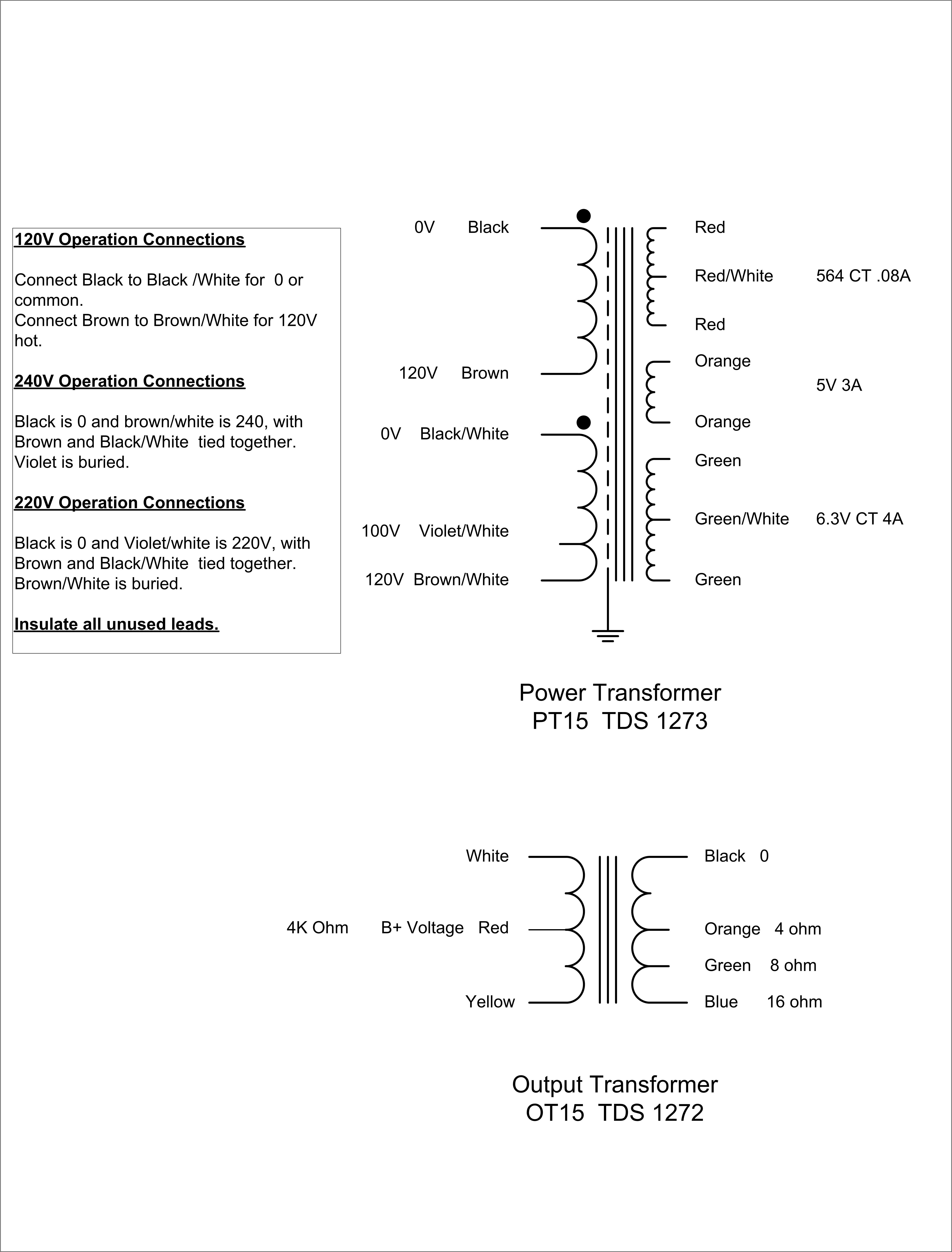

We got ours from TDS Transformers. They actually made them for Matchless. TDS15 & TDS30

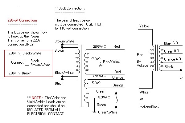

We have this West Labs info:
They should be compatible.
The 15W powers West was selling here looks identical to many TDS made for Matchless in the past. These are different dimensions than the ones we had. You can tell these are not TDS because of the stickers on them.
