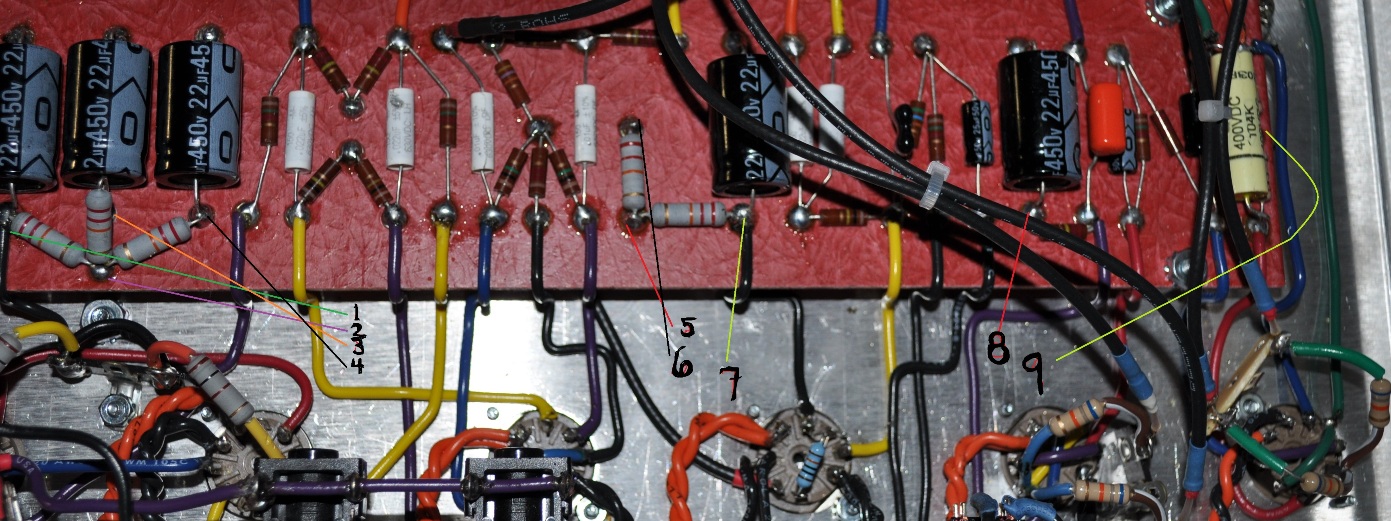

Inserting image this time of my board with numbers pointing toward various areas.
Legend for voltages as follows:
1: 229v
2: 351v
3: 320v
4: 334v
5: 348v
6: 332v
7: 268v
8: 331v
9: 334v
File comment: picture illustrating the number associated with the voltage.

You're saying you've got 351V on Pin 2 - ie the grid??? :shock: If so, those tubes would blow up. The grid *must* be at 0V.
Then you're saying the cathode (pin 3) is at 320V!?? :shock: That can't be right either. Then the heater pins 4 & 5 are at high voltages too??? :shock: This is insane.
Either your readings are wrong, or the pins at your tube sockets are all shorting together.
