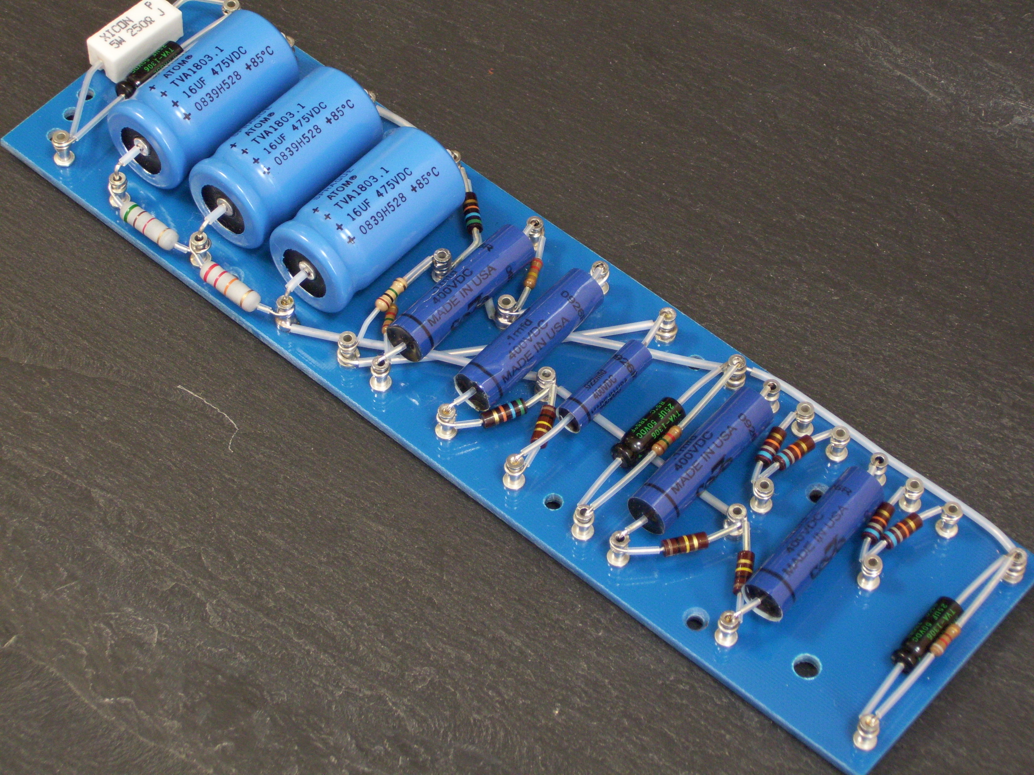

Hey, I started a new project, a 5E3 scratch build!
Hopefully I'll finish this one day :roll:

Beautiful !
Can I ask where did you bought your board and your turrets ?

Thanks so much :o
The board came from Ken Watts at http://www.turretboards.com/
First time I've dealt with them, but Ken seems like a great guy to deal with and this board is just beautiful.

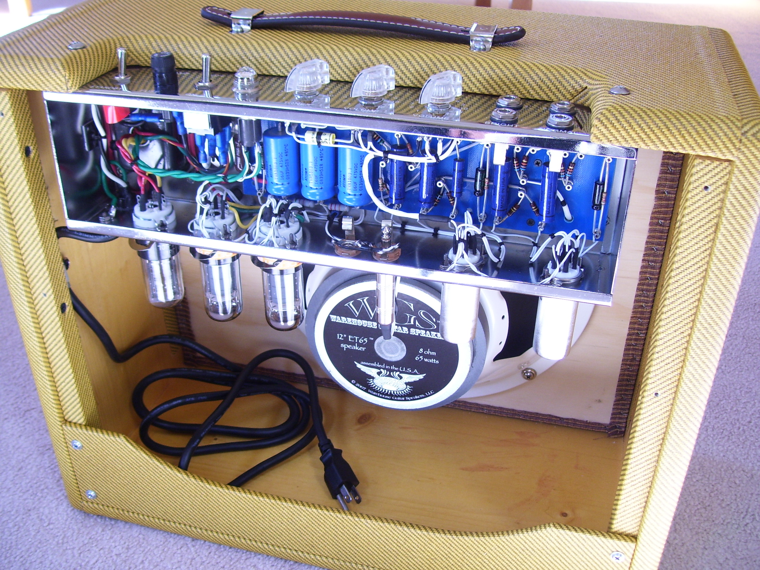

Hey everyone, I finally finished this...!

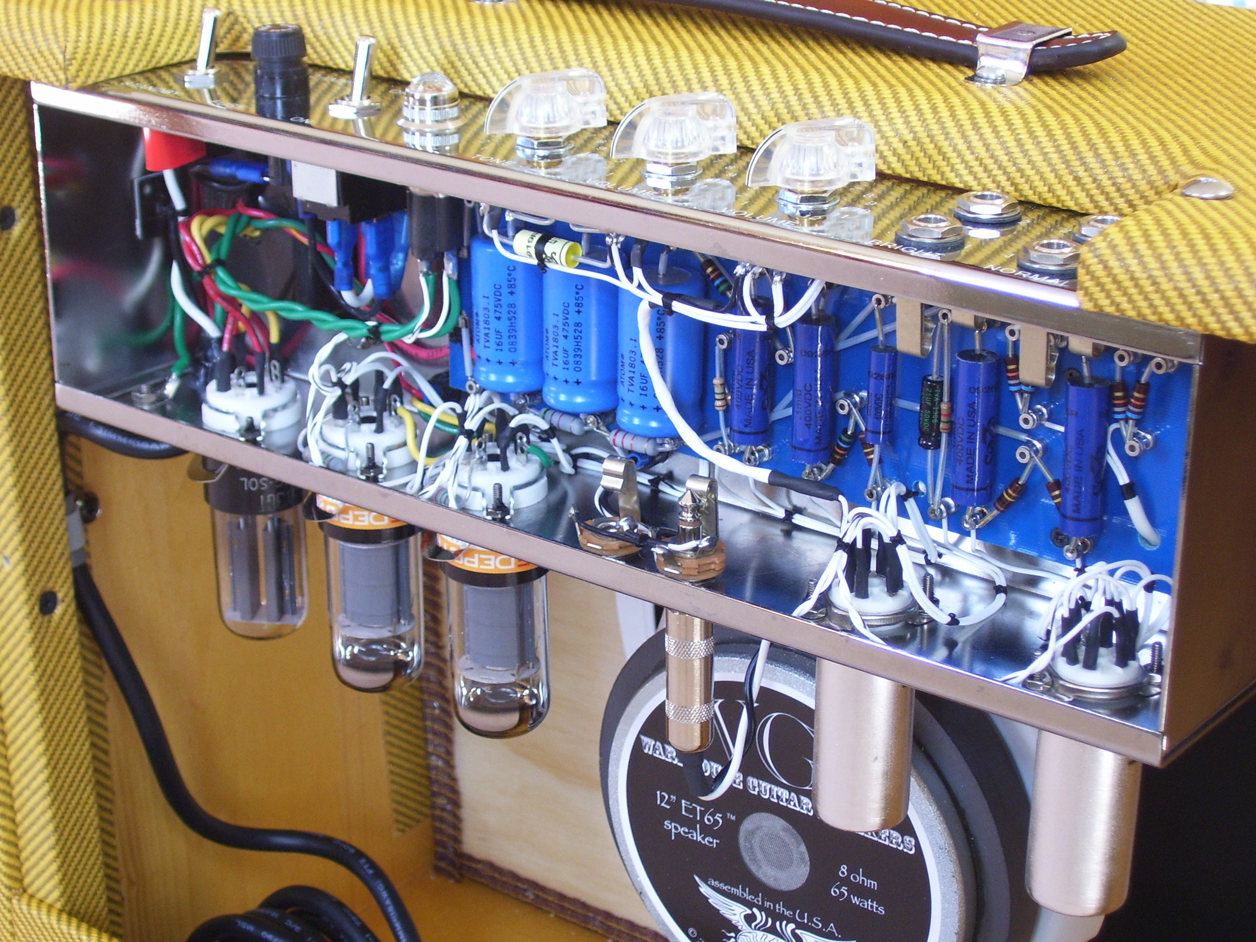

A few more...
Enjoy!

Joe, that is gorgeous work, your usual of course but ours to admire! What are you using to bundle your wires - I don't recognize that material.

With craftsmanship like that you'll need a transparent panel in the cabinet to show it off!
Great job.

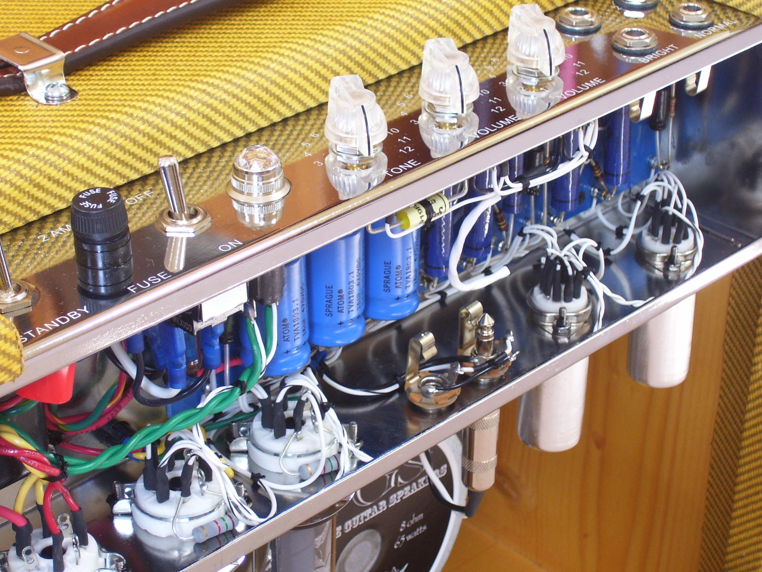

Thanks guys!
Hey Jim! Here's a link to a description of the lacing cord (or tape) that I used...
https://www.pegasusautoracing.com/produ ... oduct=4041
I like to use individual "NASA knots", but you can do a continuous run stitch as well like in the Hiwatts. After I tie the knots I cut off and cauterize the ends by hovering close to them with 1400F thermal strippers, then seal the knot the same way
You can see it better here...
