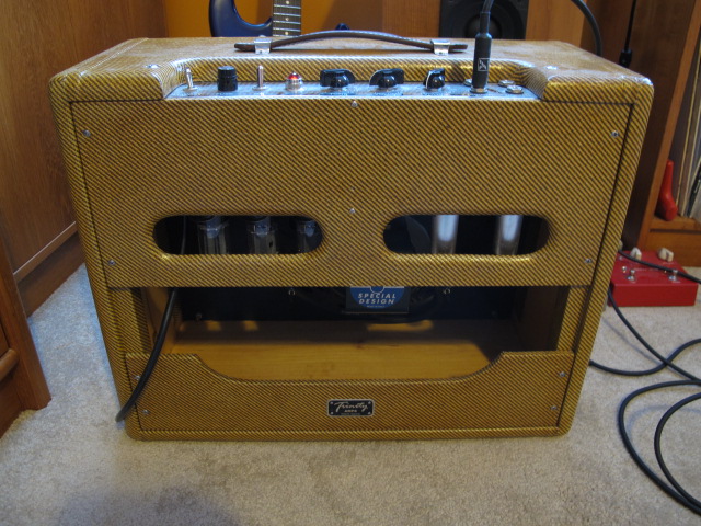

Thanks, Stephen, for the tip about the hole in the chassis lip. I never realized it's there until now. I've been trying to get rid of the back panel rattle since I built the amp about 2 1/2 years ago. I tried padding the inside of the panel and jamming things in there but that didn't help much. The panel seemed to always need to be held closer to the chassis to be quiet, not farther away.
My chassis came with one 4-40 tapped hole on the top lip. I drilled and tapped a second one on the bottom lip today just to make sure, and I drilled a couple of corresponding holes in the back panel. With everything screwed back together the cabinet doesn't rattle at all. Even with low E's at near full volume!
Yes, the amp is a little bassy, but I like it that way. I've had no desire to modify the stock tone. It sounds really good with my Strats and the Jensen speaker I have in it.
