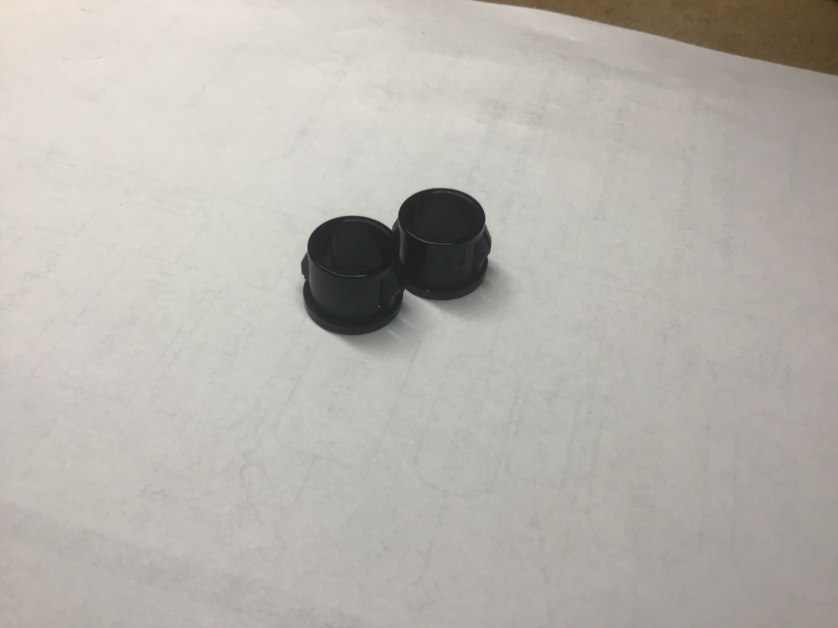

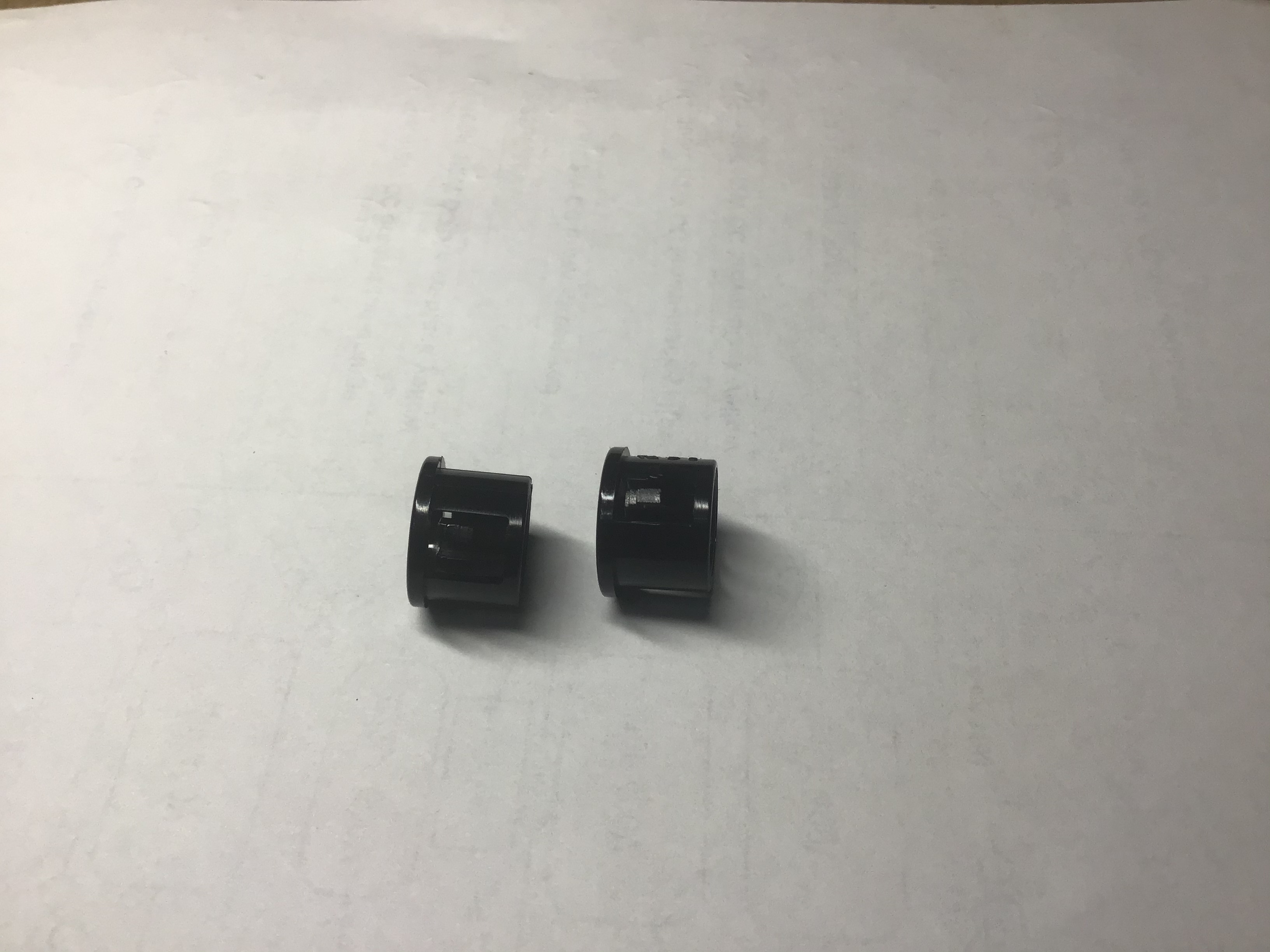

There are 2 small black plastic grommets that I cannot find a use for in the instructions.
What are they used for? I don’t want to go any further until I know.

For output transformer lead protection through 1/2” dia holes on top of chassis
