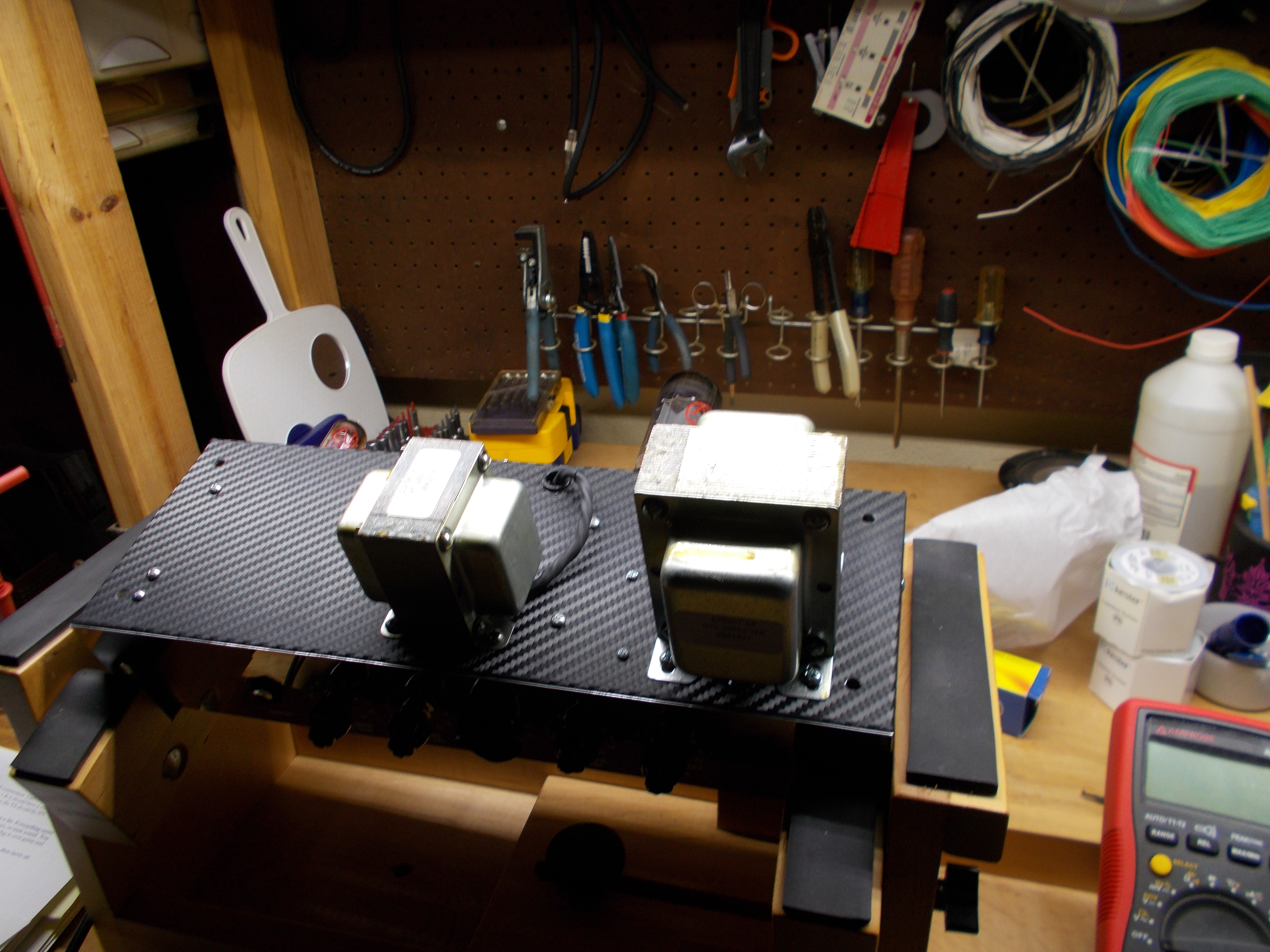

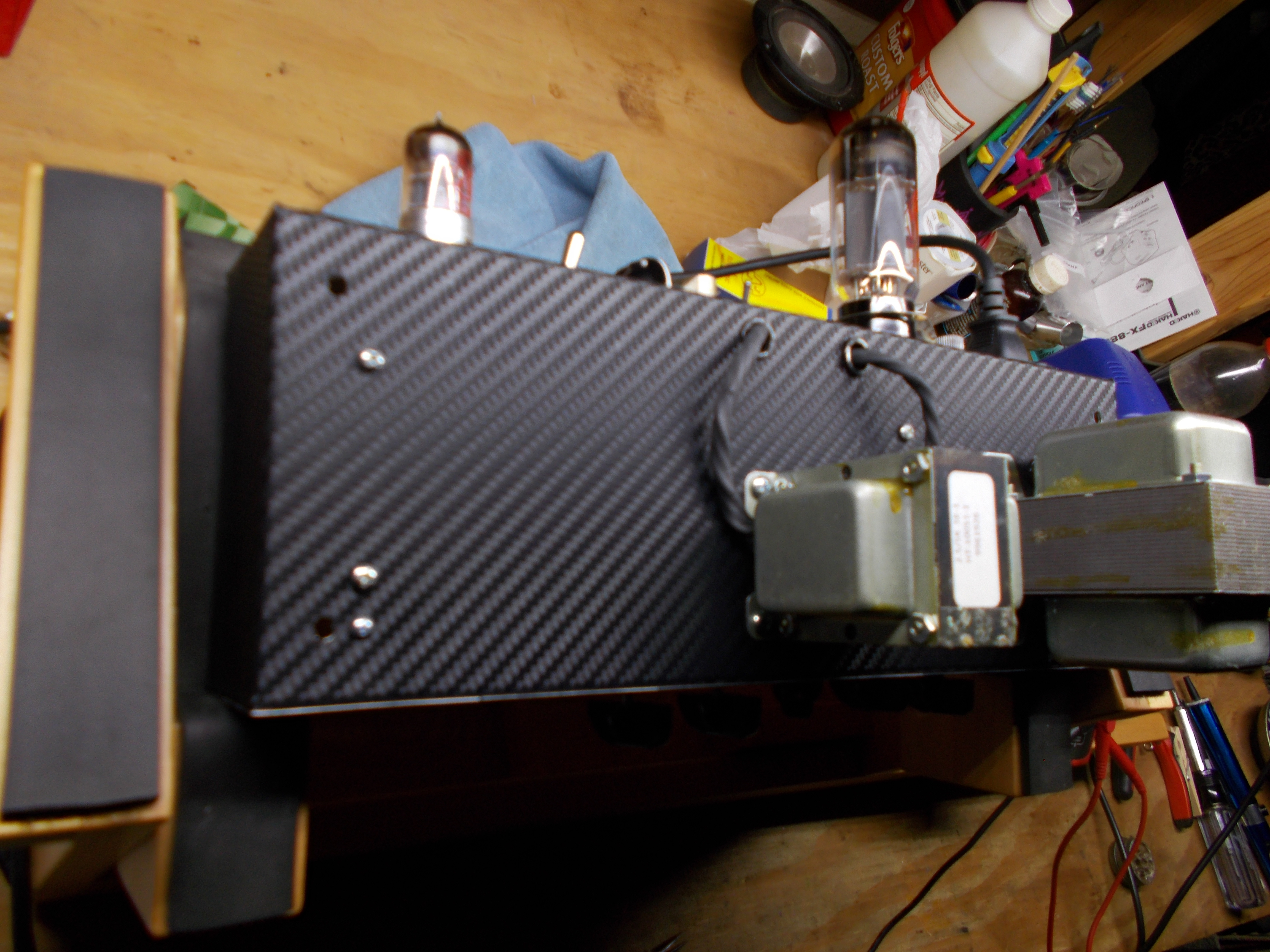

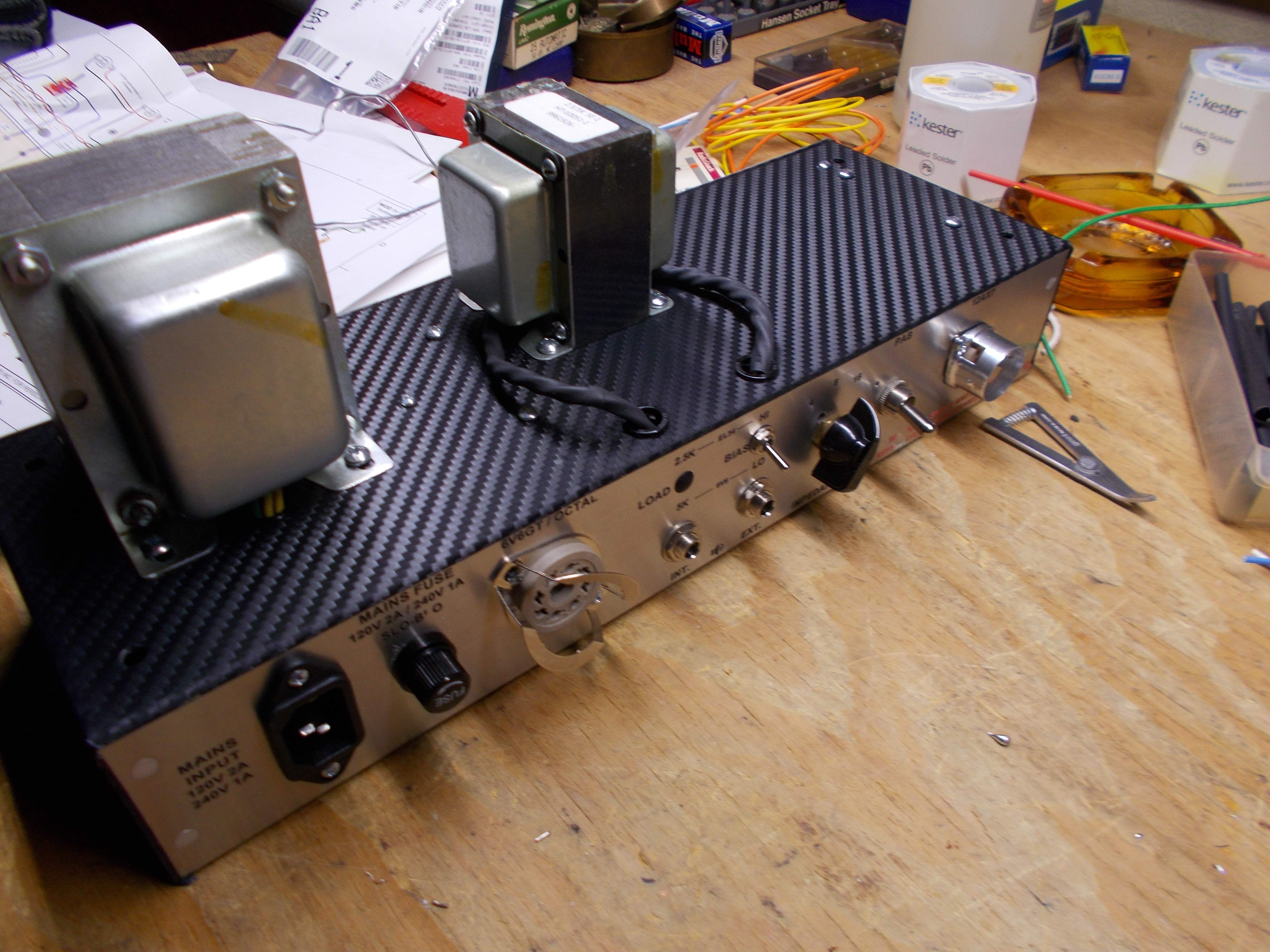

Here's some pics of #2. I live in a small town, too. But Mouser in Dallas is a day or two away and Antique Electronic Supply/Amplified Parts in Tempe, AZ is about 3 to 4 days. It'd be nice if Oklahoma City had an electronics supply place, no such luck.

That looks pretty tasty. Makes me wish I twisted and wrapped the transformer leads like that.
What is the idea with the carbon fiber? Is it going to have some kind of window box? I'm still deciding on if I want to build my own box (limited tools) or buy one from Trinity. First task is to get it working!

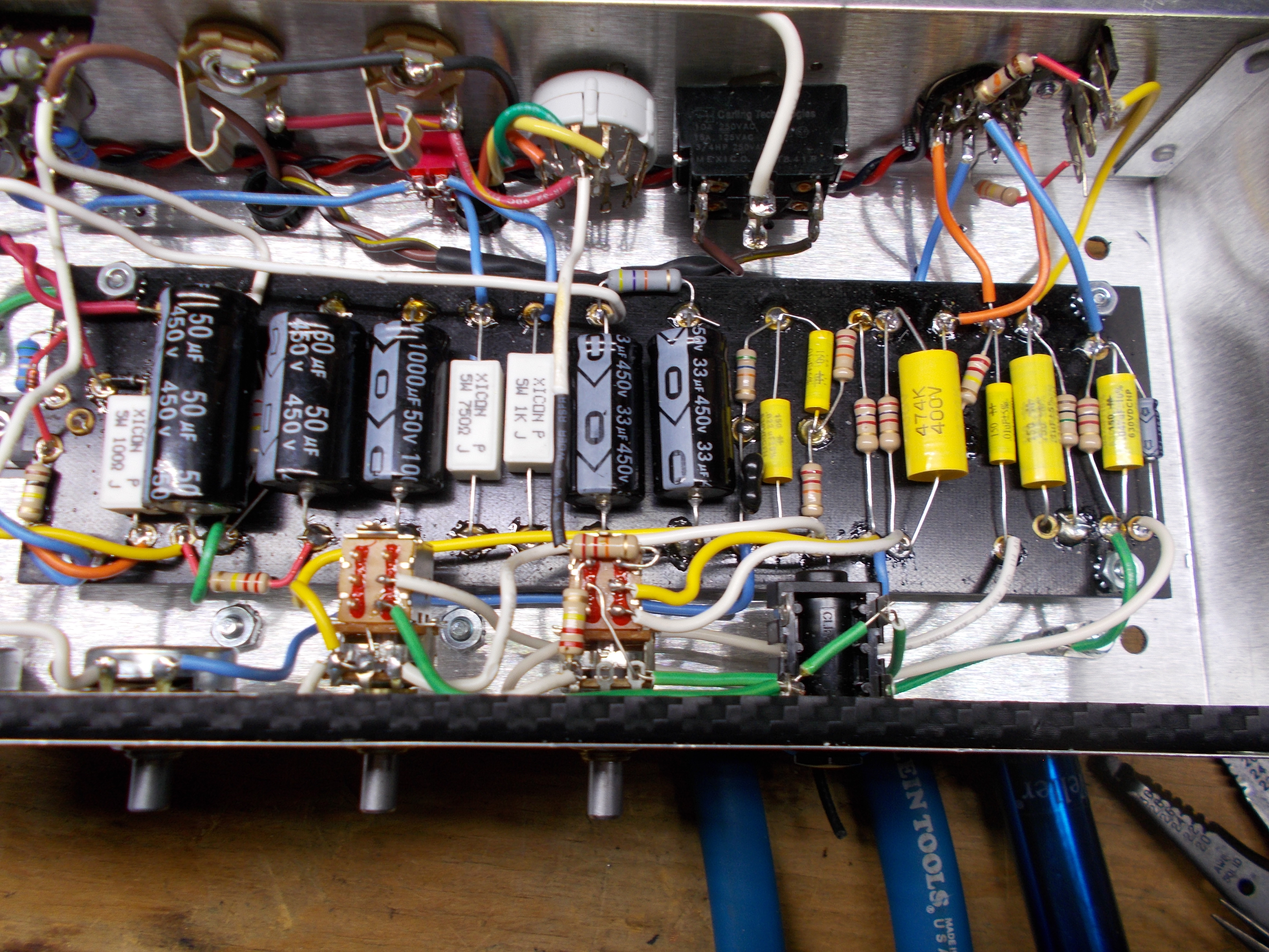

One revision I would do if I built another Tramp as a head would be to move the power side terminal down to the transformer screw for cleaner/shorter wire paths as in this picture.
I'm going to leave it where it is in this build because it is completely quiet and working.
