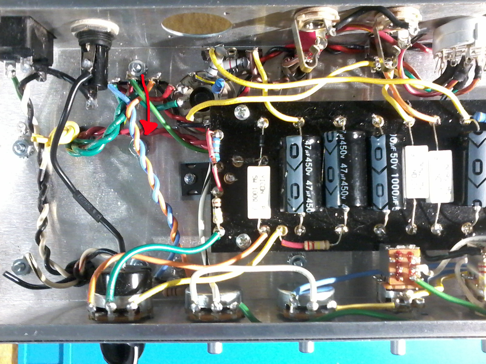

One revision I would do if I built another Tramp as a head would be to move the power side terminal down to the transformer screw for cleaner/shorter wire paths as in this picture.
I'm going to leave it where it is in this build because it is completely quiet and working.
